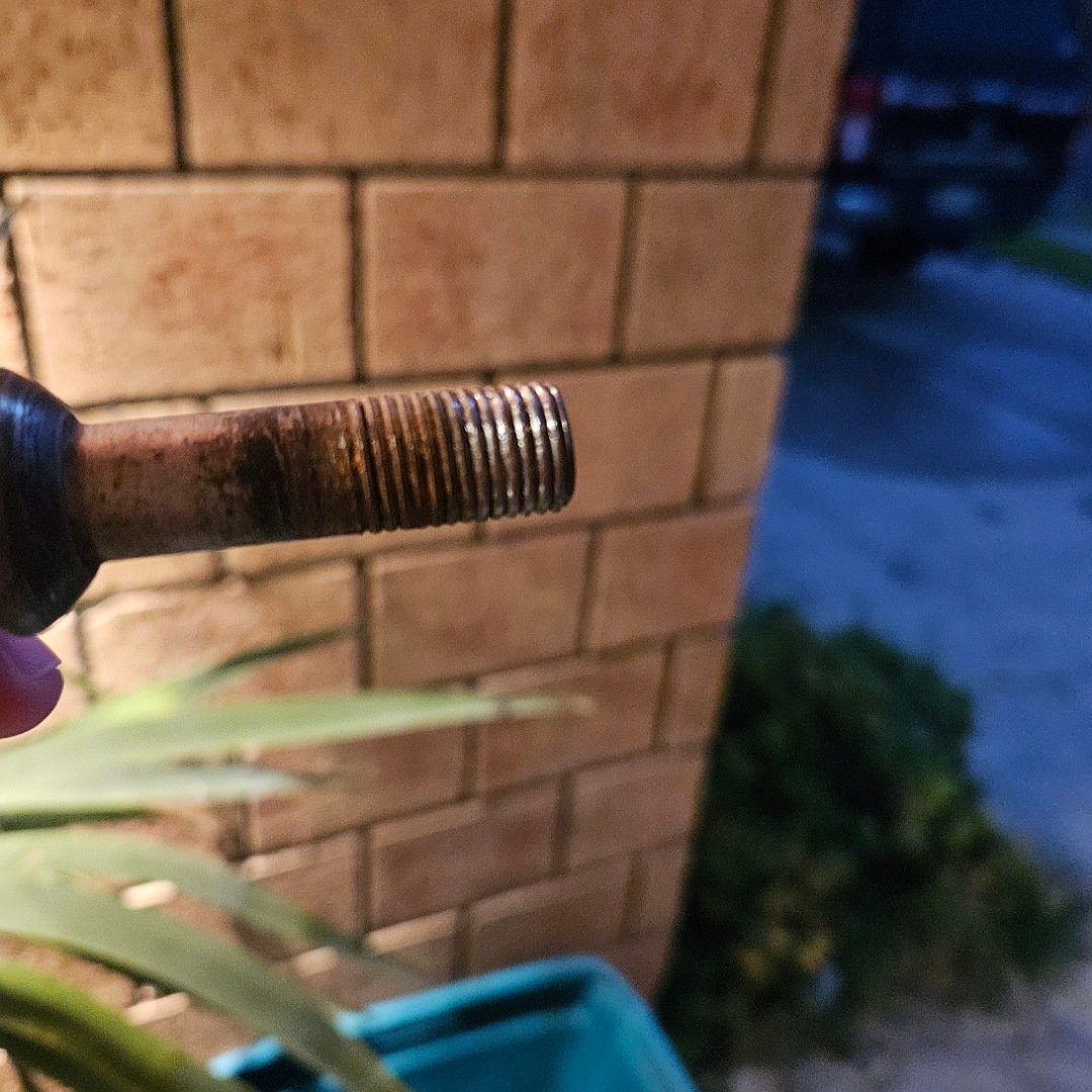

Muncie Posted May 15, 2025 Posted May 15, 2025 Opinions wanted here, back story my neighbour who's a top chap but buys the worst cars...... has bought himself a lovely Mercedes just stuck it in for a wof needed a tyre upon taking wheel of found the wheel bolts in this state. He's been quoted $3.5-5k to replace all the hubs yup they're all like this. My guess someone bolted.5x114.4 wheels on a 5x112 car by just ugga dugga the shit out of them till tight What can he do other than hubs? That'll pass a wof. Quote
kws Posted May 15, 2025 Posted May 15, 2025 what sort of merc, is it old enough to do some Pick A Part lego? 1 Quote
Raizer Posted May 15, 2025 Posted May 15, 2025 Yeah what model? I know for mine new hubs are cheap on Rock Auto. Quote
CUL8R Posted May 15, 2025 Posted May 15, 2025 I would recommend he re-taps all the hubs, plenty of cutting fluid as you go and a new set of wheel bolts. More often than not with the wheel bolts you'll ruin the bolts before the hubs 99% of time at work fixing said issues from similar stories will fix, and torque to spec 7 Quote
Muncie Posted May 15, 2025 Posted May 15, 2025 1 hour ago, CUL8R said: I would recommend he re-taps all the hubs, plenty of cutting fluid as you go and a new set of wheel bolts. More often than not with the wheel bolts you'll ruin the bolts before the hubs 99% of time at work fixing said issues from similar stories will fix, and torque to spec He's bought new bolts already he'll spring for a good tap and try that first he was pretty gutted. Hopefully can avoid new hubs as that is 300% more fucking around than needed. It's getting towed back from WOF shop to my place to look at. 2 Quote
