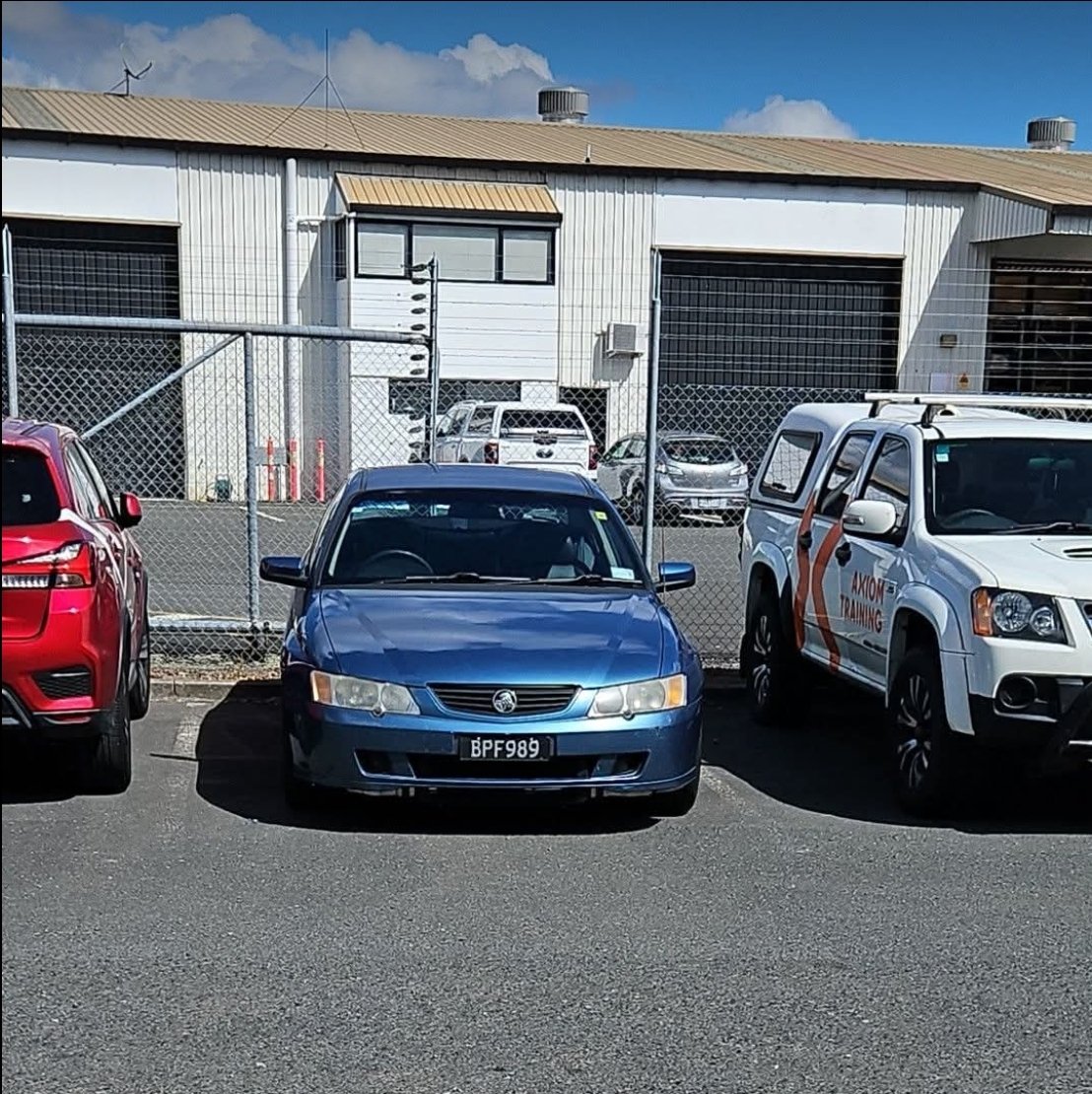

They were all top chaps funny thing was how far i got through scrutineering before i got pinged for bringing a slug gun to shotgun fight. (American reference there) How the hell i missed v8s only was genuinely funny on day for them and myself 100% my own poor research. -
Daves newish school Holden (Muncies Chop Shop development mule)
I genuinely had 8 people around my car trying to workout what my engine is as it looks like a small block chev with the polished rocker covers and flipped inlet manifold. So many things went parts out on track too poor track guys were flat out picking metal and oil up from blacktop. I would of smoked 50% of cars there was so frustrating not been able to race. -
Tried sneaking in to race at fathers day drags...... 3 recounts of cylinders before they realized i was lacking 2 cylinders and were very apologetic. All good pit parking and a refund it would of held its own trying to stay off social media missed the V8 only stuff listed on Facebook as i just went to meremere's website. -
