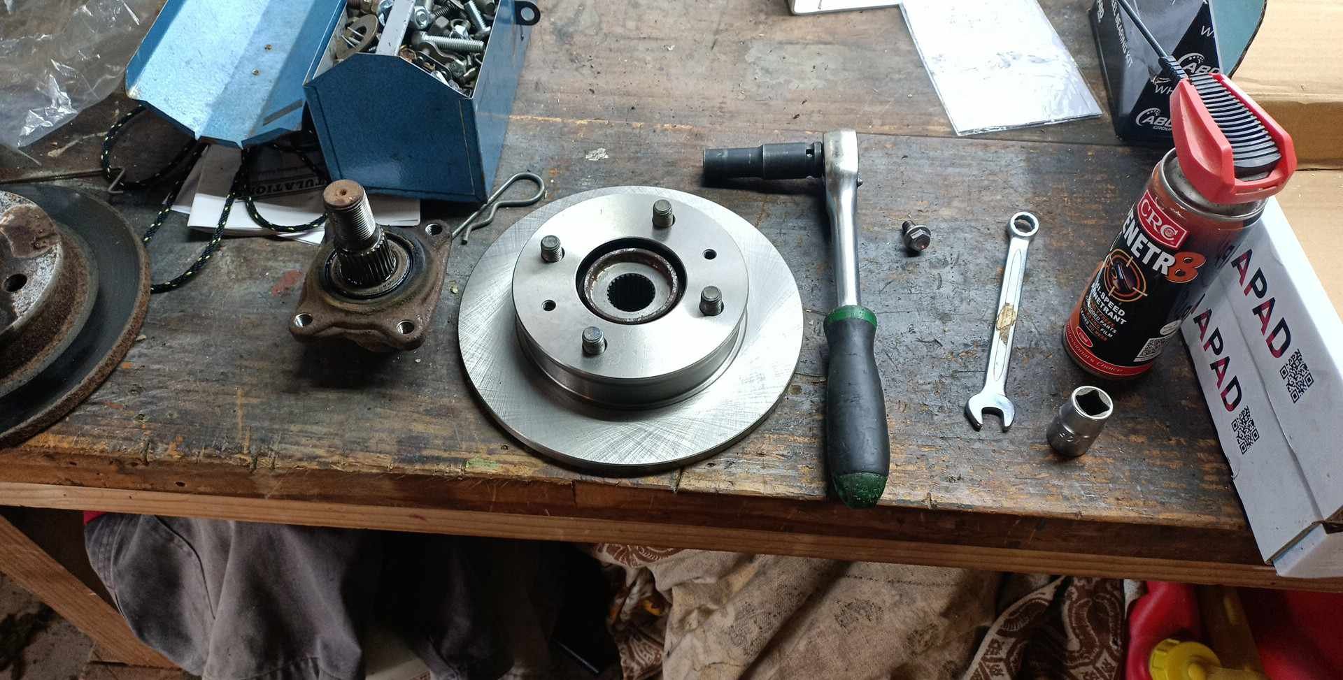

Fairly sure it'll be different, will be going from 10mm solid rotors to 17mm vented, more pad surface too which will help.
Doing some oe parts catalogue diving at work I think 2013 onward Mirage brakes might fit, near on identical rotors just 229mm vented. Calipers run the same piston diameter and even the same mounting bolt part numbers. Might have to find some from a wrecker and check the mounting bolt distance there it attaches to the knuckle.
It's 4x100, been comparing the back spacing of all the small car rotors at work to see if anything's close(swift, fit, colt, demio, etc). I'll do a pick a part run at some point and grab some options.
Had to go and buy 2m more wrap to finish it off only to be told that this colour has been discontinued so I bought all the rest of their stock, ended up with 4m+ for spares. Stoked with how it came out, couple sections I want to go back and fix but it'll do for now. Attempted to do a roll on bedliner but didn't prep the surface well enough and it started to crack and pull in a few places. Lost my house in a breakup so had to do 6 trips moving all my stuff back to my parents place. Realised I'd been very neglectful on servicing when I found a heap of parts I'd bought for it previously, during the move. Bought new front tyres, Zestino Gredge 07RK 165/55-14, gave it an oil change which was ~7000km & 2 years overdue and finally changed out my front bearings, rotors and pads. Everything's tiny, front rotors are only 200mm solids. Been meaning to research if a vented setup off a Colt or kei car of the same era might bolt up.
