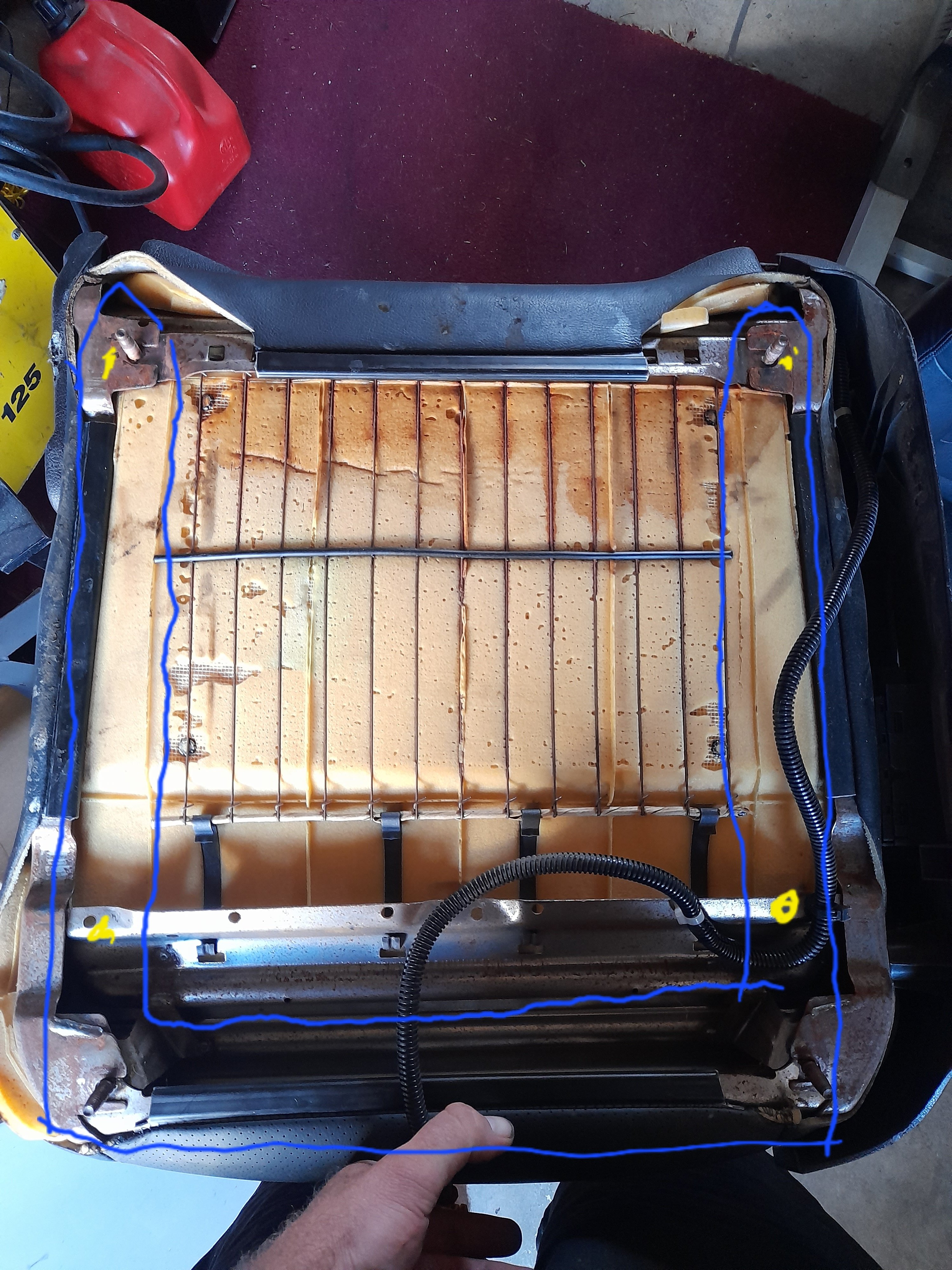

Bearded Baldy Posted January 27, 2025 Posted January 27, 2025 Seat mountings chat please. All the talk online about fitting b series xr6 seats to x series falcons says the x rails fit the studs and holes on the b series seats. Following this gospel i bought some seats and have found the whole lot to be BS. Length and width of the mounting studs is miles out in both directions. Presenting super duper phone art picture #1. Would it in theory be certifiable to make a u shaped flat steel adaptor like the photo? And if so would it need to be 12mm thick like it would as a floor rail or is 6mm ok? Last question for now, can i use the o.e mounting studs and nuts on the seat (8mm ish) to mount the plate, and the o.e bolts for the x series rails to the plate? I think i explained my thoughts right, maybe not. Quote
RXFORD Posted January 27, 2025 Posted January 27, 2025 Using 5mm or 6mm flat will be heaaaaaps thick enough for cert. 12mm is crazy talk. At the end of the day, the seat bases will likely only be a couple bits of 1mm - 1.6mm sheet spotwelded togethor so not exactly bomb proof. Unstressed seat mountings are fine having 4x 8mm or 5/16" fasteners, but if it has a seatbelt mount built into it you my have to step them up depending on where the seatbelt is mounted. Maybe you could mock something up quickly from sheetmetal and we could visualise it better. 1 Quote

cletus Posted January 27, 2025 Posted January 27, 2025 16 hours ago, Bearded Baldy said: Seat mountings chat please. All the talk online about fitting b series xr6 seats to x series falcons says the x rails fit the studs and holes on the b series seats. Following this gospel i bought some seats and have found the whole lot to be BS. Length and width of the mounting studs is miles out in both directions. Presenting super duper phone art picture #1. Would it in theory be certifiable to make a u shaped flat steel adaptor like the photo? And if so would it need to be 12mm thick like it would as a floor rail or is 6mm ok? Last question for now, can i use the o.e mounting studs and nuts on the seat (8mm ish) to mount the plate, and the o.e bolts for the x series rails to the plate? I think i explained my thoughts right, maybe not. As mentioned above 5 or 6mm will be fine The only thing to consider with using flat plate, is if it's going to flex, ie if the seat mount holes are close to the floor mount holes it's probably going to be fine, if they are not close then the flat plate can flex a bit, this can be fixed by using a gusset or another bit of flat welded on its edge In fact 3mm would probably be fine if it had a gusset Leave your seatbelt attached to the floor, not the seat, this makes life much easier 1 1 Quote

Bearded Baldy Posted January 27, 2025 Posted January 27, 2025 Cheers @RXFORD and @cletus, Yeah the seat base itself is barely 1.6mm, i thought i read on the lvvta site that adaptors had to be 12mm, was trying to parent and research at the same time and failed lol. The rear rail hole will be approx 20mm forward and out from the seat stud, the front one will be 50 to 60mm back from the front stud. Seatbelts will be staying mounted on the floor so no worries there. Will make so dummy plates up to show what i mean one night after work. Cheers again fellas Quote
Bearded Baldy Posted January 27, 2025 Posted January 27, 2025 And i even took the photo of the seat base back to front, front edge is at the bottom ffs... Quote
dmulally Posted January 28, 2025 Posted January 28, 2025 4 hours ago, Bearded Baldy said: Cheers @RXFORD and @cletus, Yeah the seat base itself is barely 1.6mm, i thought i read on the lvvta site that adaptors had to be 12mm, was trying to parent and research at the same time and failed lol. The rear rail hole will be approx 20mm forward and out from the seat stud, the front one will be 50 to 60mm back from the front stud. Seatbelts will be staying mounted on the floor so no worries there. Will make so dummy plates up to show what i mean one night after work. Cheers again fellas Thinking back to when I put a Nash seat in my chev I had to make sure the doubler plate on the bottom and the bodgy angle iron on the top had to form to the corrugations of the floor panel. Not sure if relevant for the falcon however. 1 Quote
shizzl Posted January 28, 2025 Posted January 28, 2025 I had some spacers laser cut so that the seat rail clears the corrugations, these are 10mm, with 4mm doubler on the underside. i had some seat rail adapters laser cut which mount to the seat and the floor spacers. really solid, highly unlikely they will ever go anywhere in a smash, there are no welds. 1 1 Quote
Bearded Baldy Posted January 28, 2025 Posted January 28, 2025 Nice and flat on the falcon thankfully, looking at it tonight i think i can make something nice out of some 75x50x5 angle steel. Shortening the 50mm side to 25mm should act as a gusset and not hang down looking hori. Using the original xc rails from the car so the floor side of the mountings shouldn't be a problem. Or will they need a plate on the underside of the floor since the seat itself is different? Quote
dmulally Posted January 28, 2025 Posted January 28, 2025 13 hours ago, Bearded Baldy said: Nice and flat on the falcon thankfully, looking at it tonight i think i can make something nice out of some 75x50x5 angle steel. Shortening the 50mm side to 25mm should act as a gusset and not hang down looking hori. Using the original xc rails from the car so the floor side of the mountings shouldn't be a problem. Or will they need a plate on the underside of the floor since the seat itself is different? The answer is usually whatever is the hardest and most annoying to do. But if it's the same mounting points I can't see why it would need to change. Especially if it's captured nuts as you'd have to cut them off. If it isn't a captured nut and just a hole in the floor I'd use a doubler. Quote
cletus Posted January 28, 2025 Posted January 28, 2025 13 hours ago, Bearded Baldy said: Nice and flat on the falcon thankfully, looking at it tonight i think i can make something nice out of some 75x50x5 angle steel. Shortening the 50mm side to 25mm should act as a gusset and not hang down looking hori. Using the original xc rails from the car so the floor side of the mountings shouldn't be a problem. Or will they need a plate on the underside of the floor since the seat itself is different? Factory anchorage- you don't have to do anything, just bolt your seat to it. If you drill a new hole- it's a new anchorage- then you follow the seat mounting recipes in either the seat standard on lvvta.org.nz or in the seats chapter of the CCM 3 1 Quote
