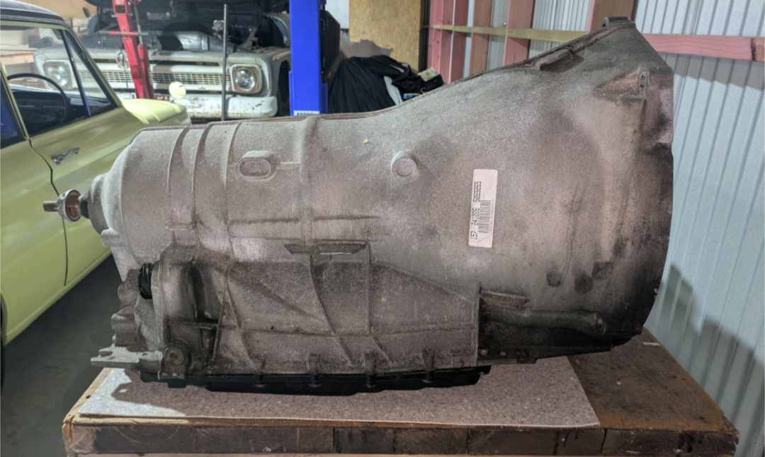

Got this from the M57 swap group on FB and putting it here before I lose it: "Shift pattern is P-R-N-D-4-3-2, to match the original 4 speed auto shifters. The standard tiptronic shifters only use P-R-N-D, and then disconnect the cable to operate Manual and Sports. Fully Clockwise should be park - you can check by trying to turn the output shaft" I guess that doesnt mean I have to faff about with the tiptronic either. One less thing to worry about.

Hi all. Need some help from the brains trust. I need to come up with a cable shifter that mounts to the dash. Only slight hitch is I'm trying to figure out the shift pattern. It's from an E60 and looking at the shifter in pics online it goes PRND. But I can feel 6 clicks on the actual shifting mechanism on the side of the box. So does that mean 7 stations? So ignoring that dilemma, as soon as I can figure out how many clicks I need I want to be able to make a cool shifter on the dash that suits the chev. Here are some cool ones for inspiration.

Tit is indeed the 6HP26. It is the cable shift one so I can come up with a cool shifter. What does the gearbox controller do that your ecu doesnt already do? I haven't got that far but a manual control would be handy for towing so I dont slug it up in overdrive too much.

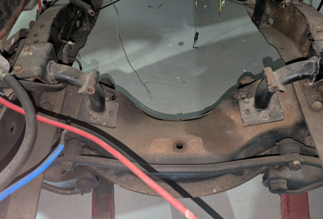

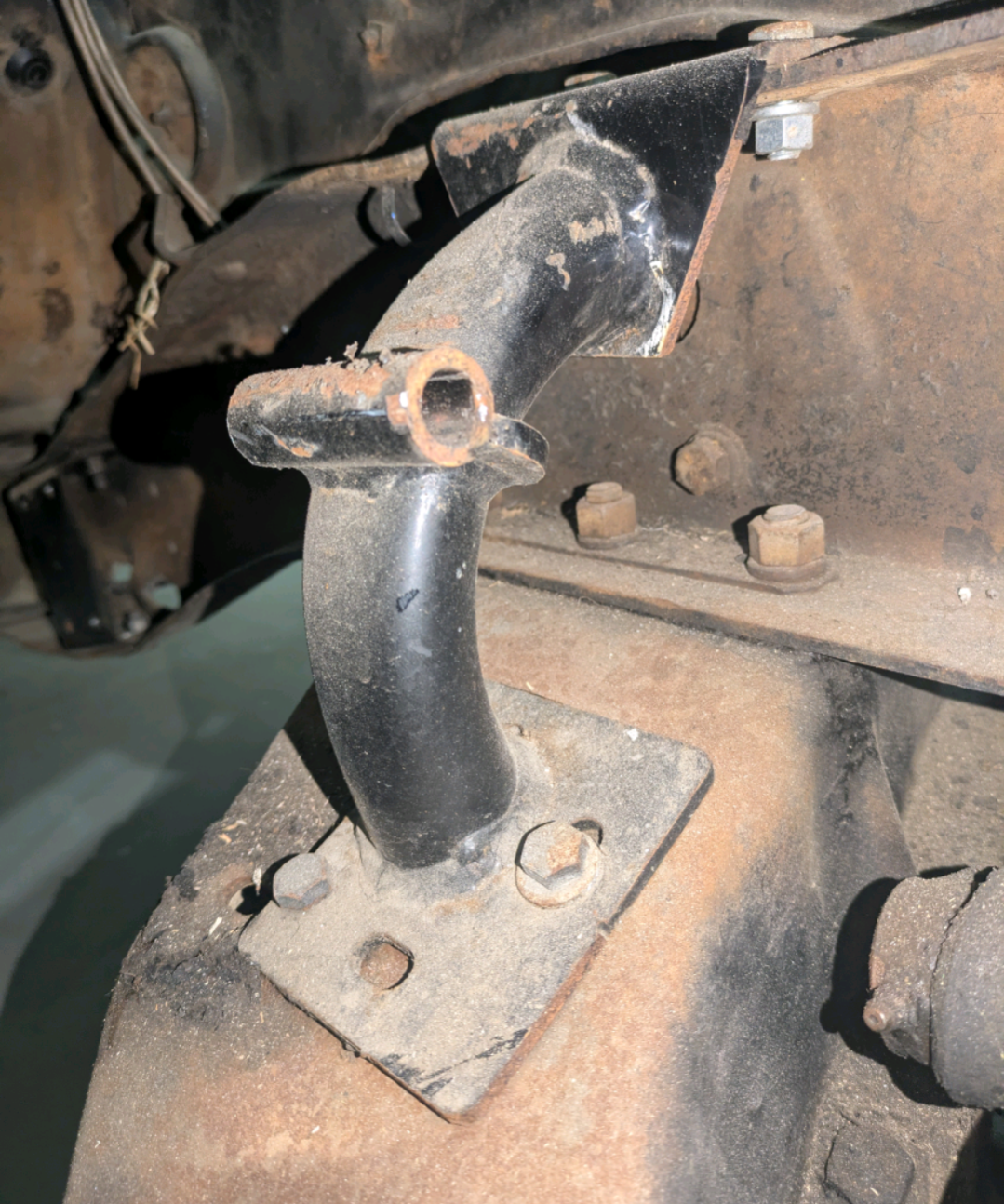

These are the mounts I have in there now I'll be either using as a basis to copy or modify. I'll get the engine and box in place with the hoist and then convince the cert man to pop over and have a squiz.
