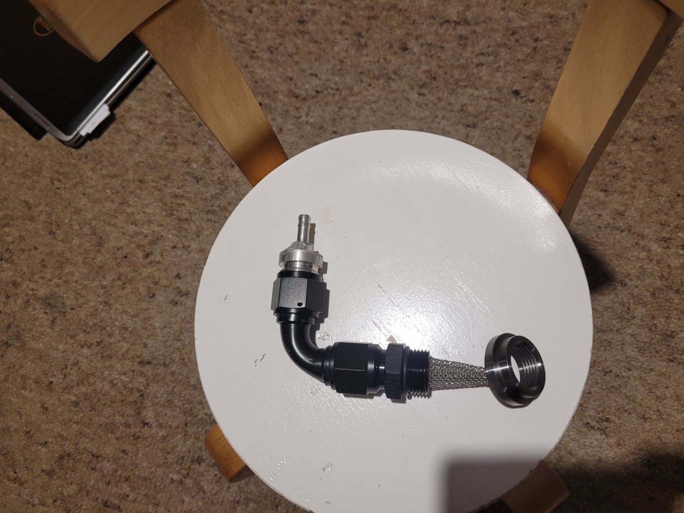

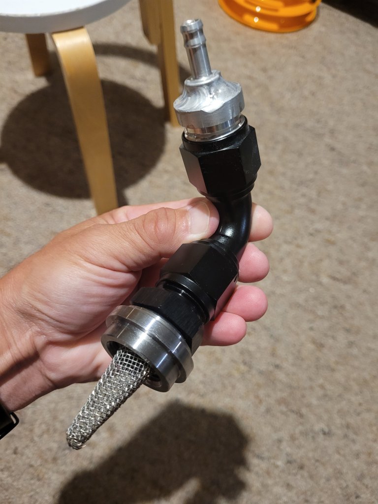

RUNAMUCK Posted January 29, 2025 Posted January 29, 2025 10 hours ago, R3spct said: I welded a drop box on the bottom of my Datsun 1200 coupe tank for efi. Good thing, zero surge, bad is it holds maybe 1.2l, and when it runs out you get one cough, then 100m you are on side of the road. I'm going to do a similar thing on my Valiant. Not because of EFI. (Not at this stage anyway) But because the fuel tank is relatively small. (68 ish litres) and the factory pick up sees the engine stop dead when there's still a few litres of gas in the tank. I'm going to run a dry sump fitting (which has a mesh cone as part of it) The biggest ball ache was having to make a 5/16 hose tail, because nobody makes a fitting with that big of a step down. (The rest is dash 10 or 12, I forget which) just gonna use a bit of 3" or 4" exhaust tube. It also won't be hard to change the hose tail to 3/8 if anyone ever upgrades the fuel lines under the car. Quote
440bbm Posted January 29, 2025 Posted January 29, 2025 why not just upgrade the rest of the line to a reasonable size instead of the ballache of making that fitting and be better all round? Quote
RUNAMUCK Posted January 29, 2025 Posted January 29, 2025 Because they don't make a dash 12 to 3/8 hose tail either. And replacing the whole hardline under a car is an absolute cunt of a job. Buying two parts and getting a friend to glue them together was eleventy billion times less fuck around.......... And I'm not at a power level (yet) where it needs to be upgraded. 3 Quote

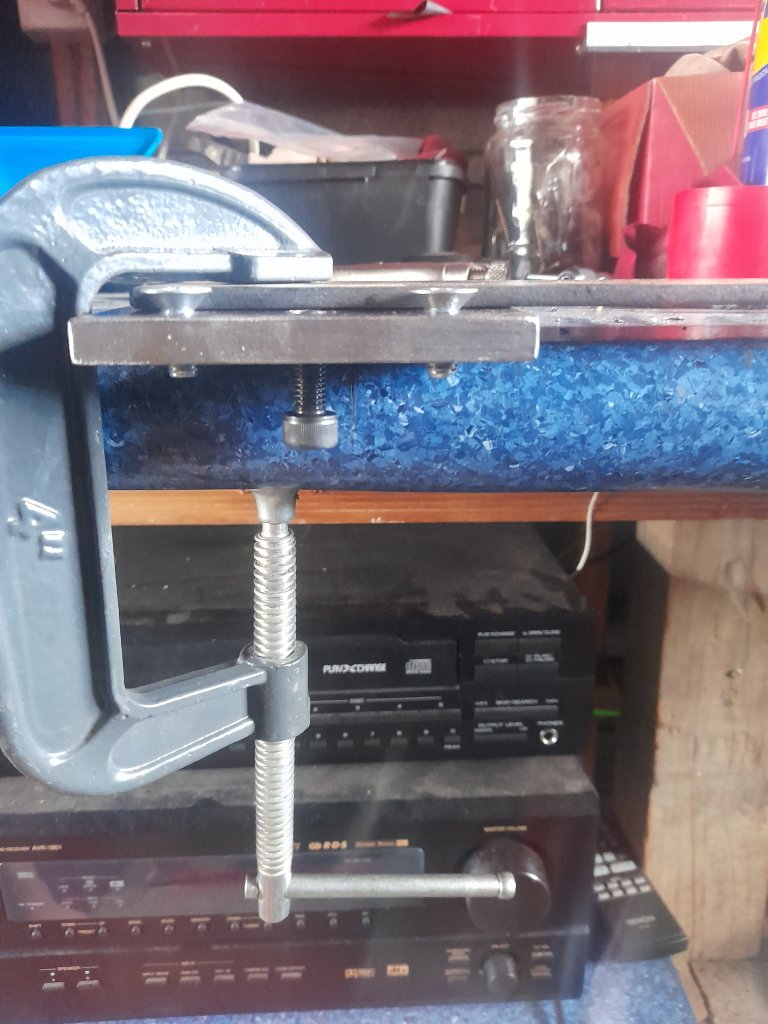

Bearded Baldy Posted February 5, 2025 Posted February 5, 2025 Ok gents, these seat adaptors... Current gameplan is to mount the 10mm packer to the 5mm plate with m8 countersunk screws, screws will be shortened etc etc. The O.E rails to be attached to the packer using m8 capscrews in the original rail holes. And the seat to be attached to the 5mm plate via the seats 8mm studs and nuts. Sound legit? 1 Quote
Bling Posted February 5, 2025 Posted February 5, 2025 Are the countersunk screws you have 8.8 rated? Never used any myself so just wondering. Quote
Bearded Baldy Posted February 5, 2025 Posted February 5, 2025 @Bling counters and caps are all 12.9, wasn't planned that way but that is all they had. 1 Quote
Tiger Tamer Posted February 6, 2025 Posted February 6, 2025 I suppose your design will be up to your certifier (I like it). I have been told I need to have at least three threads protruding through the other side. So you can't shorten them flush. Not sure what the three threads protruding do though. With sliding parts hopefully that's not a problem for you. Quote
Bearded Baldy Posted February 6, 2025 Posted February 6, 2025 Hmm 3 thread protusion would stop the rail from sitting flat onto the adaptor... would hope as all threads are cut into the 10mm thick section it will be ok. But common sense and nzta don't really go together. Quote
cletus Posted February 6, 2025 Posted February 6, 2025 The threads protruding thing comes from the CCM chapter 18 That says that a bolt must protrude past a lock nut by 2 threads The reason for this is the first thread on a bolt is a bit smaller, so a nyloc or similar lock nut will not grip the threads correctly if it's flush. Unfortunately some of the requirements in the book don't fit every situation, and sometimes are misinterpreted or applied where they don't need to be Personally I would not require 2 threads past the face of a threaded part, as long as there's enough thread engagement in the part itself 5 2 Quote
Bearded Baldy Posted February 6, 2025 Posted February 6, 2025 Ahh that makes sense, downloaded the ccm last week but haven't gone through it yet. Figured no point looking at the old ringbinder one in the shed. The local cert guy is about 10 minutes away but is hard to get hold of. So i appreciate all your input @cletus and team. 1 Quote
