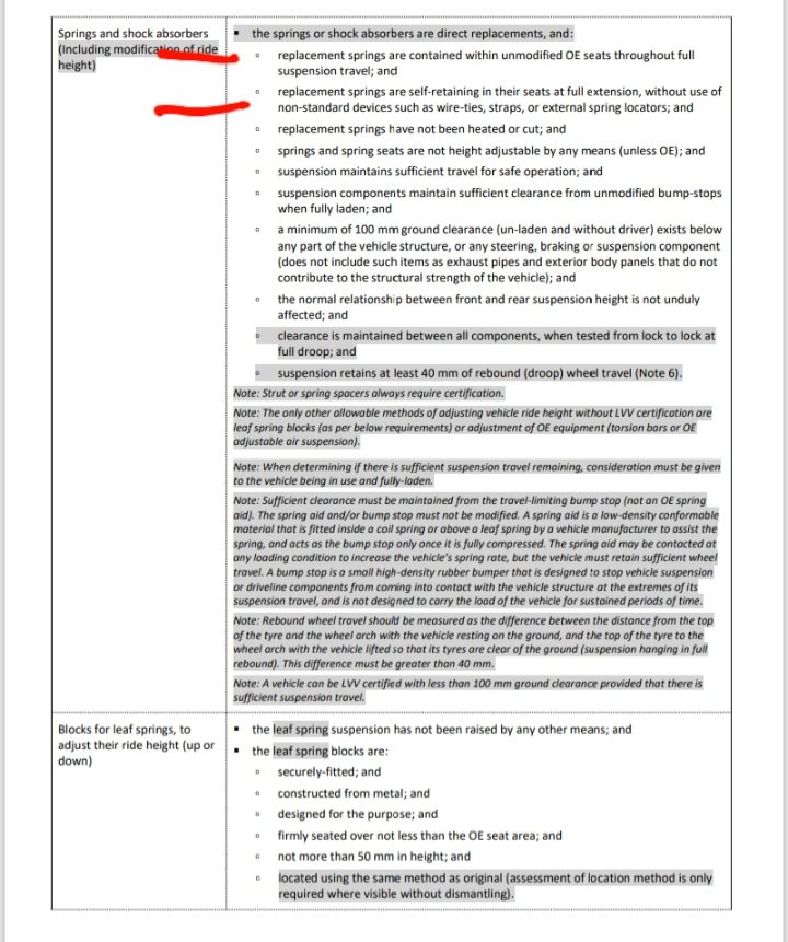

GARDRB Posted March 26, 2025 Posted March 26, 2025 I know that circlip adjustable shocks are frowned upon and the WOF man will want to see a Cert, but what about Bilsteins with just a single circlip groove in them? They don't seem to do them without the alloy perch and circlip for my car. Am I gonna have any issues? Just to push my luck even further, I also have a set of bolt in Altezza Bilstein shocks with Bilstein springs, the catch is they run a keeper spring. Would the keeper spring be an issue? This is a kit that was offered by Bilstein with a matched shock and linear spring and keepers. I have two options to look at and I would rather not go down the Cert rabbit hold for either. 1) Use existing Bilstein Shock and spring with keeper on a new bilstein shock that hasn't got extra grooves cut in it. 2) Get new Bilstein Shocks that don't have grooves and run a normal lowering spring without the keeper. What are my chances of getting a WOF that doesn't require a WOF man that doesn't know or doesn't follow the rules? Quote
cletus Posted March 26, 2025 Posted March 26, 2025 Rules, for not getting a cert = can't have a non original spring seat = can't have any means of spring location that isn't spring being correct length So those bilstein shocks technically require cert unless factory fitted to that specific vehicle regardless of if they have several circlip grooves or one. As for if you will have trouble with wofs? That will depend on the wof persons knowledge. There's probably tens of thousands of cars that should have a cert that dont, because the most common phone conversation I have is "it's been like that for xxx years and the wof guy says I need a cert now because the rules changed" (they didn't, someone just read the book or got reviewed by nzta) 1 Quote

GARDRB Posted March 27, 2025 Posted March 27, 2025 I think it's more that a lot of the Bilstein range (especially the one with eyes at the bottom) uses a slip on spring perch like this so they can essentially produce a smaller series of shock absorber bodies and slip a vehicle-specific perch onto them like how "body adjustable" coilovers are done so they don't need to weld up a million different clevises and perches. I'd interpret it as a replacement with a welded perch being fine, but once the manufacturing and attachment of the perch changes it becomes an issue So in my situation it appears that you also run into the same situation with a Koni adjustable shock too Hmm, and the Koni STR I mean, you'd probably get away with it, but I don't want to have something else to stress about come WOF time each year just because the WOF guy wants to be a dick. This is meant to be my low-stress car (once I wind more camber into it than I'm allowed for cert to get my tyres to clear my guards) Quote
