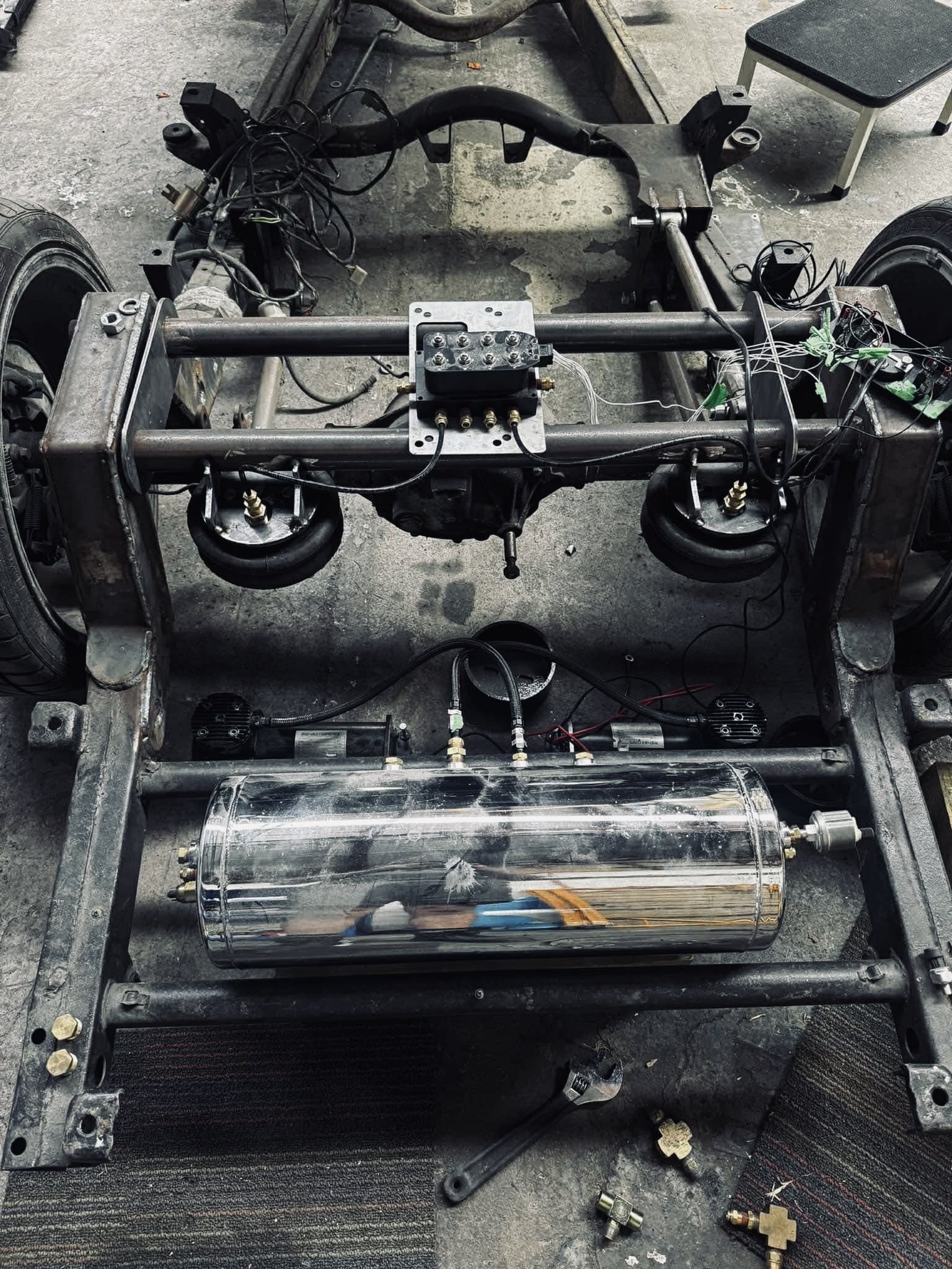

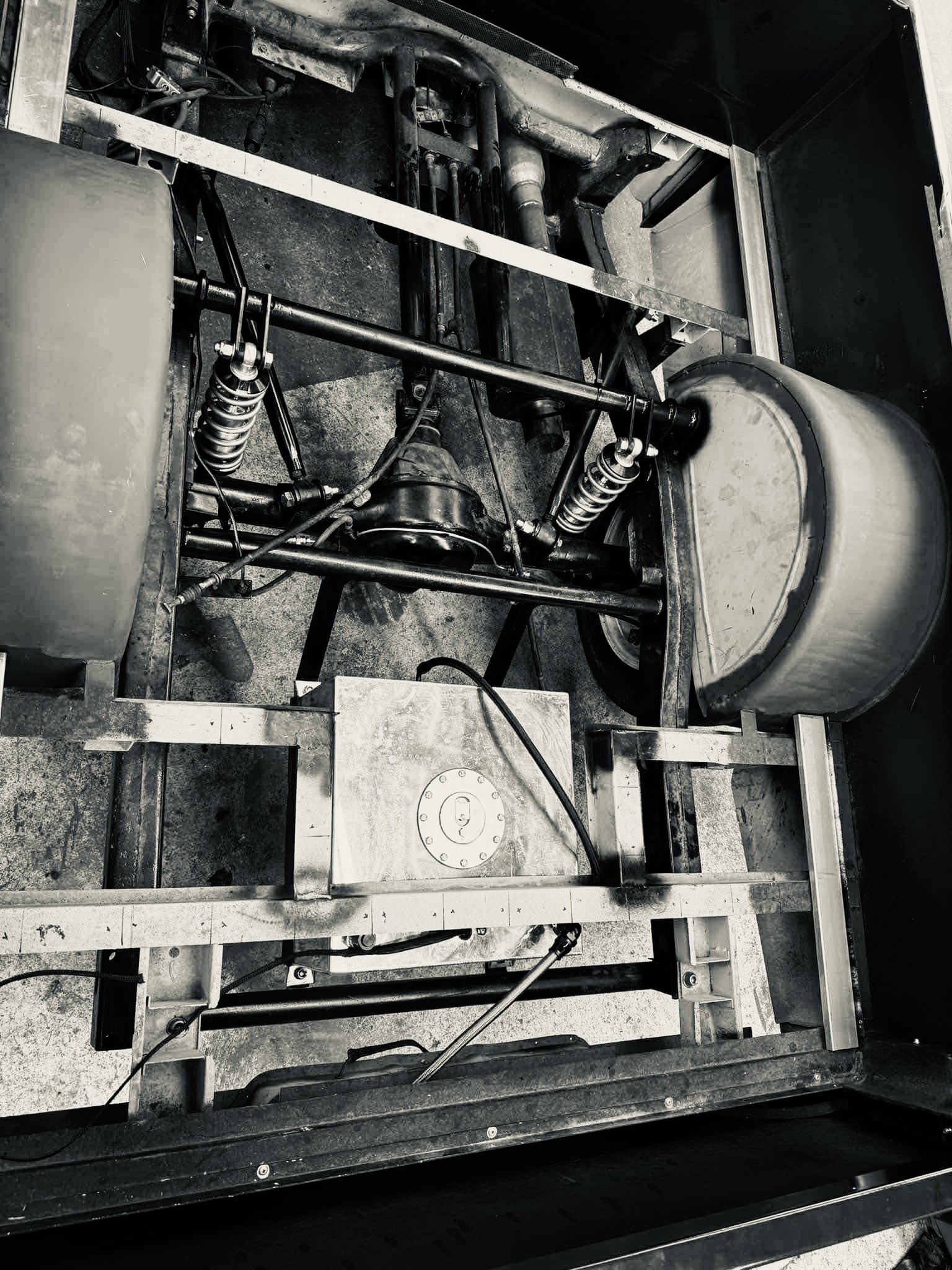

  17. So this is where I’m at with the back end of the ute now. fuel cell has been mounted below the deck on a cradle that bolts up from underneath. a fuel pump will be mounted to the side of the frame and a alloy bash plate /tank protector folded up and screwed to the cradle. just have a couple of things to finish off under here before the flooring can go back in. I noticed that I tacked in one of the tub cabs back to front so that needs to be changed ffs. I pulled the seats out of it today, need to paint the doubler plates and take photos of the sheet metal etc before they go back in. while the seats are out I stripped them right down and will put the tan covers onto a black set I have, cos the passengers seat is full electric not just e- slider , I’ll also wire up the heated seat pads (uppers only). Cos why not. I also figured out how I will do the front driveshaft hoop, it will mount from the chassis not the cab. I’ll get this done when the exhaust is redone. then I got sidetracked and started looking at the bag stuff on the 2nd chassis. should really sell this one to “declutter”.

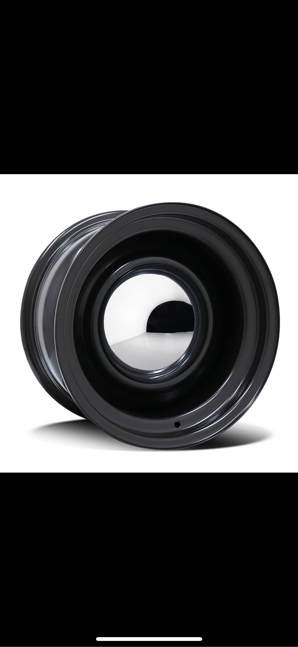

  20. I did think of that just after I replied. although the chromies are $3-400 more
  21. If I can find a chrome trim ring to fit a black smoothie then I’d be all over it like butter
