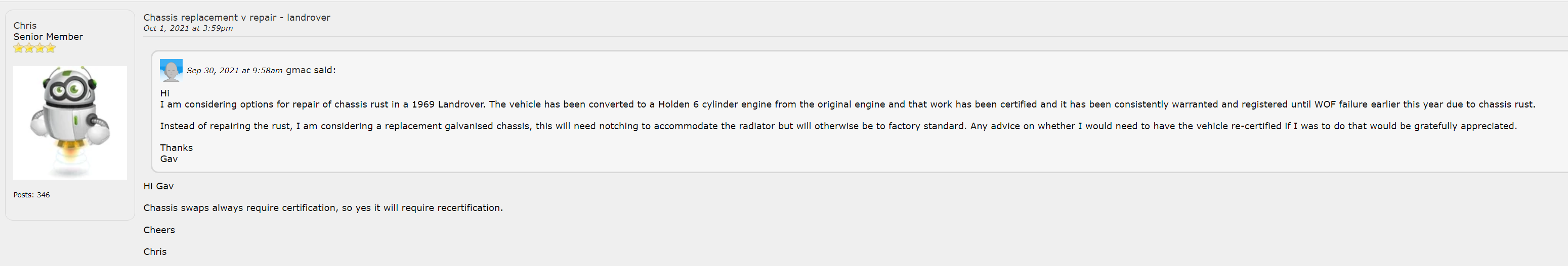

johnny.race Posted December 15, 2024 Posted December 15, 2024 Hi, if a pickup chassis is found to be rusty/cracked and it's easier to replace the entire frame with another same type/model ... does the vehicle have to undergo a cert inspection? If not - is there a form or something you fill in to say a replacement chassis has been fitted featuring a different chassis number? The rusty vehicle is live, the other is from something dead to the system. Ta. Quote
Nominal Posted December 16, 2024 Posted December 16, 2024 19 hours ago, johnny.race said: Hi, if a pickup chassis is found to be rusty/cracked and it's easier to replace the entire frame with another same type/model ... does the vehicle have to undergo a cert inspection? If not - is there a form or something you fill in to say a replacement chassis has been fitted featuring a different chassis number? The rusty vehicle is live, the other is from something dead to the system. Ta. That would be more of an NZTA / Identity / Repair Certifier issue than LVVTA thing. Technically you probably should use the identity of the donor frame so have to go through re-reg on that to get the numbers to line up. Quote
Nominal Posted December 16, 2024 Posted December 16, 2024 Then again, although this is for something that was already LVVTA certified 1 Quote
JustHarry Posted December 16, 2024 Posted December 16, 2024 20 hours ago, johnny.race said: Hi, if a pickup chassis is found to be rusty/cracked and it's easier to replace the entire frame with another same type/model ... does the vehicle have to undergo a cert inspection? If not - is there a form or something you fill in to say a replacement chassis has been fitted featuring a different chassis number? The rusty vehicle is live, the other is from something dead to the system. Ta. Does the chassis have numbers at all? Or even easily readable? /grind the numbers off and cover in dirt 2 2 Quote
