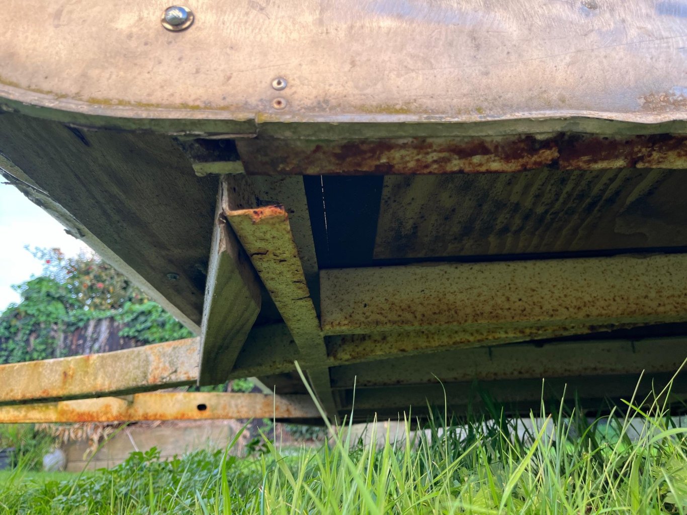

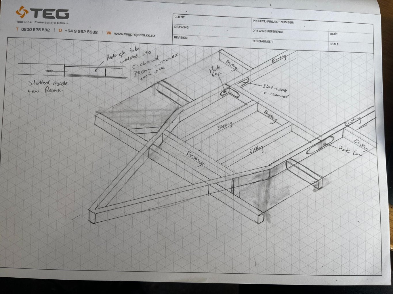

Rhyscar Posted September 29, 2024 Posted September 29, 2024 Hey bit of a trailer/caravan query I'm sure someone has deep-dived into this before. I'm wanting to replace the jaw bar on my 70's-era caravan. I'm trying to do this all in place, without removing the body as it's a big job. Will do everything new in Duragalv and wire wheel & paint the rest of it. This what I've come up with so far. I've got two questions I haven't been able to answer through google; - Are there any LVVTA rules around trailer repairs such as this? Doubler plate sizes, connection detail to c-channel, welder qualifications etc? - Where do I find the requirements for tow coupling mounting? Appreciate the help! 2 Quote
Popular Post cletus Posted September 29, 2024 Popular Post Posted September 29, 2024 There are no lvvta rules, and the wof requirements are very minimal for light trailers, by drawing a design that's not in crayon you are already ahead of most trailer makers 7 1 17 Quote

Bearded Baldy Posted October 7, 2024 Posted October 7, 2024 On 30/09/2024 at 09:04, Rhyscar said: I've got two questions I haven't been able to answer through google; - Are there any LVVTA rules around trailer repairs such as this? Doubler plate sizes, connection detail to c-channel, welder qualifications etc? - Where do I find the requirements for tow coupling mounting? Appreciate the help! For trailer builds i tell people eye appeal is half the battle in regards to wof. If the welds look good and the steel isn't tinfoil then that is 99% of it. As said above, your design work already beats most of the glorified wheelbarrow builders out there. For the coupling i picked up a great way of doing it from one of the local engineering shops. Their gear gets abused by farmhands etc so needs to be built tough. Use a section of i-beam with the base ground off. So simple it amazes me it isn't 'the way'. Pic to follow. 2 Quote
