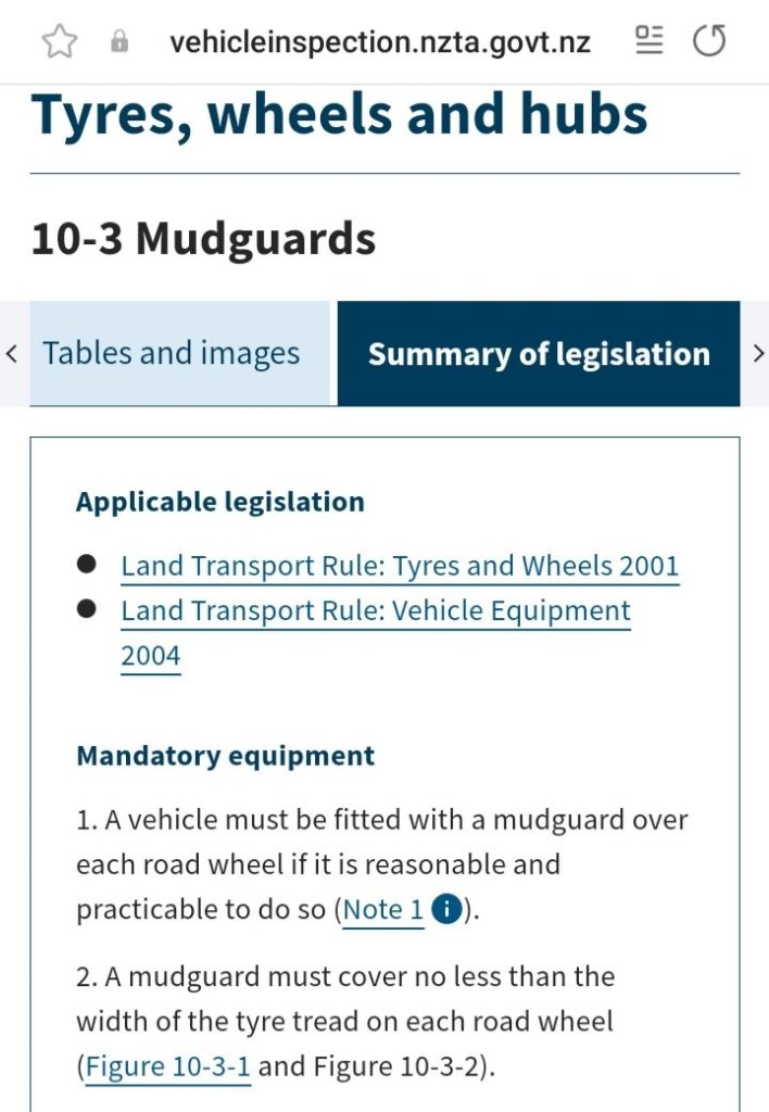

I need to get the car re-certed anyway due to removing the race seat so I don't mind the fact that I've got to get it ticked off, but my car currently has aftermarket guards which the wheels protrude from (around 1/4" at the 12 o clock position) which I think falls into the "requires certification" category - but what criteria will the cert guy actually look for with widened track and wheel protusion? I'd like to tidy anything up that I can before he sees it, to save a second trip etc
On that note, whereabouts is wheel protrusion measured? as mentioned my wheels stick out 1/4" at the 12 o clock position, but as you move around to 3 / 9 that grows to around 3/4"

Wheels can poke out, tyre tread has to be covered to at least the height of the hub center
It's kind of a grey area, and one thing that grinds my gears somewhat
If you read the wof virm, everything requires this
But a vast percentage of even standard vehicles don't comply with the wof virm to some extent
It's not clear, because the words are different to what the drawing shows- ie the words say it just has to cover the top of the tread , but the diagram suggests full width to level with the center of the hub
