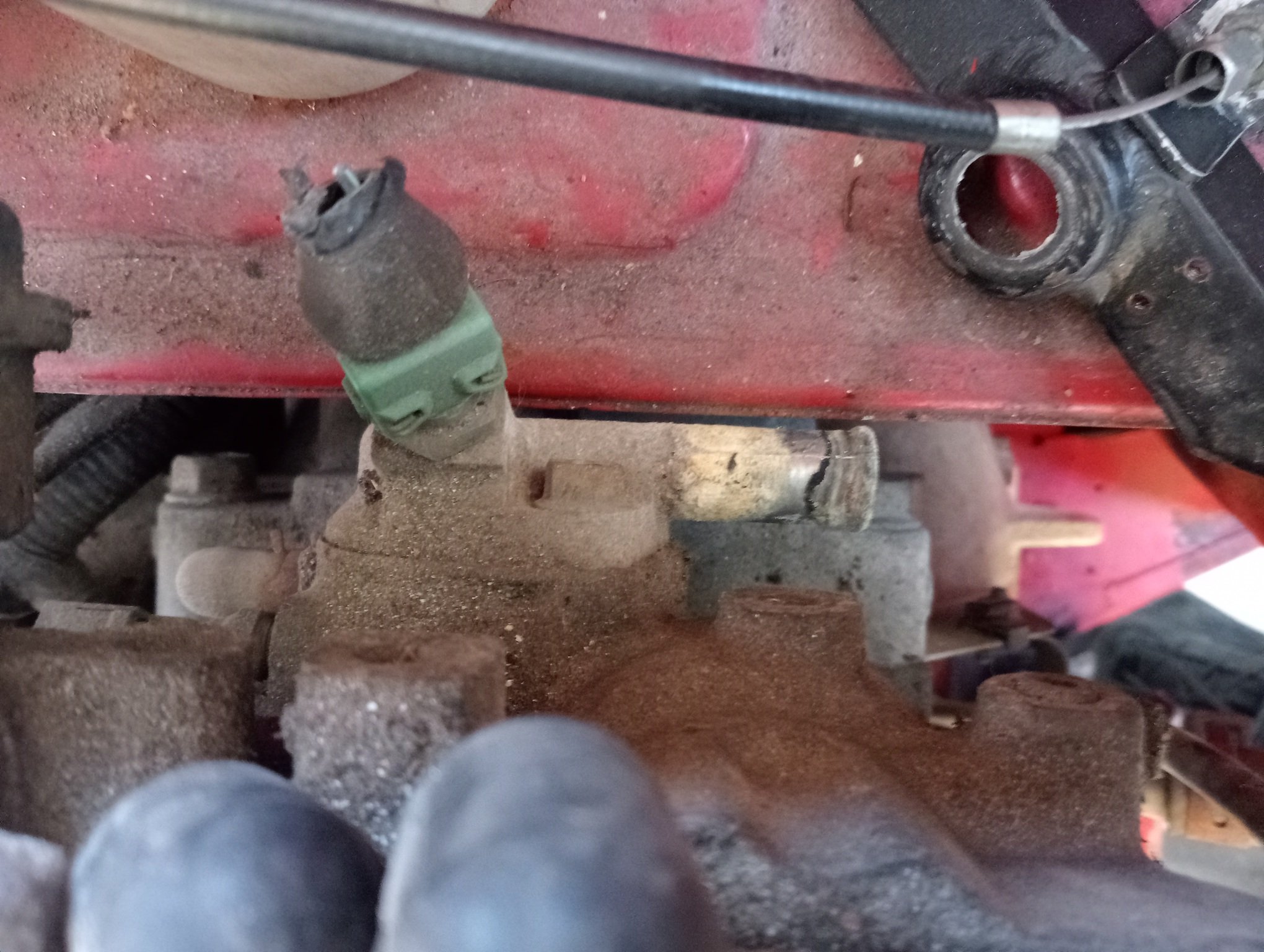

some uninteresting photos unless you're interested - here's the current longitudinal alignment; which results in this arrangement over the steering rack and this somewhat tight throttle body clearance under the bonnet (with bonnet set to it's lowest) - but clearance nonetheless- 7 replies

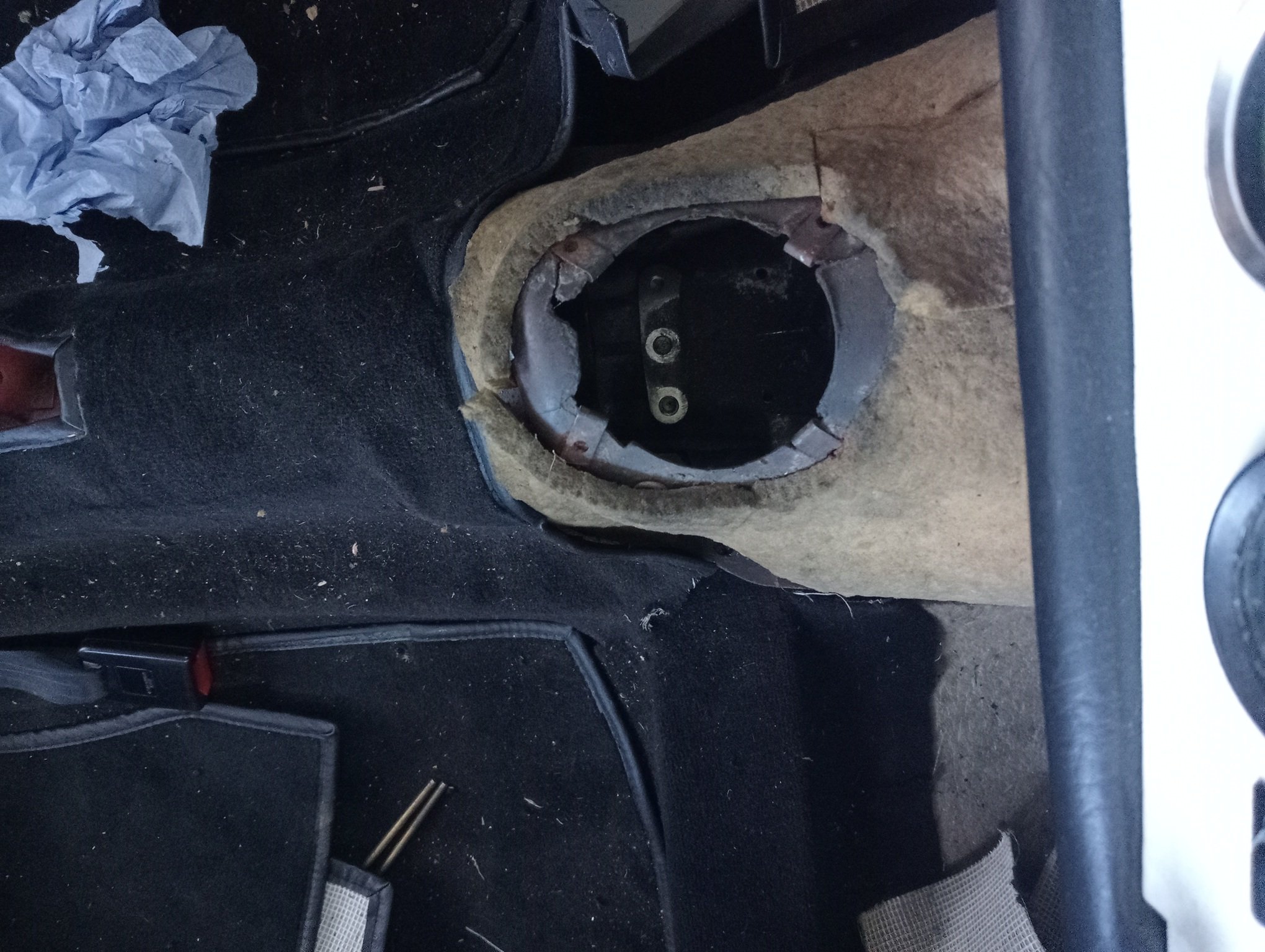

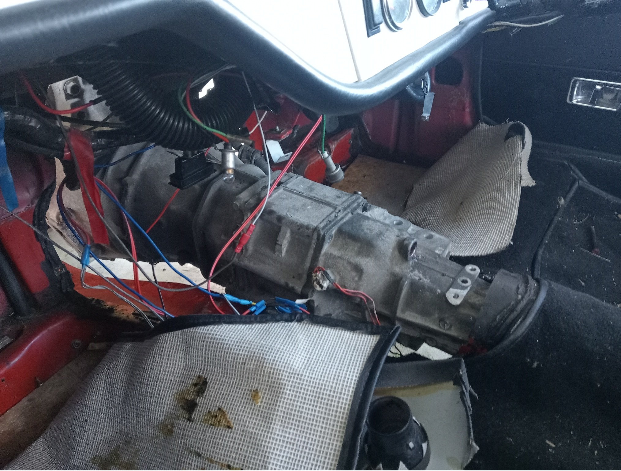

transmission fits the tunnel perfectly except the shifter is miles back, probably just about under the handbrake. No wiring was disconnected prior to this photo it was all legitimately just hanging its guts out like that since around 2012 there is a well documented mod to move the shifter forward but it's still not quite enough to get it back to the factory hole in the trans tunnel. the mod places the shifter about two inches aft of the mount points showing which would have it coming just through the wall of the tunnel. I decided I could do better by doing away with the mount points and bringing the shifter as far forward as possible. I wish I had just gone with the original modified point! the mechanism is EXTREMELY sensitive to misaligment and the selector rod will jam up if it is not completely, perfectly straight. right now the whole thing is sitting on a workbench jammed with shims and things-acting-as-shims, waiting for some brave soul to TIG some new mount points onto it. I might get a photo of the finished product, but let's just call it a work in progress with the aircon pulley mounted just over the steering rack and the larger alternator pully sitting just behind, this is the nearest pinch point - the heater (I think?) outlet at the back of the head just sits off from the firewall seam (pic is taken directly down at the rear of the engine). Once I'm assured that this is a heater line and nothing more I'll blank it off and move the temp probe. My heater is long gone -

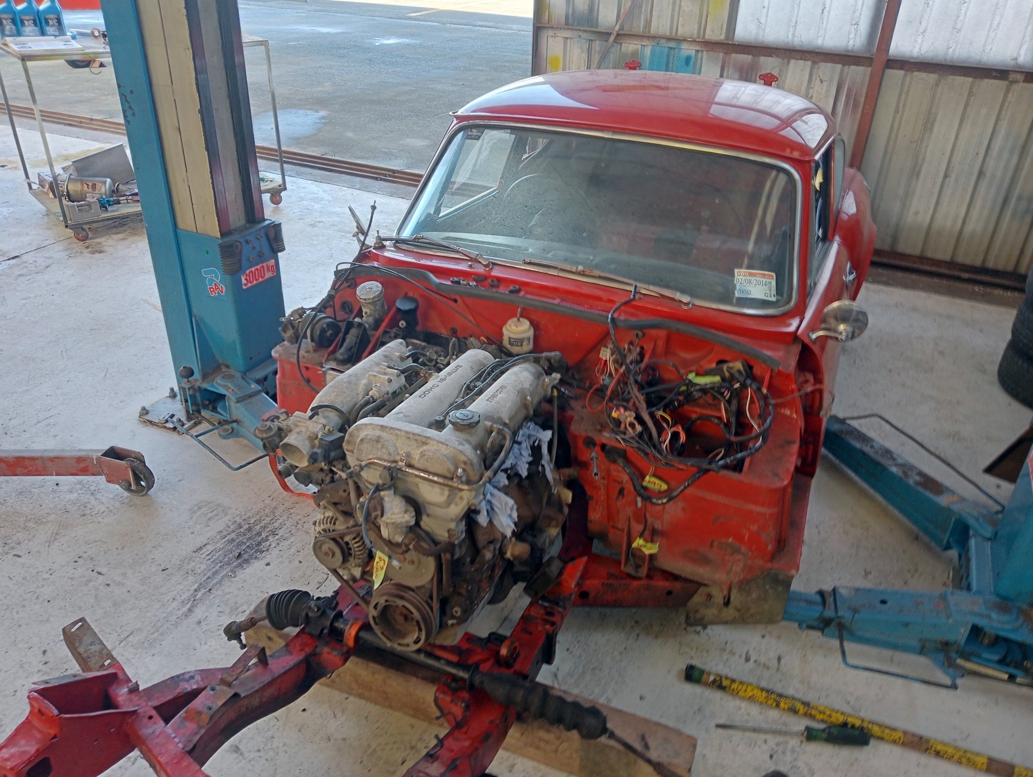

Having satisfied myself that there was nothing inherently wrong with the chassis fitment (as evidenced by others by the fact that's it's quite a common swap), most of the agonising I did was around how the engine would fit up to the body. most little triumph engine swaps end with a throwaway line like "and then I cut a hole in the body/firewall/chassis/made an ugly as hell transmission cover", which is something that I really want to avoid. so much so in fact, that I actually bothered to test-fit the body. so I'm juggling trying to avoid the chassis/bonnet/firewall, while trying to work out if I'm going to place the crank pulley over or behind the steering rack, while also being aware that the mx5 tailshaft is VERY long, putting the shifter farther and farther back, and the propshaft on a more and more marginal angle. But first, body momentarily back on; note the battery plonked back in place as ballast to stop the bastard trying to fall off the back of the hoist the gt6 engine mounts sit at 60 degrees and the mx5 engine mounts sit at 30 degrees. So a gt6 engine mount bracket on it's side becomes a 30 degree bracket and matches up to an mx5 engine pretty good. (did I mention I am impatient, and rough, and lazy) str8 in m8 no fukin worries- 7 replies

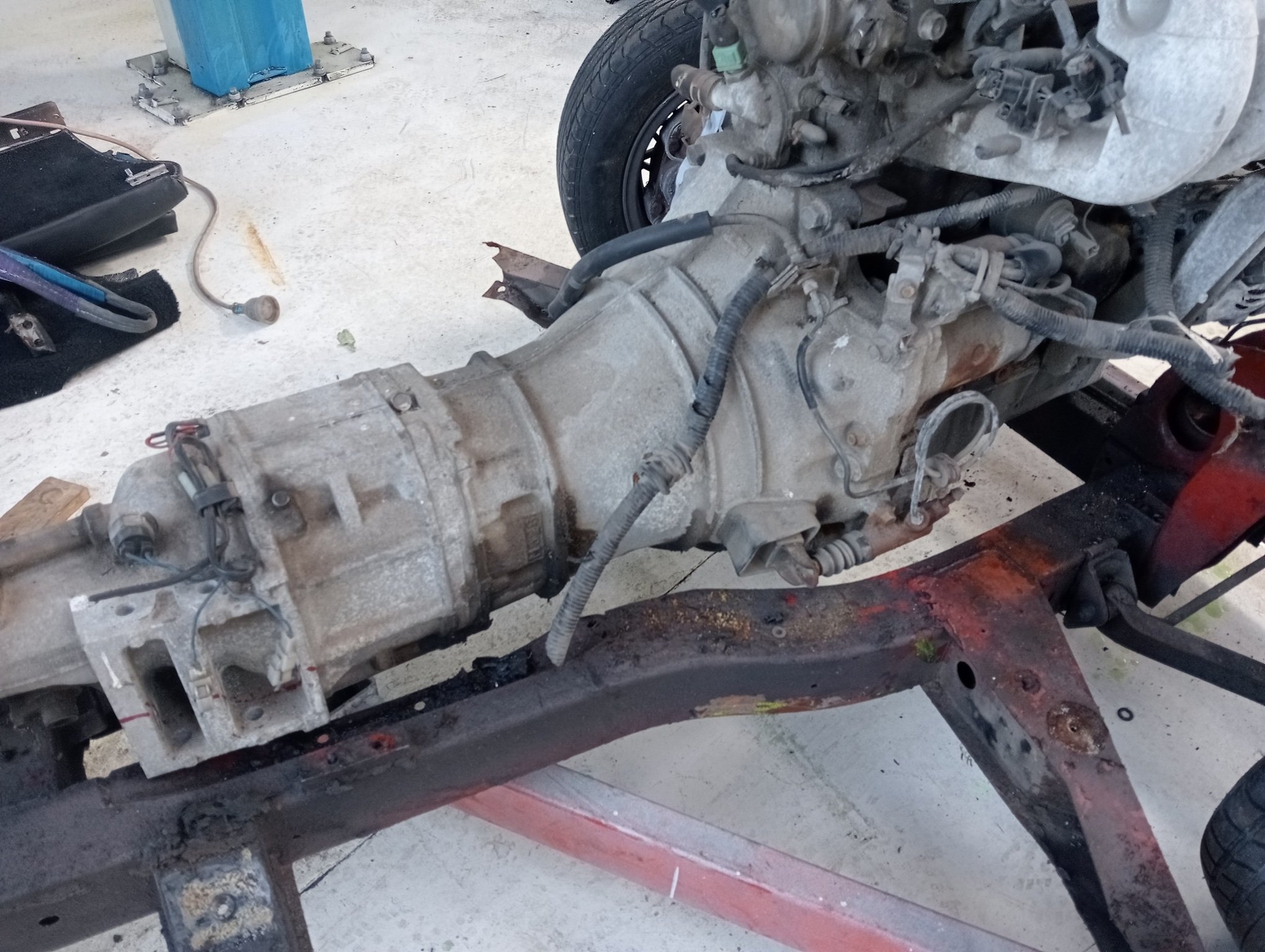

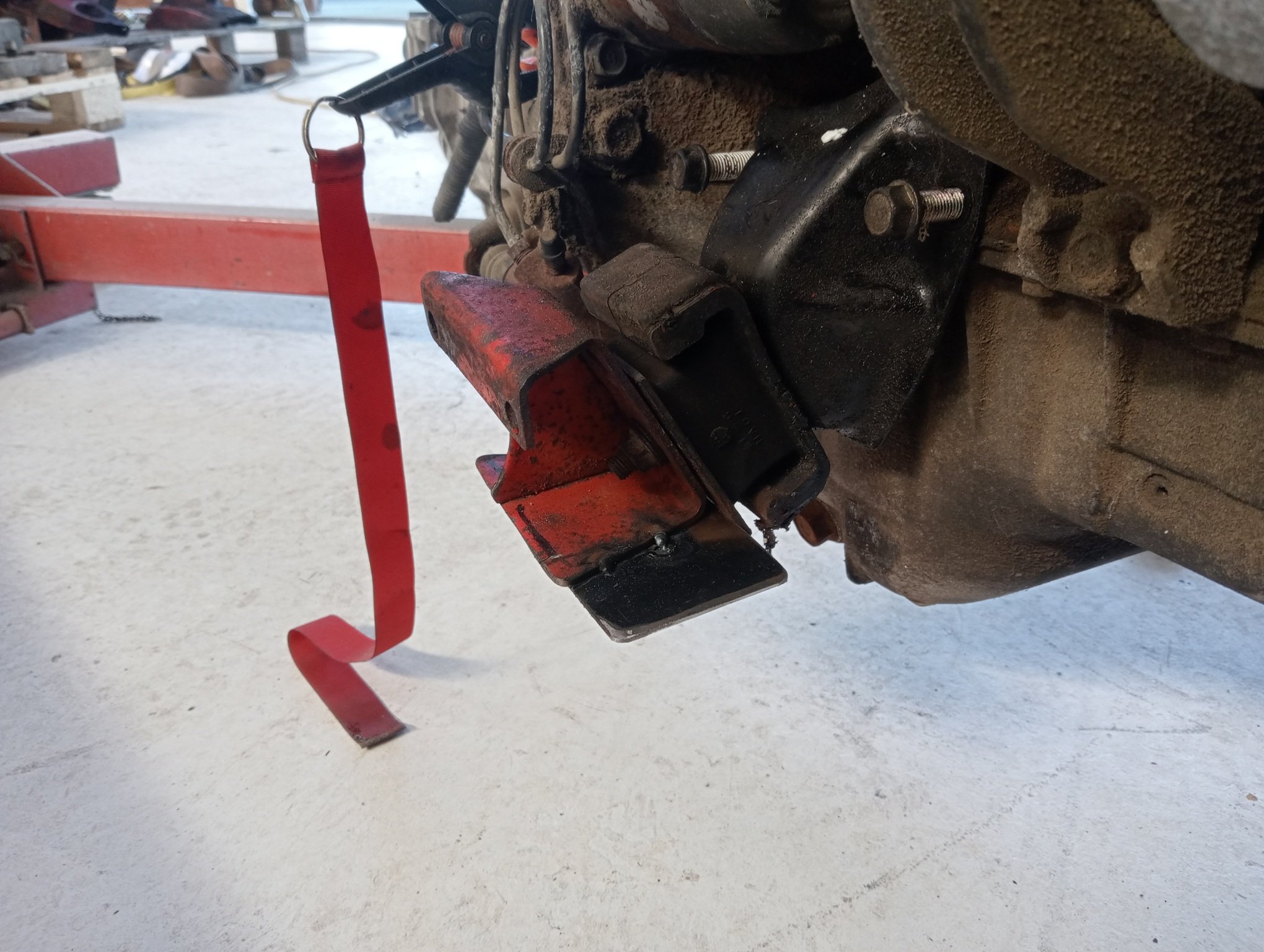

the engine plonks on and sits between the strut towers pretty good. the stock engine mounts are no good as they cater to two nonexistent cylinders. This pic has the engine rotated a little too far, it needs to be pretty flat to clear the bonnet as of the mounting plan at this time of writing the mx5 gearbox has some major alloy hanging off the side that needs to be dealt with as it fouls the frame. as far as I know any early rx7 tail housing will bolt on but I value money more than time at the moment so I just laid into it with a grinder and buzzed it all off. otherwise the clutch slave seems to clear OK and aside from a wee bracket on the other side, there are no clearance issues with the chassis that I can see With the initial "I just want to drop the engine on it and take a photo" frivolity out of the way I stripped everything off the chassis and carefully documented everything into piles of bits on the ground and piles of bits on various tables. I misplaced all my tools but some of the other guys were away so I borrowed theirs and misplaced them too. The chassis has a few cracks and the outboard ends of the outriggers are torn, the hoist might've got them on the way up, although they didn't appear to have any cushions installed between them and the body so they might've already been pulled up hard against the underside and distorted. was hoping to get it off to the sandblasters this week but they're busy, so I had no choice but to continue fiddling around with it- 7 replies

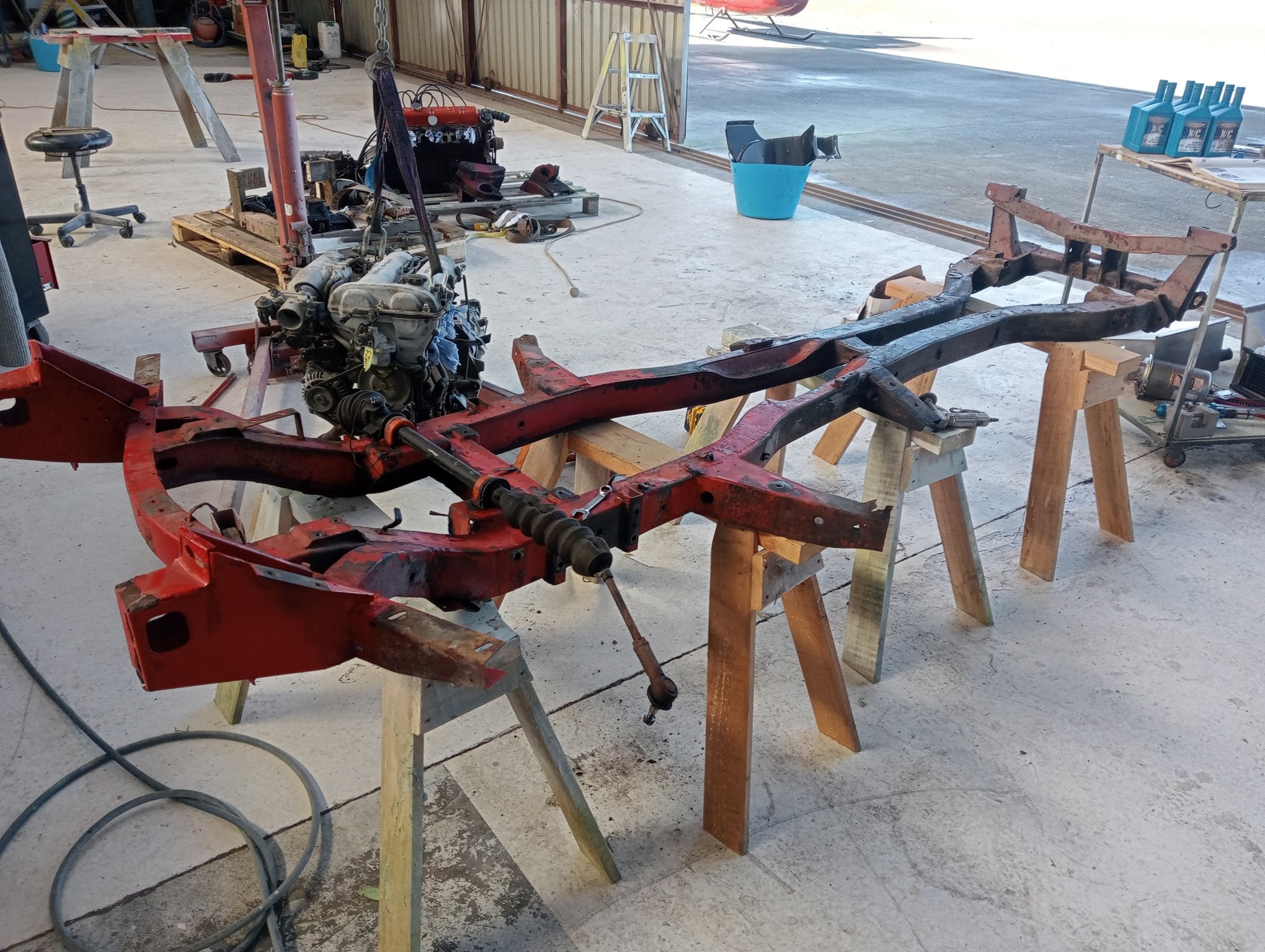

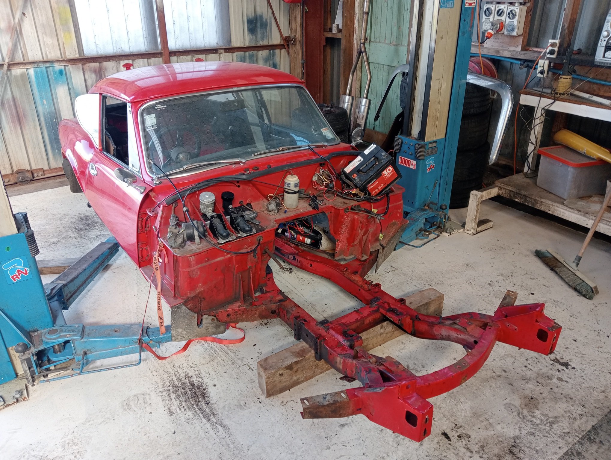

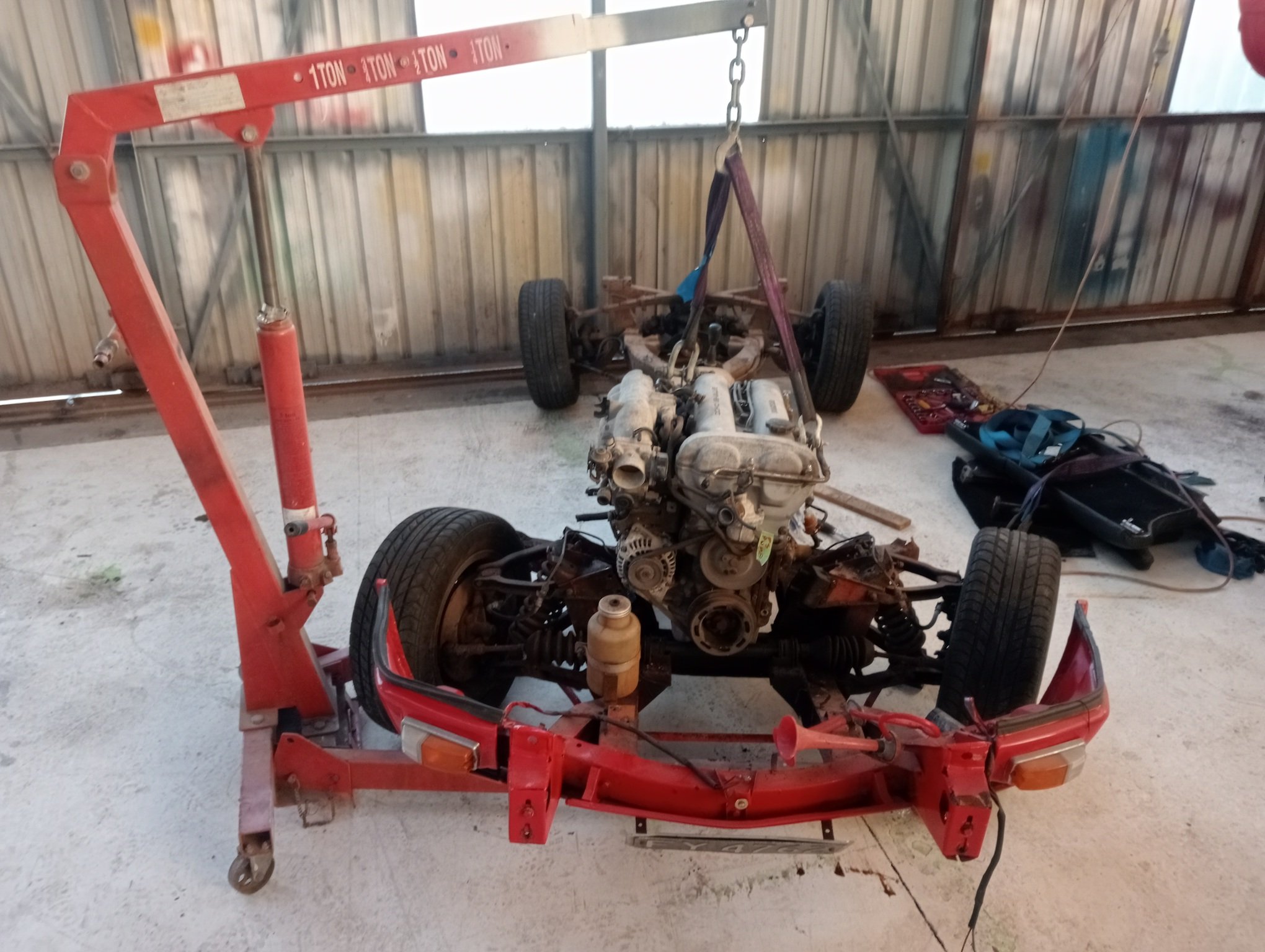

So I pulled the body. I had a GT6 "workshop manual" which was totally useless. Didn't even mention disconnecting the radius arms or rear suspension. I don't actually have a photo of it with the body off and engine still in because by the time the body was off there was pretty much nothing left to remove so I forged on and tore the motor out. only thing I had was this reference photo of the propshaft angle: the motor was then removed and carefully placed on a pallet which it immediately destroyed because it is the heaviest son of a bitch I have ever come across my phone decided to spruce up this photo, I don't know why- 7 replies

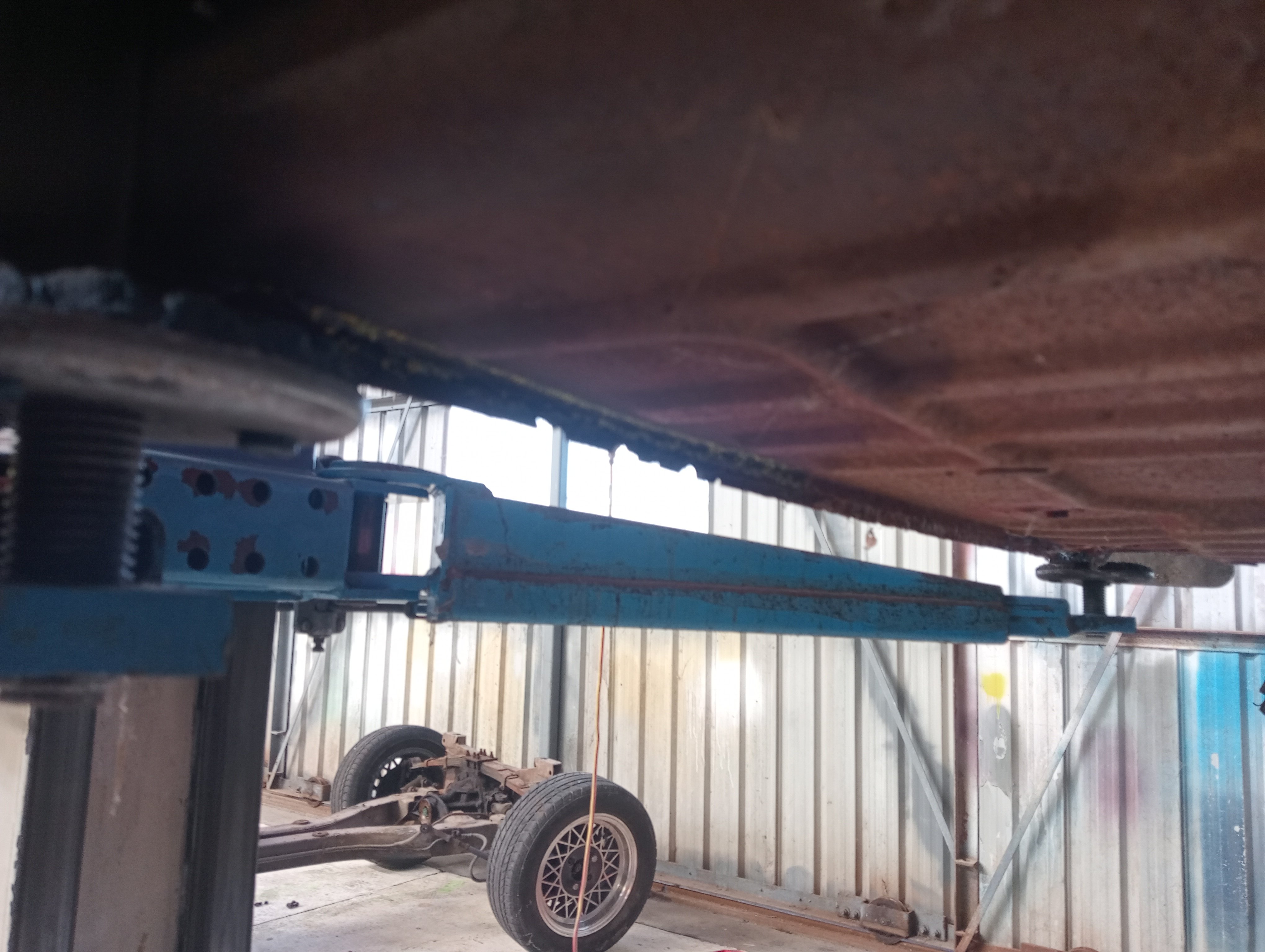

here's the underside of my gt6. the seams where the sills and floor have large corroded away, as they come from the factory with a nice chrome capping that traps all the rain and lets it fester Both sides are the same. The thing is, it's ONLY the exposed part of the seam that's gone. The floors are fine otherwise, and I've borescoped the inner sills and they're fine too. and obviously I've hoisted the whole car and aside from the rusted seams folding at the hoist points, the body is still strong. Because the seams are combination of the floor panels, the inner and outer sill, and an internal stiffener, renewing it would mean replacing all of those parts, even though it's only the exposed lower inch that's rusted So would it be totally unreasonable to just grind the remainder of the seam off, fold up a long T section of approximate gauge, and weld it in it's place? Or is that too much of a bodge up?
