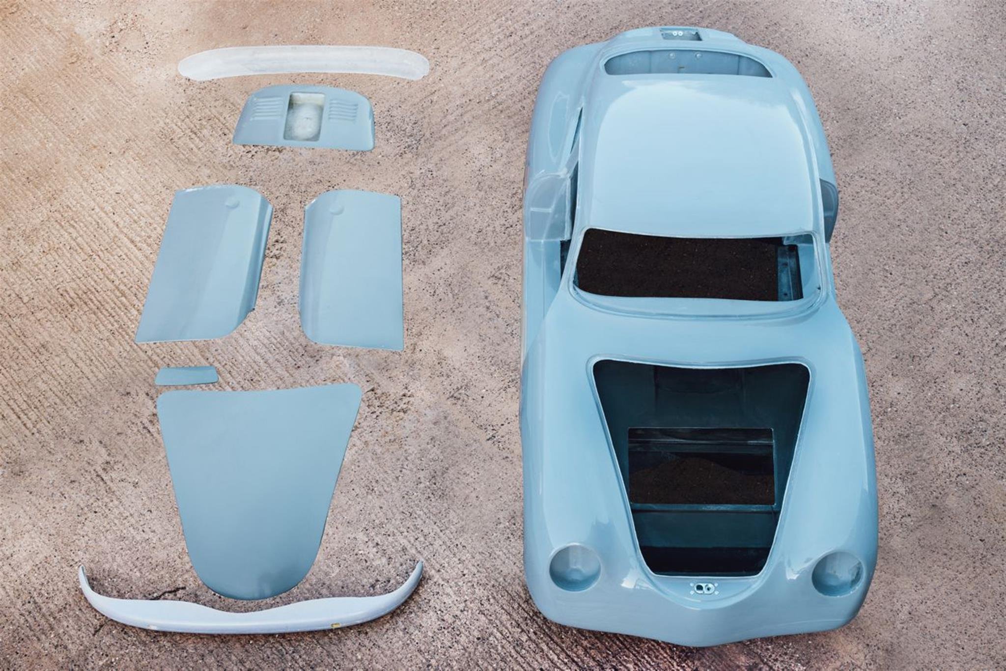

63Ragtop Posted June 3, 2025 Posted June 3, 2025 Asking for a friend, how would you get on certing a 356 coupe replica? Same as the roadster/vw based bathtub? 2 Quote
RXFORD Posted June 4, 2025 Posted June 4, 2025 I'm assuming its glass and on a shortened beetle pan? Who made the body? If its glass and on a beetle pan I would think it would be treated no differently than a vw beach buggy so it would end up as a 'scratchbuilt replica' But if its on a 356 pan it could be a different story. 1 Quote
63Ragtop Posted June 4, 2025 Posted June 4, 2025 Yes, fibreglass on a shortened vw floorpan. https://www.speedsterclinic.com/vehicles/356_a_coupe/ This place is in the UK, I'm sure there are others. I don't think the real ones ever had pans. Just occurred to me that you see plenty of convertibles and speedsters, which for some reason don't appeal to me. 4 Quote
cletus Posted June 4, 2025 Posted June 4, 2025 Would be do able for sure How difficult it would be is a how long is a piece of string question The main thing would be making sure the body has appropriate framing in it for seat belts, door hinges, door framing, torsional rigidity, etc. If it doesn't have this then adding it can be difficult depending on how the body is made 1 Quote

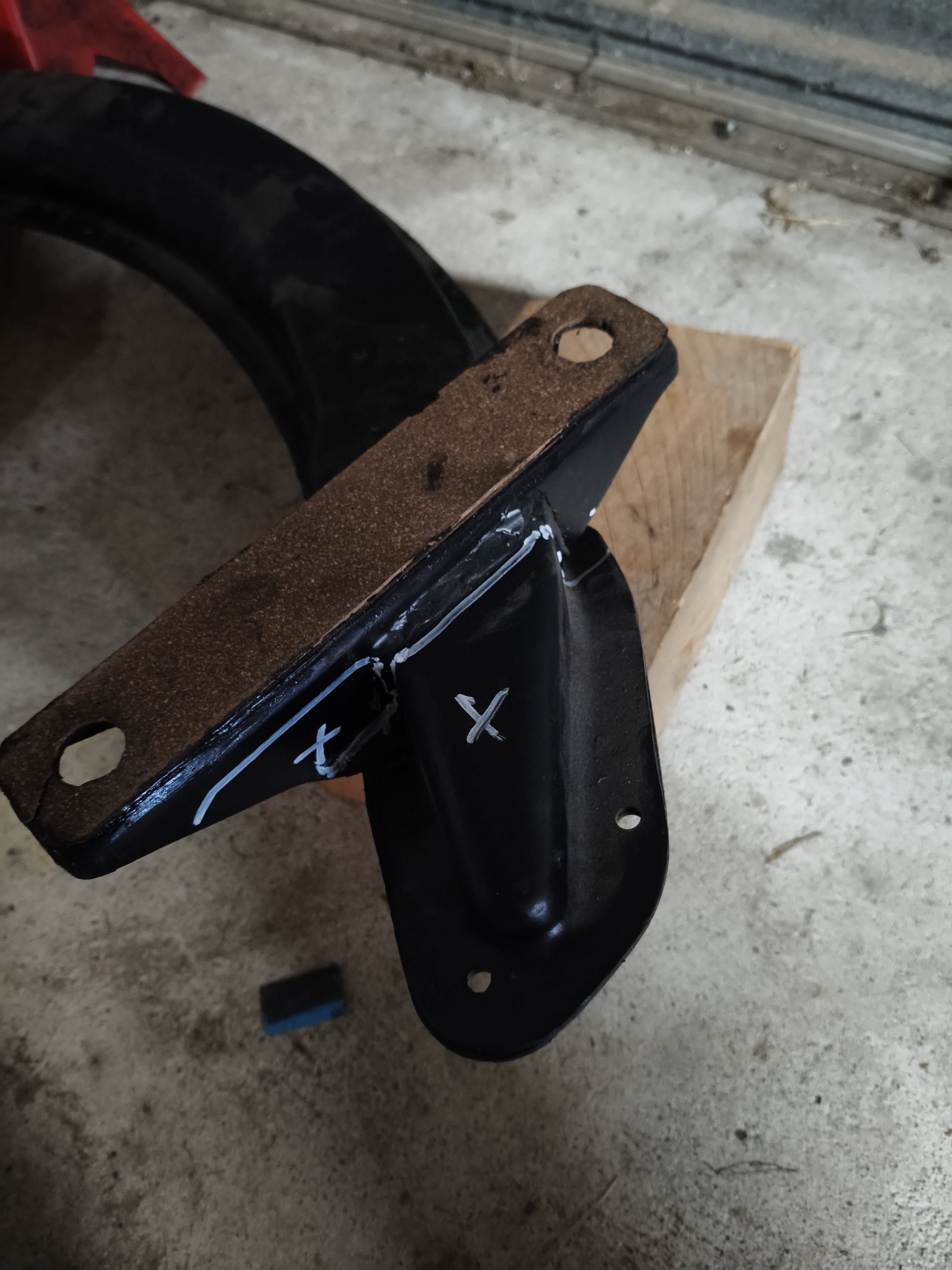

Crispy Posted June 8, 2025 Posted June 8, 2025 *Moved to correct thread* Hello, I want to add in some strengthening to the Mokes lower firewall/steering rack area. Either with a plate like this from Urchfab in the UK It looks like this and looks like this when welded in Or try make something similar up myself. Obviously I'm going to run it past my repair certifier. But has anyone tried to do anything similar to this before and it been fine? Would go a long way to strengthening the part where the bottom of the front subframe bolts up and the steering rack area, which is a common weak point and I have hear of cars cracking in this area due to fatigue. Quote

cletus Posted June 11, 2025 Posted June 11, 2025 On 08/06/2025 at 15:50, Crispy said: *Moved to correct thread* Hello, I want to add in some strengthening to the Mokes lower firewall/steering rack area. Either with a plate like this from Urchfab in the UK It looks like this and looks like this when welded in Or try make something similar up myself. Obviously I'm going to run it past my repair certifier. But has anyone tried to do anything similar to this before and it been fine? Would go a long way to strengthening the part where the bottom of the front subframe bolts up and the steering rack area, which is a common weak point and I have hear of cars cracking in this area due to fatigue. cant see a problem with that, would need lvv cert as its a modification, rather than a repair Quote
