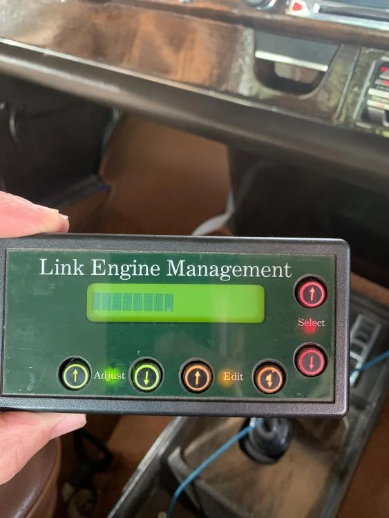

Anyone find a use for a oldschool Link plug in digital controller? Same as this but screen works as far as I know.

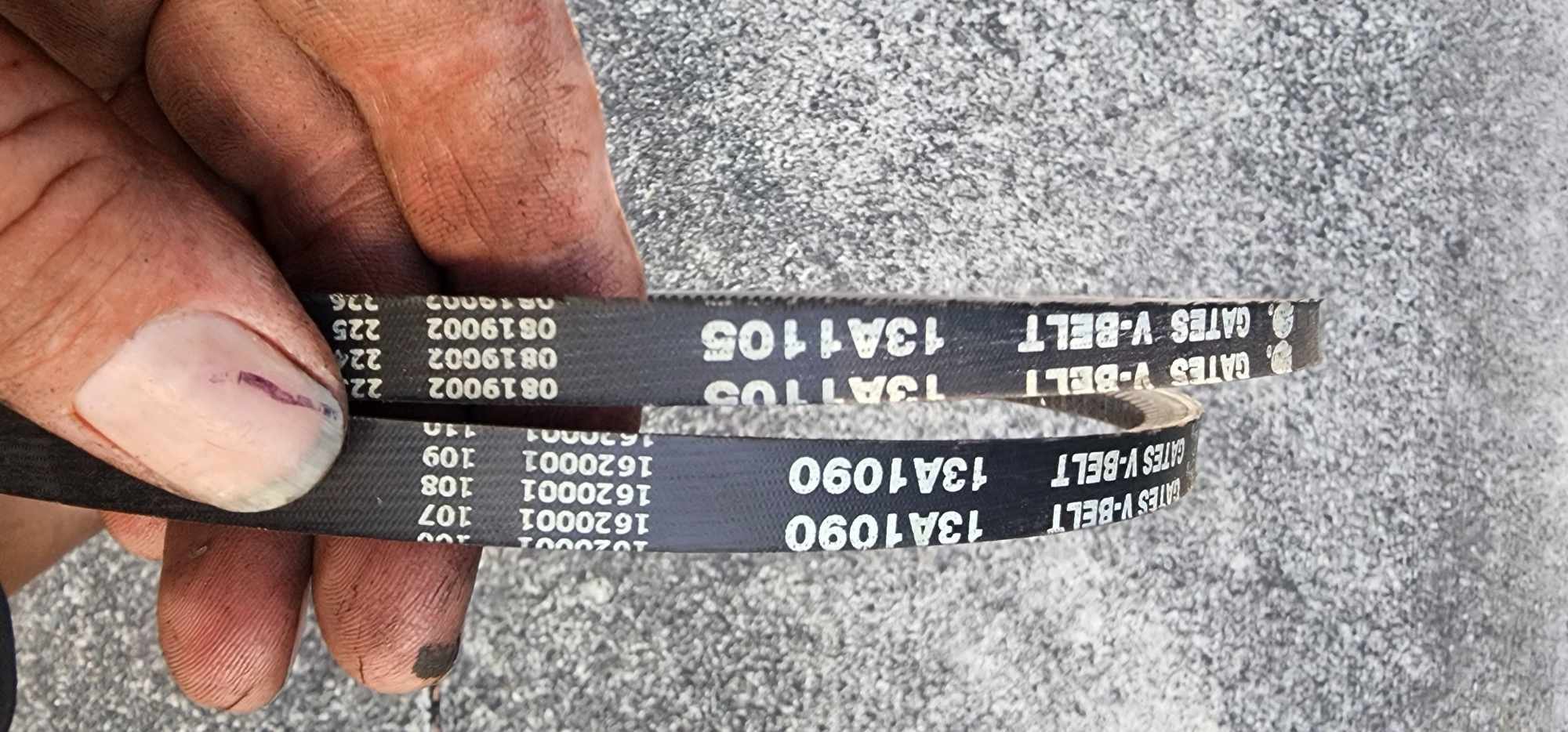

Interesting question, but it was turning ok when I last tightened it. I shouldnt be under any particular electrical load, and turning headlights on didnt change it, just rpm. But the belt I just took off was worn down to under 10mm wide from 13mm, so it had a lot less contact area than a new one. I did look at a replacement alt before fitting the secondary one, but finding a bolt on upgrade option with the vac pump was spendy. Hope I dont have to replace it....
Is a few on Tardme, NZAD in Henderson says they have a Bosch one. Hopefully can get past there tomorrow and grab one. Im wondering if there is any value in polishing the surfaces of the pulleys. The idler definitely has some pitting and roughness to it, but the Alt belt is the one thats really tearing it up based on the amount of powdered rubber around it. The alt is just the stock one, with the vacuum pump for brake booster. Ive got a secondary 200amp alt where the AC pump used to be, running off a different rib on the front crank pulley, I charge my 24v house battery with this, and it barely does any load. Ive never seen my clamp meter show more than like 10amp from it.
Dayco belts dont seem common, just keep getting Gates ones coming up. Found a HD gates belt for "industrial use" at repco, not sure if its worth the extra money tho.
My Bongo, R2 diesel engine, has been pretty hard to keep alternator belts alive. Google says its a 13a1105, which was the last belt I had, which only lasted maybe 3000km. Originally I think I had a 10a profile belt, which didnt last long either. It has a pulley for the fan, which isnt for the water pump, so just an idler. The front crank pulley has been replaced, but not the idler or the alt pulley. Its been getting noisier the last 500km or so, and last drive it was screaming the whole way, tightened it up when i got where I was going, and it made a noise like a supercharger belt but got me home. Anyone got any thoughts on treating the pulleys, sanding or polishing? Or is there another profile of belt I could try?
