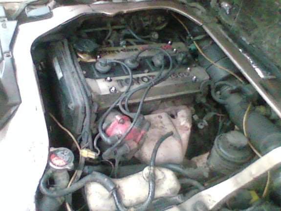

1 use the gze clutch and pressure plate on mine running w55 gearbox. you will have to clearance the bellhousing for the gze setup to work as you can see in this pic
