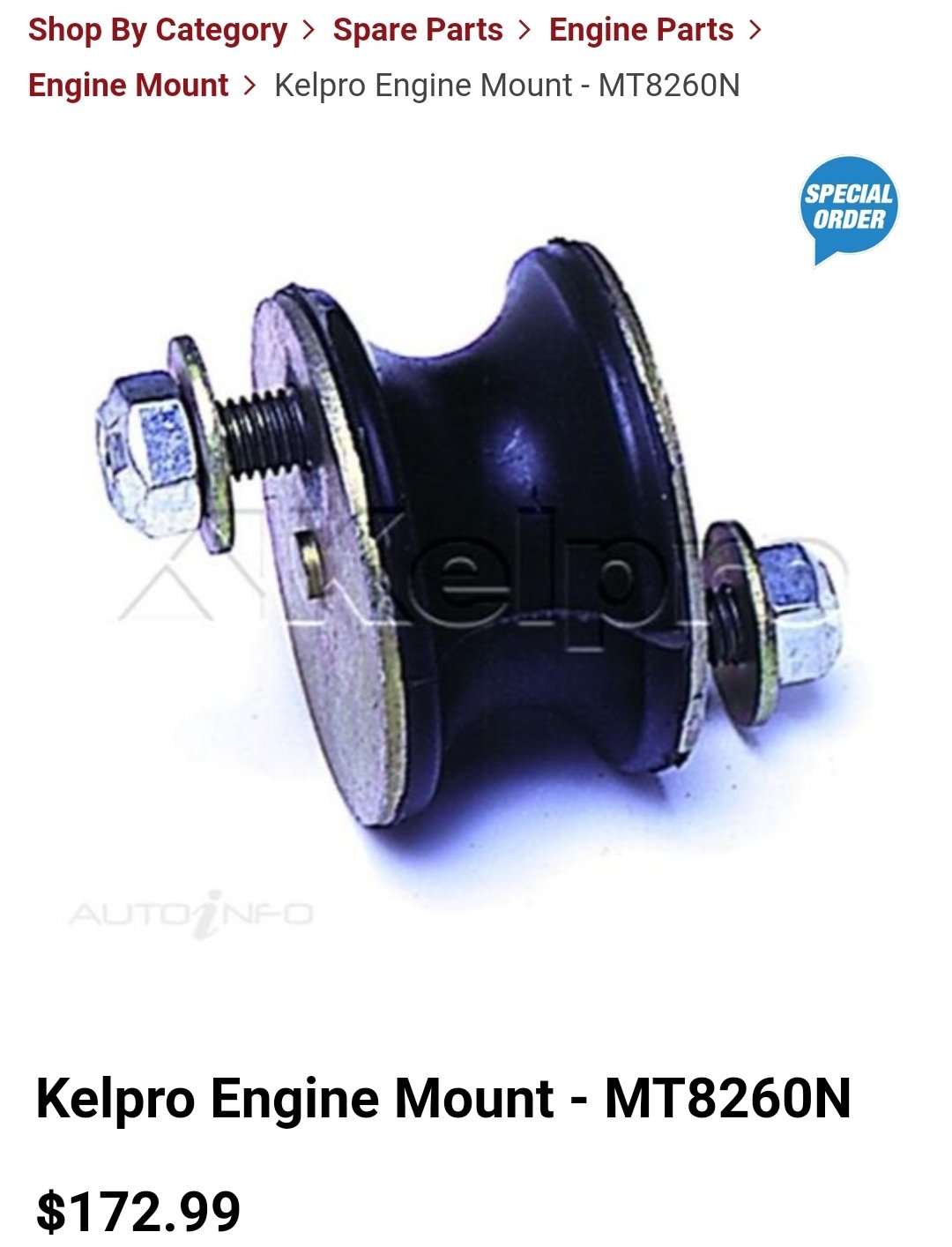

BlownCorona Posted July 12, 2021 Posted July 12, 2021 FYI there are such things as engine mounts with offset bolts that would make your current setup bolt in. when we put the sr20det in dads s11, we had i think 35mm difference between mount and crossmember, had a google and came up with a volvo mount that had the same offset and everything bolted in sweet with off the shelf parts. 1 Quote

Jeffs_Emporium Posted July 17, 2021 Posted July 17, 2021 On 13/07/2021 at 08:46, BlownCorona said: FYI there are such things as engine mounts with offset bolts that would make your current setup bolt in. when we put the sr20det in dads s11, we had i think 35mm difference between mount and crossmember, had a google and came up with a volvo mount that had the same offset and everything bolted in sweet with off the shelf parts. Found these vovlo kelpro ones listed on their catalog with a price of $172.99 each via supercheap It looks like they are too thick for my application and probably more cost effective to just make more engine mounts to utilize a normal rubber 1 Quote

BlownCorona Posted July 20, 2021 Posted July 20, 2021 On 18/07/2021 at 07:49, dspec_tt131 said: Found these vovlo kelpro ones listed on their catalog with a price of $172.99 each via supercheap It looks like they are too thick for my application and probably more cost effective to just make more engine mounts to utilize a normal rubber those are probably what we got, except we ordered from rock auto and they cost about $30 edit - they were volvo 240 2 1 Quote
