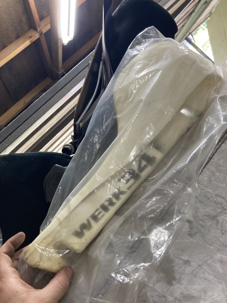

Might not be the thread for it but can someone tell me if the squabs on Recaro Fishnets individually replaceable?
A cheap set came up with ripped bits, but then another single came up with the other bits ripped.
If I can swap them it might be worth it...?
They come off so you can replace them with a separate squab from a different seat, you can also buy bolsters image.thumb.jpg.c773229edcac58bf65179960eb1254d4.jpg

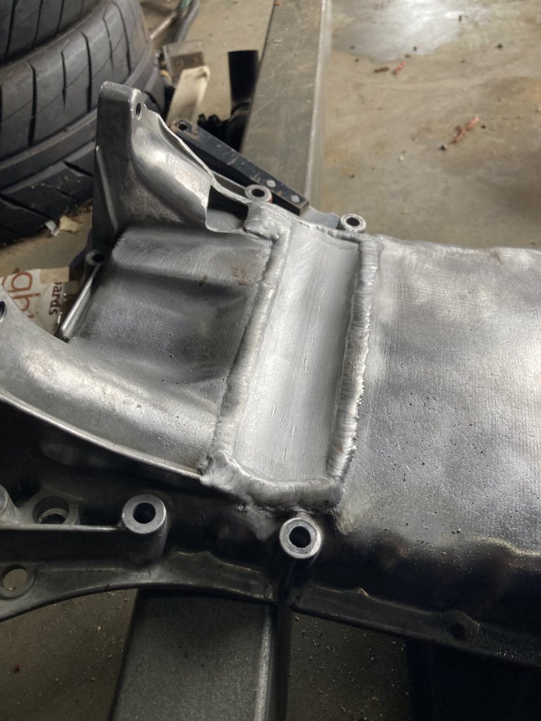

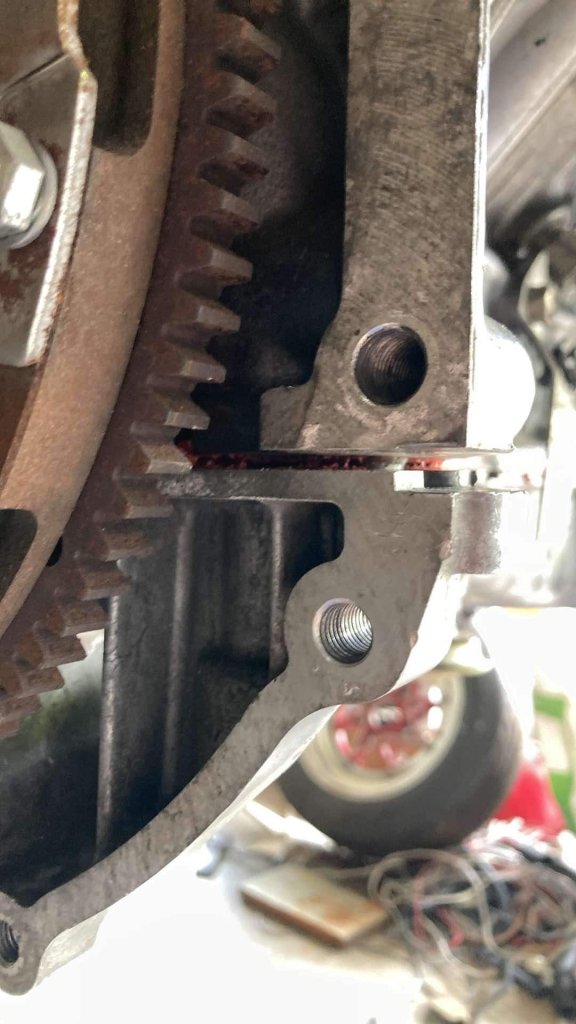

How fucked am I? Bin it or straighten it?IMG_3994.thumb.jpeg.f36a3c0962d846771db92effa6c5505b.jpegIMG_3995.thumb.jpeg.085bf790cd3038bfaf1ac26a796249be.jpeg
@Dudley   keeps all the tubes of red silicone in stock.
assume its warped because the welded part?  cut the welds on one side.  bolt to something flat and re-weld

Yeah it’s pulled when it shrunk after welding. We cut the weld on one side, bolted it to the engine with some steel rules between the welded area and the block and re-welded and it’s noice and straight
