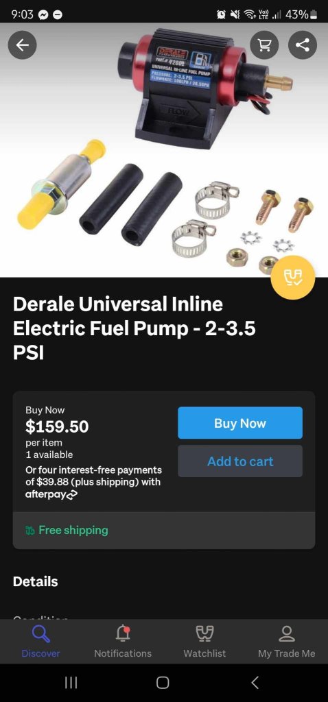

8 hours ago, ThePog said:
Can anyone recommend a low pressure regulated fuel pump?
I am getting low end overfuelling issues, I talked to Weber Specialists and he reckoned it had to be coming from high fuel pressure. He said DCNF's like 2.5psi.
So I bought a cheapy gauge and a shithouse reg off AliX, and all I could get was 4.5 to 5psi out of the facet type pump installed. I am guessing the reg needs a higher input pressure to work effectively, but it is kindof terrible so I thought it might be better to get something proper.
Any suggestions? Can you mod the facet for lower pressure by messing with the springs?
Fitted a Derale 2.5-3psi pump in a mates z24 Navara a couple years back as the elec pump someone else fitted was overfueling.
Can get them from CDL in Auckland.
