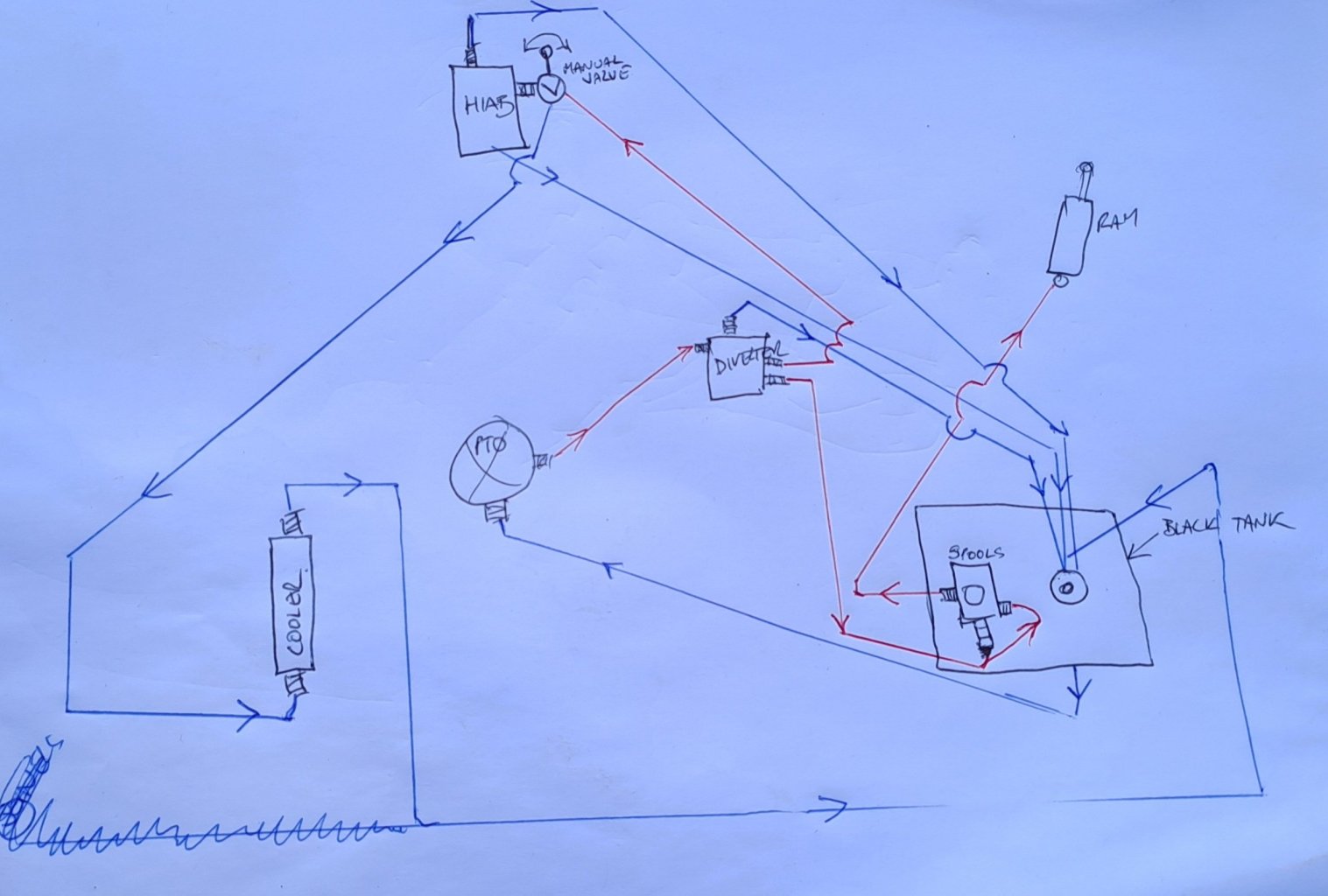

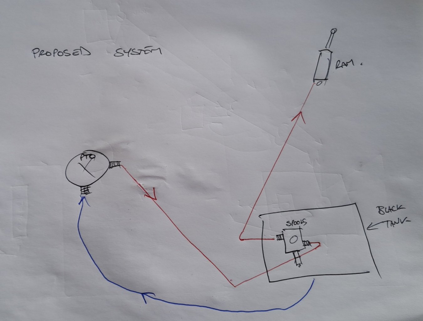

  7. Yes, the hose marked in yellow comes from the diverter. Deleting the four return hoses would give me a filling point, but I will need to have a filler hose as the deck would make it otherwise difficult to add fluid. Good point about the breather. I hadn't thought of that... but I can just drill a hole in whatever I cap the hose with. I need to get the clutch fixed, get a working hiab back in to lower the deck, and then drive the thing into the shed. I'll do that once all the bundy tube arrived (possibly Wednesday). EDIT: Perhaps there's a removable plate in the deck for topping up the hydraulic tank already. I will look on my next visit. My biggest hassle is the diesel gushing over the PTO and grass when I run the engine. It's a PITA and right where I need to work
  8. I'm guessing as the ram retracts it discharges fluid into the black tank via. the spools? If so perhaps I can delete excess failure points and get to this state. Unsure.

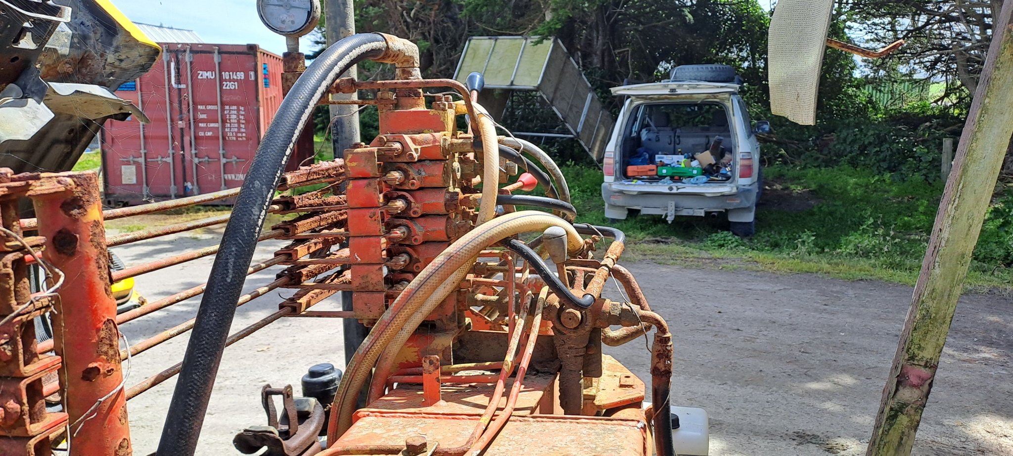

  10. Good morning everyone. The clean looking valve assembly seems to be hoist up and down control and lots of return lines into the black tank. The tank is a bit over half full The dirty looking valve assembly (inside the chassis) is a diverter that is fed directly from the PTO pressure line. Hoses from that diverter go to places. I'm not entirely sure where yet... but one of them goes to the Hiab Either the diverter or the PTO isn't working as I still can't lift the tray and have no apparent hydraulic pressure at the ram, but I didn't have the correct spanners to crack open the pressure hose from the PTO to the diverter yesterday. I'll try again this afternoon.

  12. Pretty sure (without being certain) the wrapped line marked P is a gravity fed line to fill the black tank from the Hiab tank. There's no other way to get the oil into that black tank. I'll get a photo from a better angle tomorrow

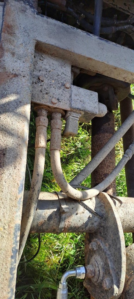

  13. Yes. Those bastards. They have wires! Guess they're hooked up to the diverter switchbox.... and now I am thinking just how handy a Hiab would be! LOL
  14. Did you see the 'things' on the inside of the chassis too? I think they are for the Hiab.
