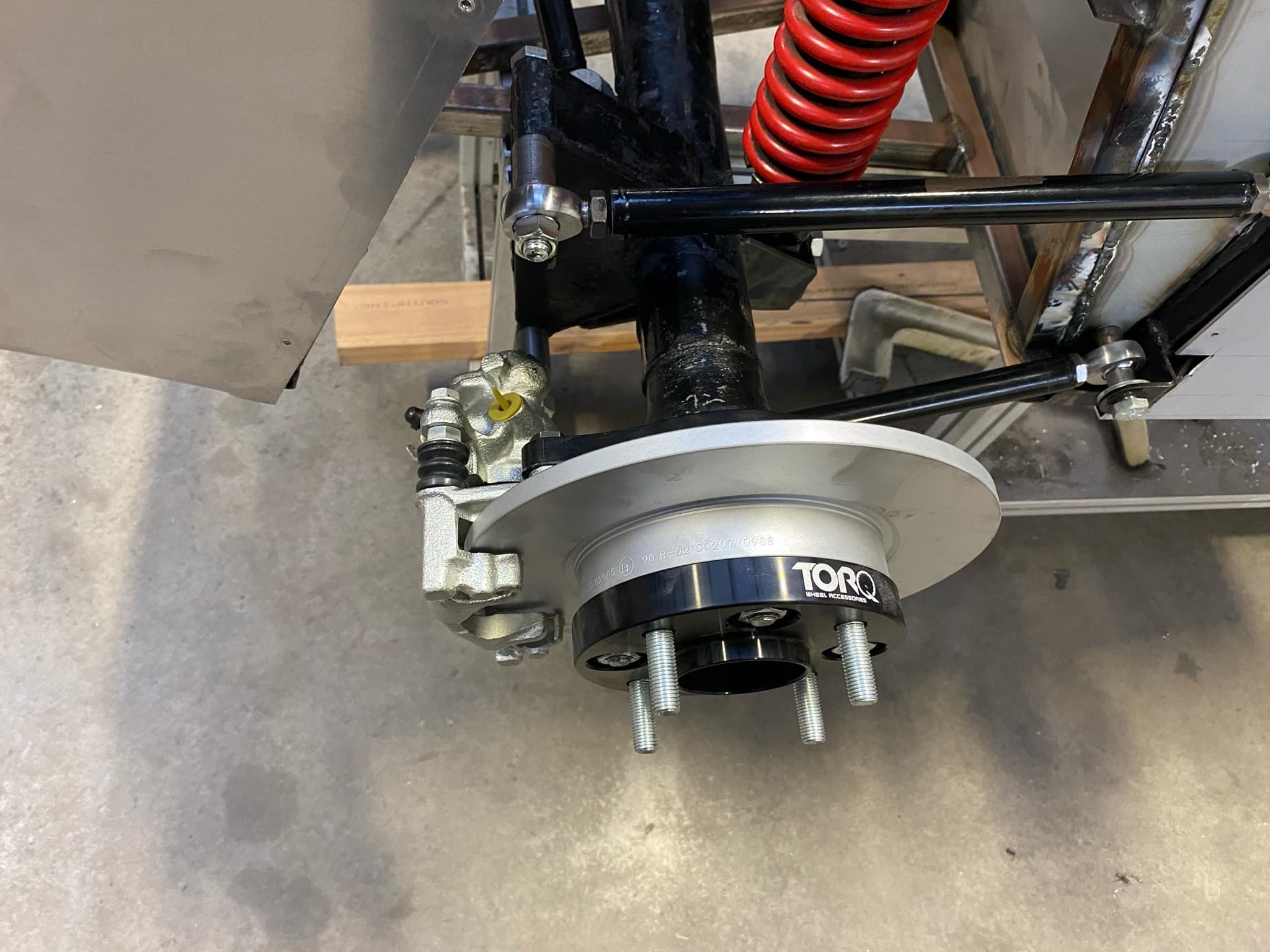

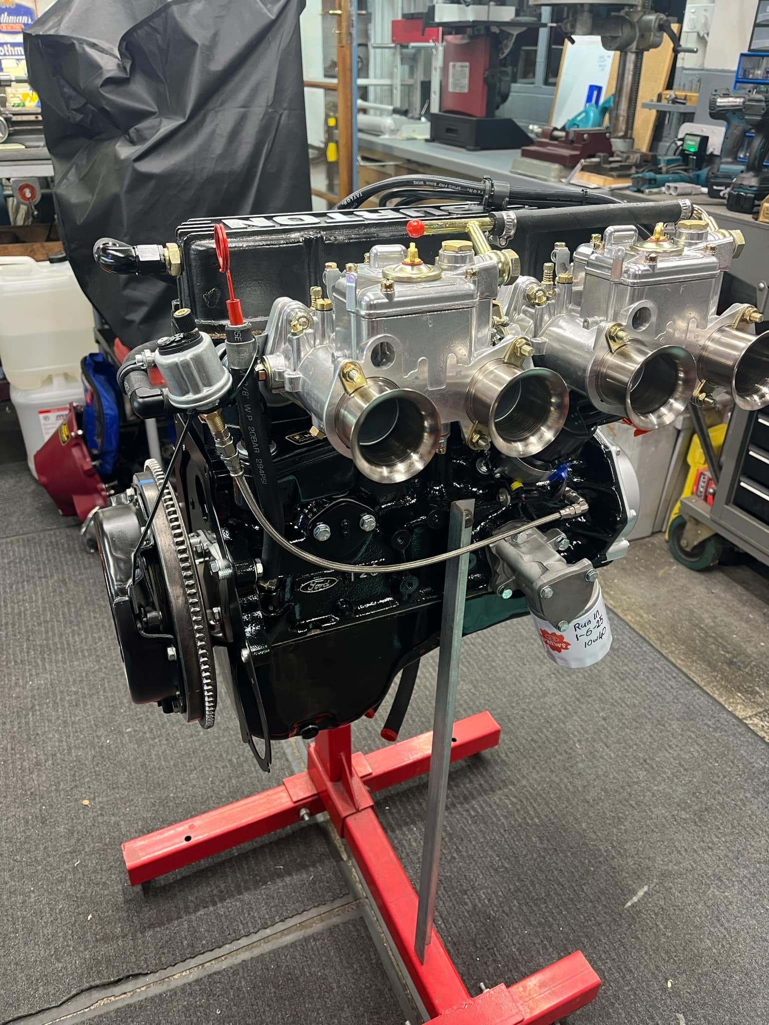

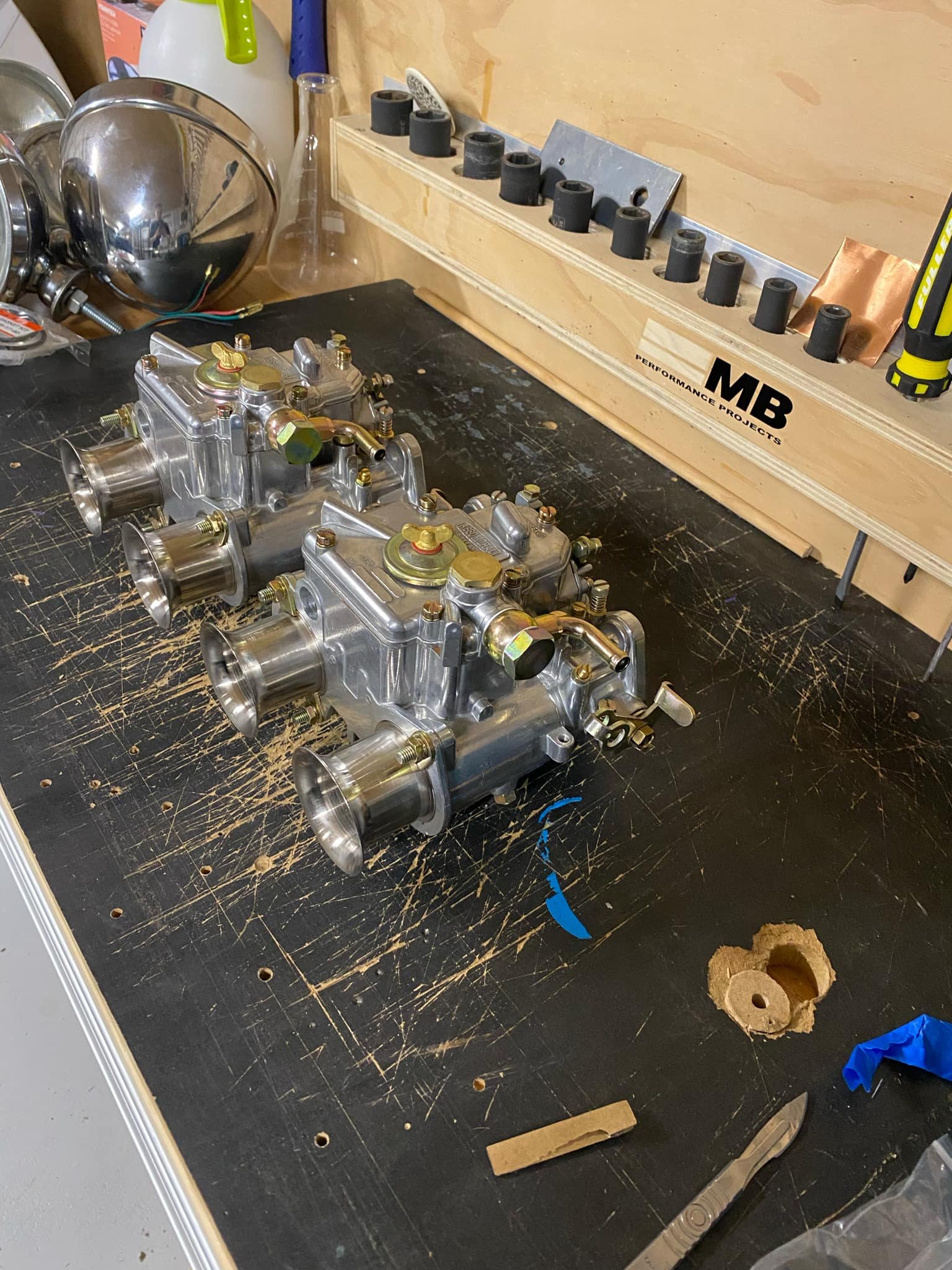

  1. Lots of progress made in the last few months. Have upgraded the front and rear brakes. Wilwood dynalite fronts and a disc conversion on the rear. To go with the added stopping abilities, the engine has had a birthday as well. Twin faux Weber 40’s, re ground cam (K276), double row timing chain, +040 pistons for a bit more compression. Looks the business If anyone wants to buy some Anglia bits let me know. Rear brake setup is complete with backing plates, drums shoes etc, and a pair of girling front calipers. Will also sell the Italian Weber 40 I have, has a crossflow manifold to go with it if desired.

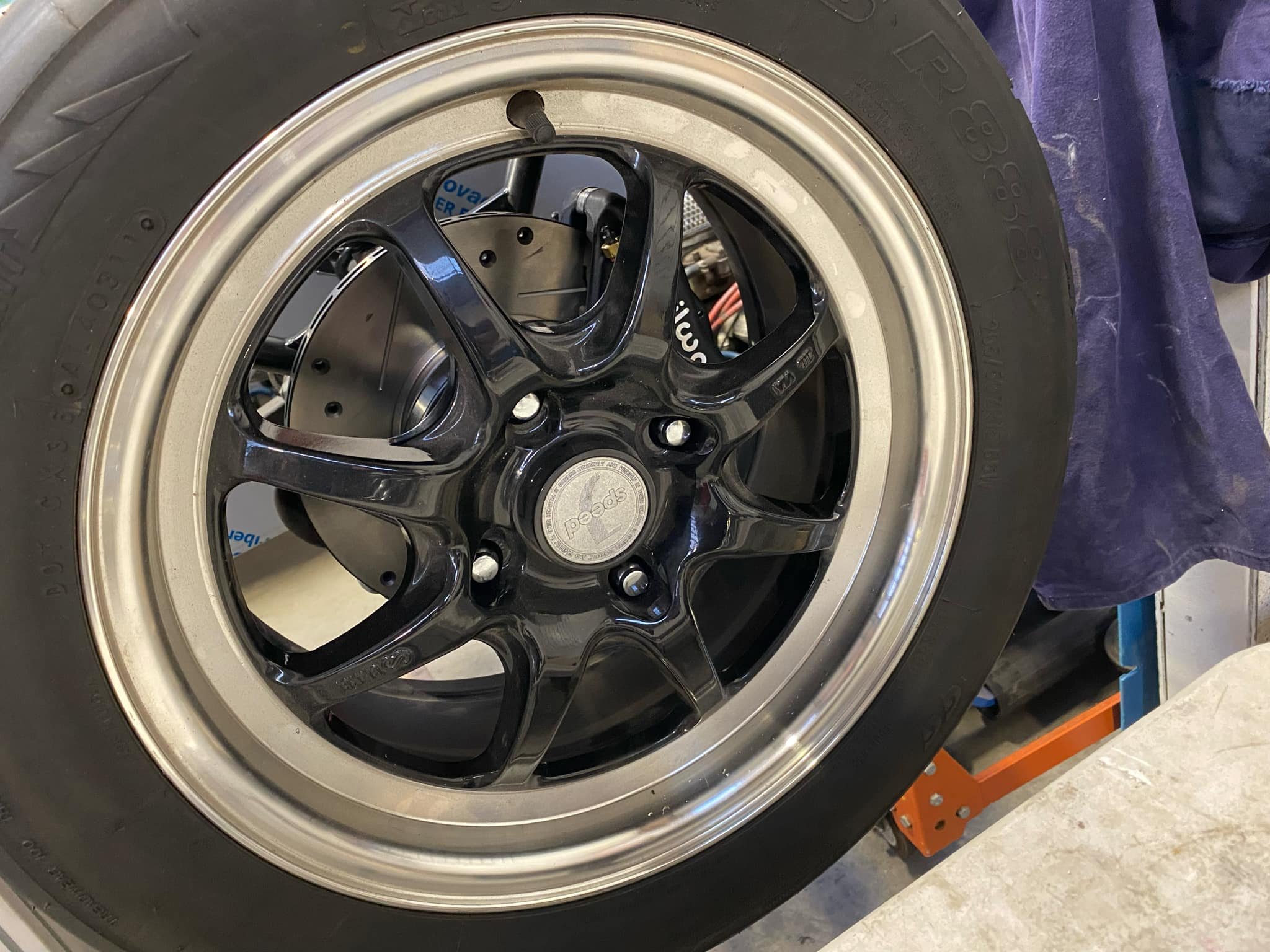

  4. Yearly update, but things are progressing well. I’ve had this thing for 14 years now and while I’m proud I got it running in its old guise, I’m really excited to see it become the car I always wanted it to be. Since the last update it’s had: - Diff drain/fill and breather repaired - Extractors - Moved to 15 inch wheels, looks pretty stout- enkei j speed with R888 tyres - New body panels, scuttle, bonnet Nearly time for paint, I’m thinking Honda championship white. Anyway, pics
