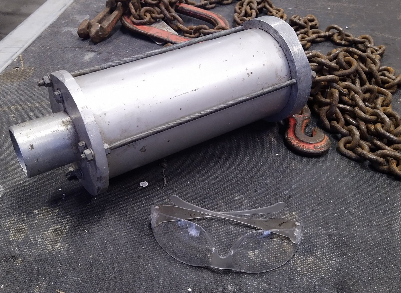

Popular Post ThePog Posted August 31, 2021 Popular Post Posted August 31, 2021 Me and a mate built this at Uni as part of the design stuff for a competition, we didn't actually win on the day due to the way the results were calculated but we went twice as far as any other entry and i think they still use it as an example... Â Â Firstly, this is how it works, the basic setup. The red is a bit of 5mm polyurethane, all else is aluminium; Â Then you pump air in which seals the barrel and fills the outer. Once it is pressurised you remove the pump, the valve actually has nothing in it so the removal acts as the trigger; Â When the valve is removed the pressure on the polyurethane seals the valve/inlet and all the air rushes out, pushing whatever is in the barrel with it. Â And as promised, a video of it in action and some fucking dodgy editing for lols. Â Â 30 4 Quote

ThePog Posted August 31, 2021 Posted August 31, 2021 1 hour ago, Yowzer said: I recall seeing that design years ago from a guy who built a few different PACs, as well as some other interesting stuff. Always wanted to make one but never did. Yea I think we culled the design from the internet, the size was a real constraint as it had to fit into a 300mm cube. And not blow up and damage us. 1 Quote
a.craw4d Posted August 31, 2021 Posted August 31, 2021 ^very similar to how a nail gun works. Thanks for sharing. "We won't all now build illegal firearms" 3 Quote
Valiant Posted August 31, 2021 Posted August 31, 2021 1 hour ago, ThePog said:  the size was a real constraint as it had to fit into a 300mm cube. Hence the short barrel? Quote
ThePog Posted August 31, 2021 Posted August 31, 2021 26 minutes ago, Valiant said: Hence the short barrel? That's it. Quote

flyingbrick Posted September 2, 2021 Posted September 2, 2021 On 31/08/2021 at 18:10, ThePog said: Me and a mate built this at Uni as part of the design stuff for a competition, we didn't actually win on the day due to the way the results were calculated but we went twice as far as any other entry and i think they still use it as an example... Â Â Firstly, this is how it works, the basic setup. The red is a bit of 5mm polyurethane, all else is aluminium; Â Then you pump air in which seals the barrel and fills the outer. Once it is pressurised you remove the pump, the valve actually has nothing in it so the removal acts as the trigger; Â When the valve is removed the pressure on the polyurethane seals the valve/inlet and all the air rushes out, pushing whatever is in the barrel with it. Â And as promised, a video of it in action and some fucking dodgy editing for lols. Â Â I require pics of golf balls being fired through various materials plz. Car doors be good 6 Quote
ThePog Posted September 2, 2021 Posted September 2, 2021 9 minutes ago, flyingbrick said: I require pics of golf balls being fired through various materials plz. Car doors be good I have run out of balls 1 3 Quote
