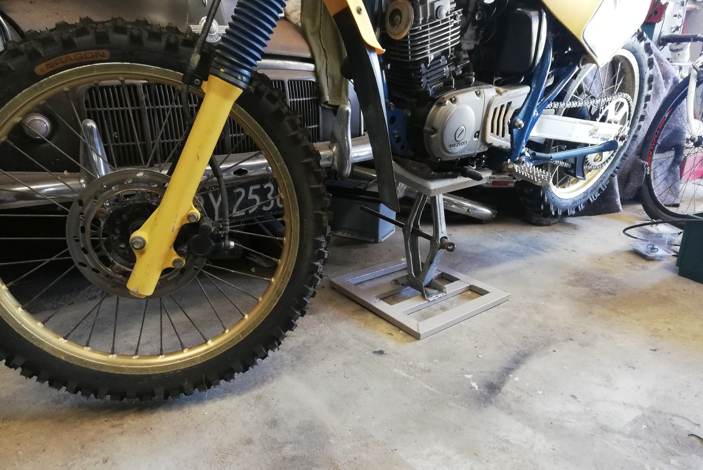

Kimjon Posted February 21, 2021 Posted February 21, 2021 2 hours ago, tortron said: That's cool!! How stable is it? Quote
crash Posted February 21, 2021 Posted February 21, 2021 Noice and simple. weld big nut on end, battery drill/driver, max revs, quick smart. 1 Quote
tortron Posted February 21, 2021 Posted February 21, 2021 Il probably weld the top part (can spin it around which is funny, but gives it a little more play and not really needed). Otherwise its ok when the bike is jacked up in the right spot. i jacked it right off the ground and walked around in the shed for a while and it didnt fall off, most stable when the front wheel is on the ground and taking a bit of weight The gears of the jack naturally have a couple mm play in them 1 1 Quote
tortron Posted February 21, 2021 Posted February 21, 2021 2 minutes ago, crash said: Noice and simple. weld big nut on end, battery drill/driver, max revs, quick smart. i dont do that because im not gona wait around while my drill charges every time lol. could use a ratchet but a screw driver through the hole is how i usually do it Quote
Popular Post cletus Posted February 21, 2021 Popular Post Posted February 21, 2021 Weld a morris crank handle on for a familiar way of doing it? 9 2 Quote
tortron Posted February 21, 2021 Posted February 21, 2021 6 minutes ago, cletus said: Weld a morris crank handle on for a familiar way of doing it? My other scissor jack has a slotted end on it to accept a morris crank handle 3 Quote
CUL8R Posted February 22, 2021 Posted February 22, 2021 Protip - If you use a VT-VZ commodore they have a 19mm Hex, you can then use your impact gun on... 5 Quote
