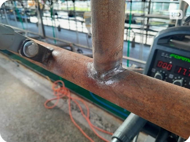

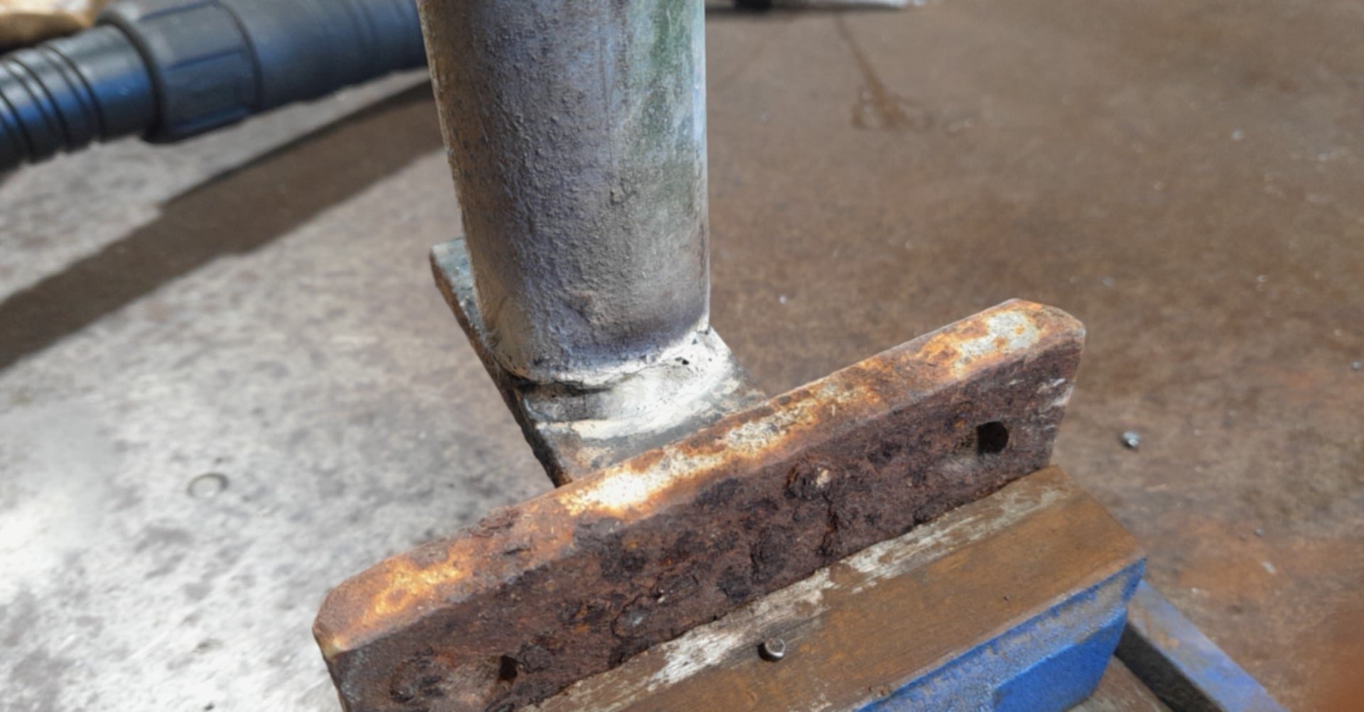

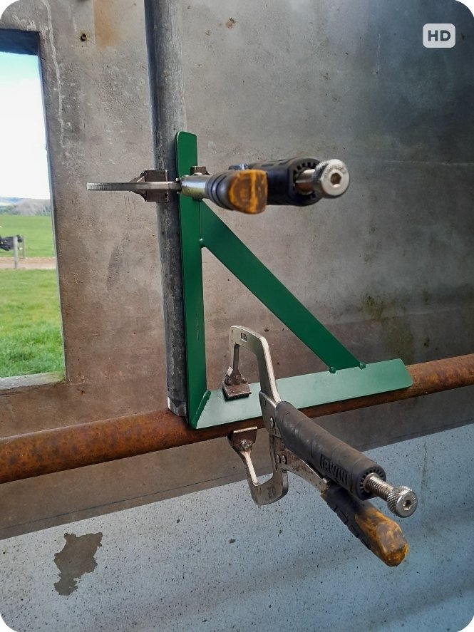

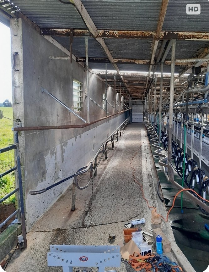

As above, brought Shilohs old mig as a gasless only machine. As most people I had only had bad experiences with gasless migs and then applied that opinion to all gasless options. Worked for a place that had a goat farm so welding no prep galv pipe all day and saw how good gasless machine could be for certain jobs. Insert the dairy shed special; -Boc Raptor 160a with all gas parts removed. -Knurled roller -0.9mm ESAB Coreshield 15 gasless mig wire 5kg Is a great combination. Its not for everyone, its not cheap but it serves a purpose that is painful and is cost effective for what it can do. 10 amp so it can run off poor dairy shed wiring and 30m of extension leads. The key for why you would use gasless for dairy work is that all your work is on galvanised pipe under 5mm so you dont need the grunt and because you dont have a gas, the flames/smoke that comes off the galv cant affect the gas if there is none. Basically all your issues you have when welding no prep galv with gas such as green flames, random popping throwing zinc everywhere including down inside overalls, holes in your weld are to do with using gas. Ive always used arc for everything mobile but it can be a pain if your only doing thin work and isnt that fast at all. Here is a job I did this week, breast rail for dairy cows which sits over the top of their shoulders to prevent the new milkers trying to jump out over the top of the rail in front of them. Vertical bars are the pieces cut out of the old dairy shed which was replaced in 2011. Horiziontal bar is the old bore pipe. Minimal prep on the galv, none on the bore pipe welding up. Also a jig I made up for doing fast 90 degree pipe connections. @RXFORD will be happy to see his neighbours clamps still going hard. Works really well for keeping the 2 pipes in the same plane and 90 degrees. And some rawdog testing setting it up. No cleaning, both 2nd hand pieces of material pulled out of the long grass/ground. Not bad penetration.

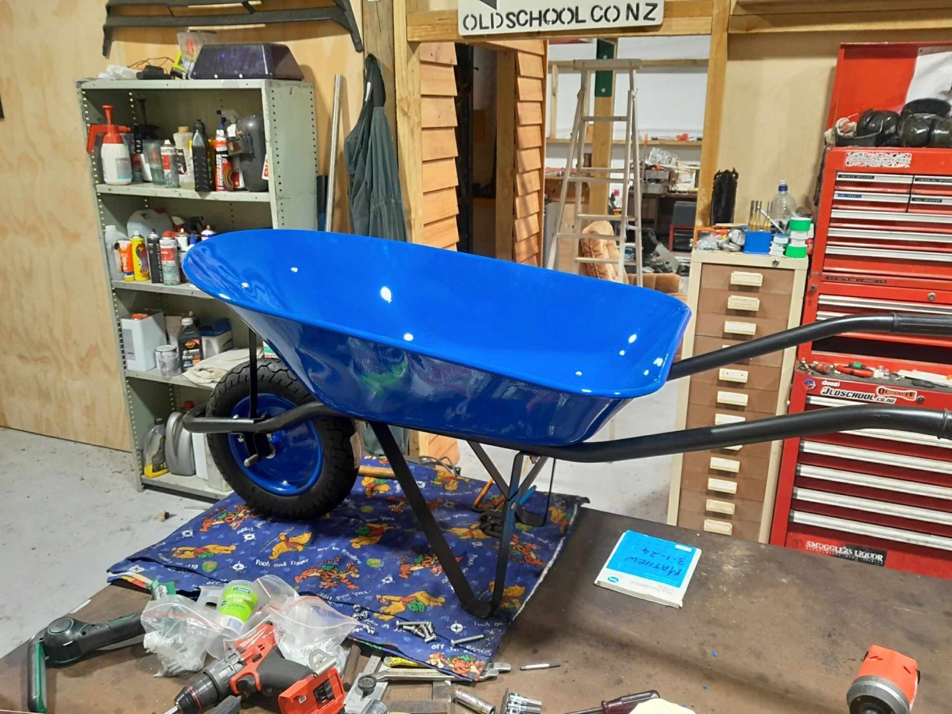

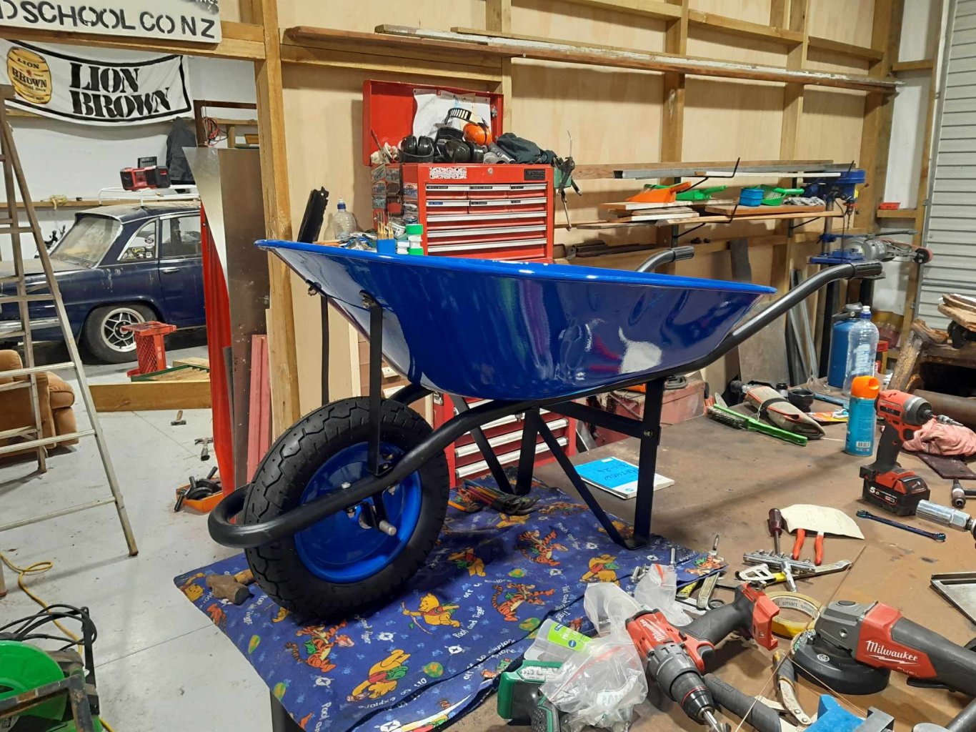

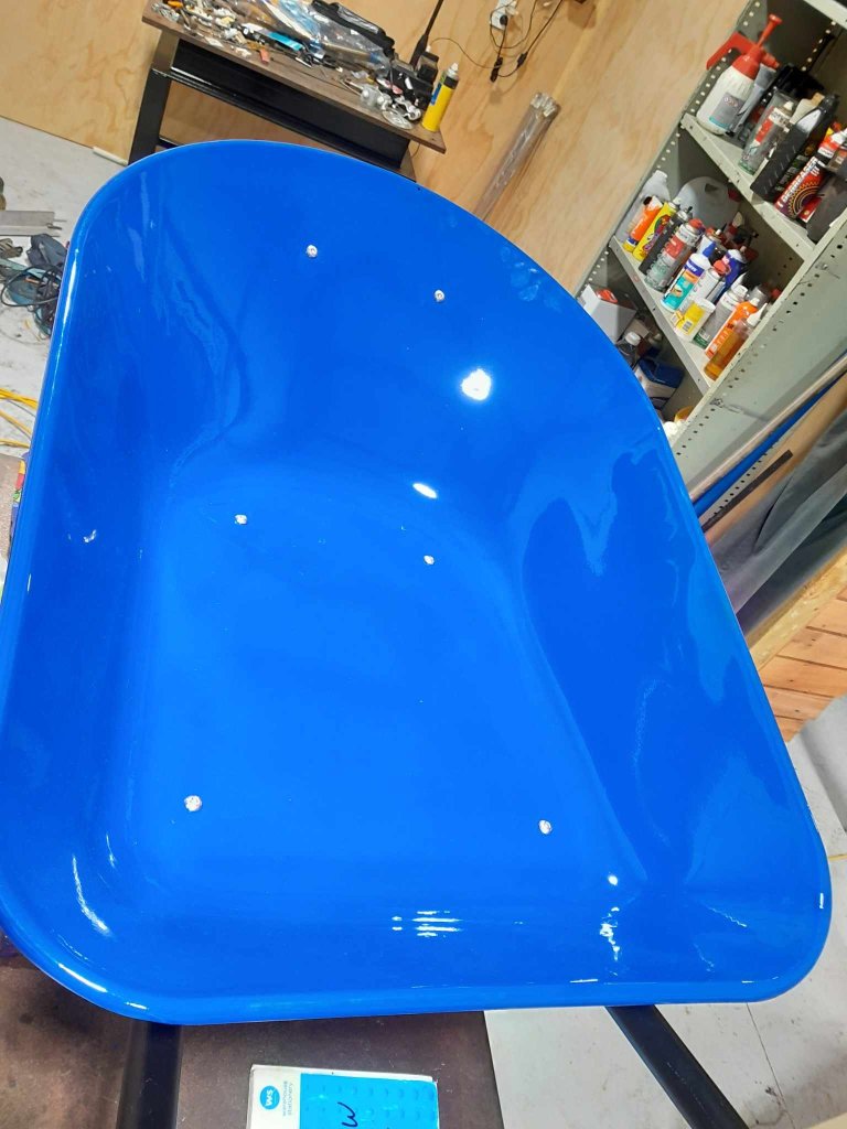

My grandads wheelbarrow. Was a man that did everything by hand on a hilly property with the wheelbarrow. Had mixed up many cubes of concrete until he got too soft at 87 then he brought a concrete mixer. Was a little worse for wear and tyre was toast so disassembled for a blast and paint down the line, factory colour tub and frame in chassis black. Spent $10 more then a garbage tyre from M10 on a 3.00x8 Shinko scooter tyre, was a bitch to get on but now have a tyre even when flat that has a stiff enough carcass to be pushed around. Good for 100kg at over 80kph so good enough for home. Button head stainless cap screws because im shallow and like stuff like that Is going down to my sister in Gisborne so good to see it get another life. -
