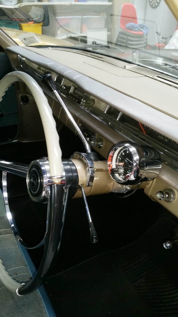

Popular Post Kimjon Posted October 12, 2019 Popular Post Posted October 12, 2019 Had excessive play in my steering column. Stripped it down and there really wasn't anything worn or actually wrong as such. Some parts still had paint under the grease...so it wasn't flogged out. I think the factory clearances are just very sloppy and because it's a shaft, within a tube, within another housing - that equals compounding errors x3 that all add up to felt play at the steering wheel. I pondered this for a while, wondering how I was going to keep my certifier happy and tick this box? Then came up with a solution. I turned up this bushing on the lathe from stainless and then press fit (plus epoxied) a nylon insert. The actual steering shaft within the gear selector tube can now run on this to remove any minor bearing movement there was before. The ractory fit bearing is still in there too, should this ever wear out...though my 20 year old ride on mower uses these bushes on the steering shaft and no supporting bearings at all and it hasn't worn out yet. Then I made a jig up to hold the gear selector boss in the lathe. I took a few cuts off the tip only (the keyed shaft inside runs full length) and then turned up a shim to add more material back on than what I started with. I press fitted these parts together using loctite just to make sure it stays together. This shim ring perfectly centres the gear selector inside the main steering column housing. A liberal coating of grease and I put it all back together. This part only moves about 60° from Park to 1st on the colum change, so it's not going to wear out this century. Its rock solid now, zero unwated movement, better than the factory ever made it... 19 Quote
