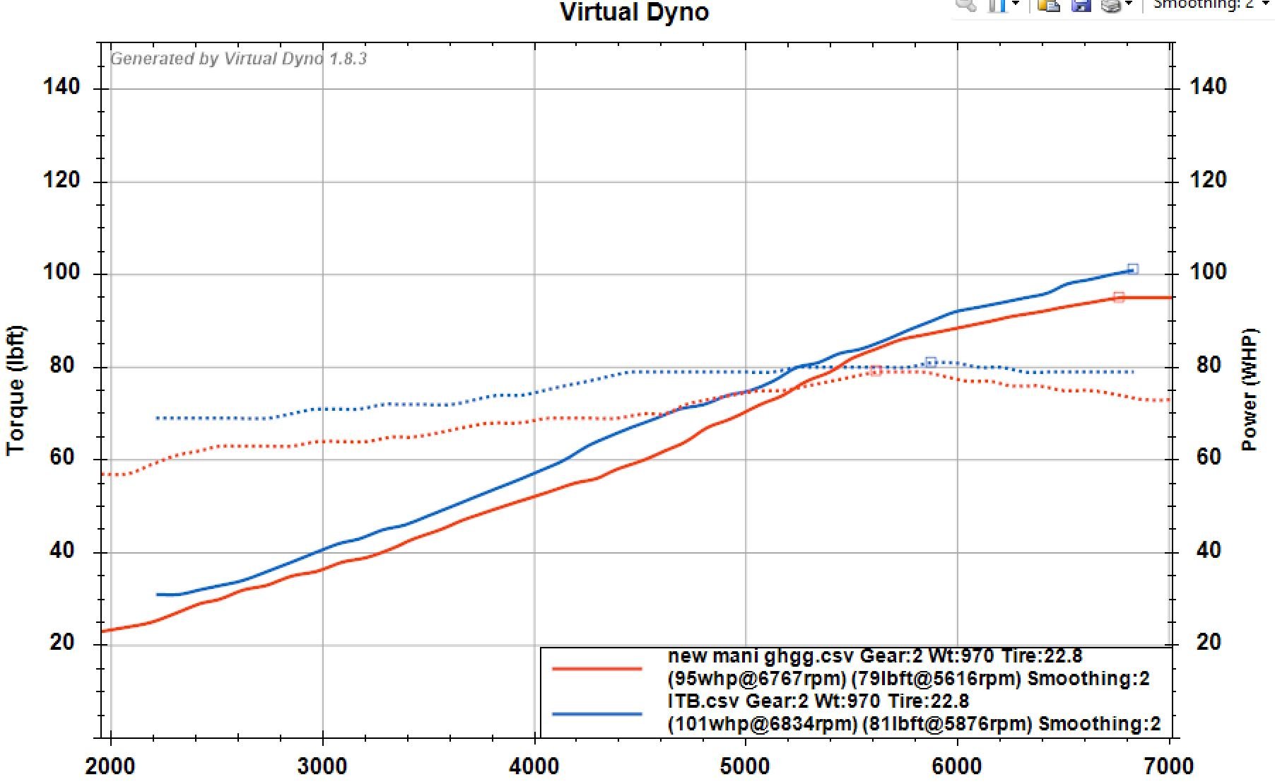

Roman Posted November 3, 2020 Author Posted November 3, 2020 Interesting results from the manifold swap. The fuel map didnt change one single bit! Like not for better for worse anywhere. Less than 1% which is margin of error. Which is interesting especially as I'd adjusted cam angle too. That aside, on virtual dyno it looks to have done nothing good at all: (red line is new mani) This reminds me that I havent adjusted to suit increased vehicle weight from new wheels, and the low pressures might be hurting the amount of power that makes it to the ground. Not that it's any good making power at the motor if it doesnt reach the road. I'll tidy up the entrance to the original manifold too, and then try do some A-B tests on the same day/weather/wheels/etc. I'll feel a bit better about this if it's a zero power change rather than a loss. It might be a case where backpressure is so high that a different manifold cant help as much as it would otherwise. But this also might be an interesting indication of something else too - maybe power loss from different wheels and tyres. I'm skeptical of that much of a power drop at the engine without it running any richer or any other indication in the ECU. If there's a few HP worth of a drop in power from soggy tyre pressure I'll have to weigh up whether a slightly better launch is worth losing some speed down the rest of the quarter. Slow gutless car has its own set of challenges haha. Also, I managed to get the front Bilstein springs too so I've got the full set now. Will hopefully be able to swap them over tomorrow. 7 Quote
Popular Post Roman Posted November 3, 2020 Author Popular Post Posted November 3, 2020 New comparison to that same older test but with tyres at 40psi all round again. Looks like that might have been the difference This is 30psi front from yesterday vs 40psi from today. Pretty amazing difference  EDIT: And Bilstein springs in. ride height hasnt changed toooo much but it's much nicer to drive. Some better shocks would help a whole bunch too, I'm sure. Might help keep a bit more weight over the front off the line. 12 Quote
