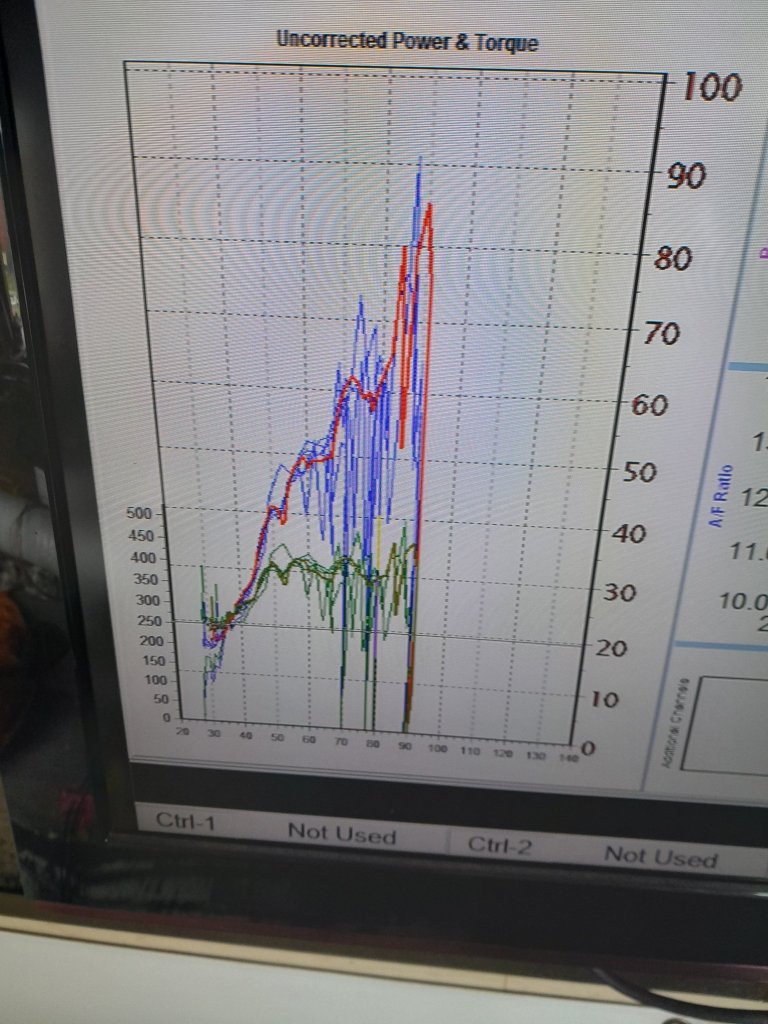

kpr Posted March 28, 2025 Posted March 28, 2025 1 hour ago, Dudley said: Makes pretty good power with the speeduindo ecu you mean this one 1 1 3 Quote
