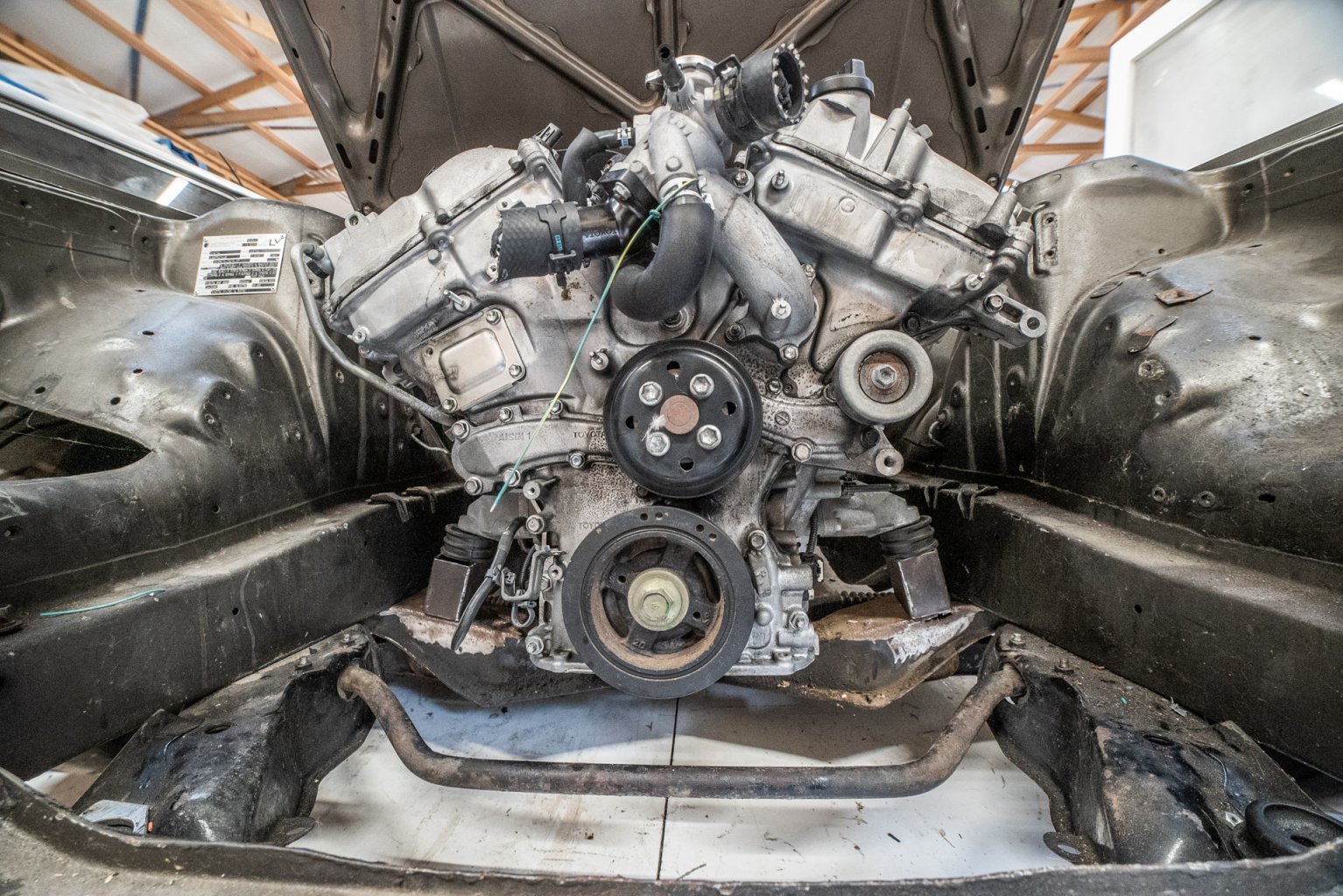

Roman Posted February 16, 2023 Author Posted February 16, 2023 5 hours ago, GARDRB said: If I can fit a 1uz in a corolla without modifying the firewall or ditching the swaybar, you can make this work. Rear sump is the current headache. The sump cant get past the steering column. So, I dropped the rack down. Cant get past engine mounts. so chopped those off. Cant sit far enough back so chopped part of the firewall so one of the banks could sit further back. The bellhousing hits the tunnel before the motor is far enough back to drop down past the steering rack. Even when I dropped the crossmember and rack, I still cant get it to fit. " I tried the Hyperblade trick of flipping the crossmember around, but the bolts for the crossmember arent on the centreline of the lower arms, so it doesnt work. It might work if I chop some of the tunnel out, where it's hitting the gearbox. But its not going to be an easy motor to get in and out. If I do persist with chopping more stuff out, it does look like it will sit fairly decently low and fair back though. Good room for intake activites. Exhaust manifolds should have plenty of room, dont think the steering column will make life too difficult. But that's enough for one day. Quote

VitesseEFI Posted February 16, 2023 Posted February 16, 2023 Ah…. Challenges. Big challenges. Old fashioned pushrod V6s and V8s are amazingly compact. Modern DOHC multi-valve ones though are mostly very bulky at the top-end. Winged sumps are a PITA….. Quote
shrike Posted February 16, 2023 Posted February 16, 2023 You can also look to go remote oil filter, probably worth adding an oil cooler as well. Is the oil filter built into the sump? Front/custom sump maybe the way to go. Could you 3d print a sump and then get sheet metal etc to weld one up? https://www.ebay.com/itm/325352398654 is this one different from yours? Actually how different is the bolt pattern on the sump if you wanted to run it backwards, (could always modify the pickup) Modify or use and adapter to run the sump as a front instead of a rear? Quote

GARDRB Posted February 16, 2023 Posted February 16, 2023 55 minutes ago, Roman said: So will make some engine mounts, get it in the right place then start drawing up a sump. What filament are you gonna print the sump with? Carbon moooshed overtop of it? Quote
GARDRB Posted February 16, 2023 Posted February 16, 2023 2 hours ago, shrike said: You can also look to go remote oil filter, probably worth adding an oil cooler as well. Is the oil filter built into the sump? Front/custom sump maybe the way to go. Could you 3d print a sump and then get sheet metal etc to weld one up? https://www.ebay.com/itm/325352398654 is this one different from yours? Actually how different is the bolt pattern on the sump if you wanted to run it backwards, (could always modify the pickup) Modify or use and adapter to run the sump as a front instead of a rear? I feel like they fucked up with that ebay listing, that sump looks identical to Dave's one. I've been toying with making an adapter for my 1uz to run one of these SR20 pans https://www.trademe.co.nz/a/motors/car-parts-accessories/performance/other/listing/3995918987 Quote

shrike Posted February 16, 2023 Posted February 16, 2023 18 minutes ago, GARDRB said: What filament are you gonna print the sump with? Carbon moooshed overtop of it? Yeah think the ebay listing is wrong. Also don't BMW use plastic sumps Quote
Spencer Posted February 16, 2023 Posted February 16, 2023 Man pretty decent sized donk these things. The big boy 3500 with throttles and 300+hp would be pretty sweet NA if you want more beans later. Anyway I don't know shit about them but went briefly looking, this dude jammed one into a mx83 which in the scheme of things is similar to the Carina. His IS350 engine looks to have a real deal front sump but I could not find the corresponding front sump in parts diagrams and gave up. Can probably dig it up and buy one new the mid sump one on Amayama is like $300 for the alloy part. https://cressidaforums.forumotion.com/t380-2gr-fse-into-mx83-swap-thread Quote
Spencer Posted February 16, 2023 Posted February 16, 2023 OK he says in that thread somewhere the front sump is FWD, seems like theres a couple FWD sumps one is front and one kinda blobs into the middle. Anyway find the sump he has. Quote
Roman Posted February 17, 2023 Author Posted February 17, 2023 Yeah the difference though is that a 4GR is a $650 engine and a 2GR is a $4000 engine as best I can tell. I've got a scheme for the sump. Should be sweet. Quote

Spencer Posted February 17, 2023 Posted February 17, 2023 Whats the sump plan secret guy? alloy sumps with bracing make sump changes annoying compared to the old tin sump cut and shut stuff. Quote
