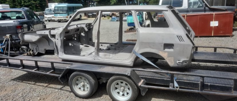

@Nominal thanks, will go for a nosy when im on break. @cletus yea rusty Subaru thoughts are right, the more we get into it the worse it gets, there was a wrecked wrx in the shop and the boys said be less work to effectively put the top part of the Leone on the bottom part of a WRX than fix the rust... which lead to a conversation... which lead to bad ideas over beers and now I'm here contemplating life and probably poor decisions (made doubly worse by being addicted to rusty Subarus)
This question is one probably better suited for Facebook as an anonymous post.... Is it possible to body swap on a monocoque chassis and be legal in NZ? Understand there is a fair bit of structural pitfalls there, would adding a roll cage and jumping thru those hoops make it work/easier?
