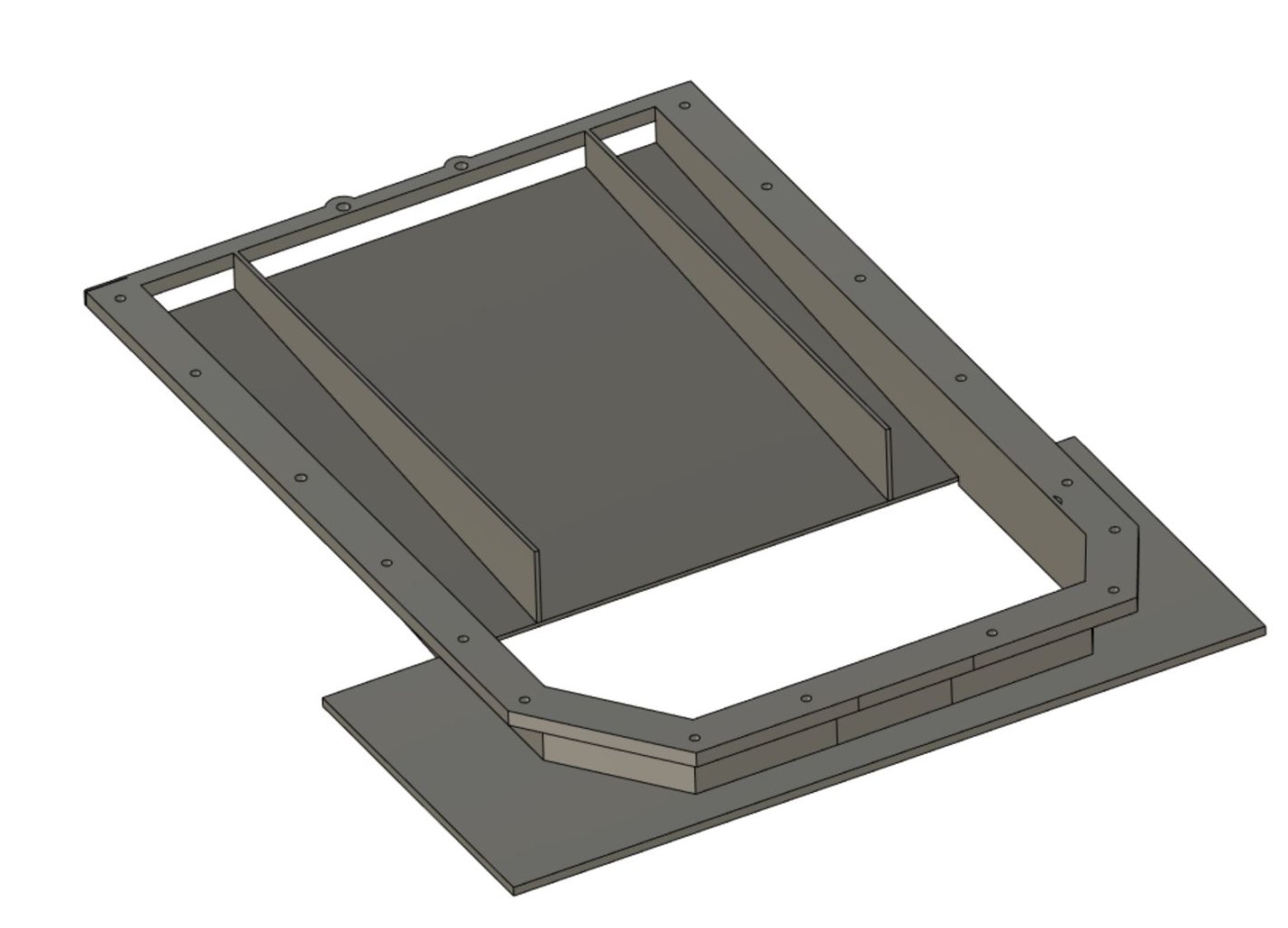

ajg193 Posted February 18, 2023 Posted February 18, 2023 I feel like your sump idea is over thinking it. Just get a machinist or use a die grinder to lop the sides of those drain holes out so the oil can flow sideways into the sump. Quote

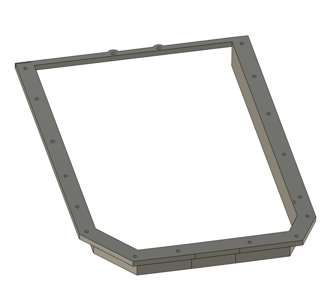

Roman Posted February 18, 2023 Author Posted February 18, 2023 The front sump might be good, but likely too deep for how low I'd like to sit the engine. Also, I cant find one anywhere. That one above isnt necessarily any less complex, how do the bolts do up that are located above the oil pan? on left and right sides. Must have a tube that goes all the way through and uses a long bolt from underneath. As they cant do up anything with the pan off, because the pan bolts are on the top. hah. @ajg193 The oil drain back channels are a "may as well" thing, secondary to being able to get some straight walls on the sides of the sump. It's not actually all that complicated, will seem a lot simpler when I've put a cad model together and you can see better what I'm thinking. Quote
Roman Posted February 18, 2023 Author Posted February 18, 2023 First plate that bolts to the motor looks sorta like this (get router to do the complex bits) Then the second plate has simple walls, only 6 flat sides and all of the oil drains are inside. Quote
scott90 Posted February 19, 2023 Posted February 19, 2023 would you o-ring between the sump and custom the adaptor plate? or say just a groove so you can put a bead of sealant in there? Quote
Roman Posted February 19, 2023 Author Posted February 19, 2023 Yeah will do it how the factory pans do, will just cut a groove then use sealant. Will have o-rings on the interface to the oil filter in/out lines. (again as per factory fit) Quote
yetchh Posted February 19, 2023 Posted February 19, 2023 12 minutes ago, Roman said: Yeah will do it how the factory pans do, will just cut a groove then use sealant. Will have o-rings on the interface to the oil filter in/out lines. (again as per factory fit) Do you reckon you'll be compromising the strength offered by the factory upper sump by removing it, especially if your planning on revving to 10k? Unless you have some strengthening in mind.. I took a look at the sump on my 2wd 1gr hilux and it has the sump way forward, like 100mm past the timing cover, and it's 6ltr capacity. They also have the same bolt pattern as the 4gr. Quote
