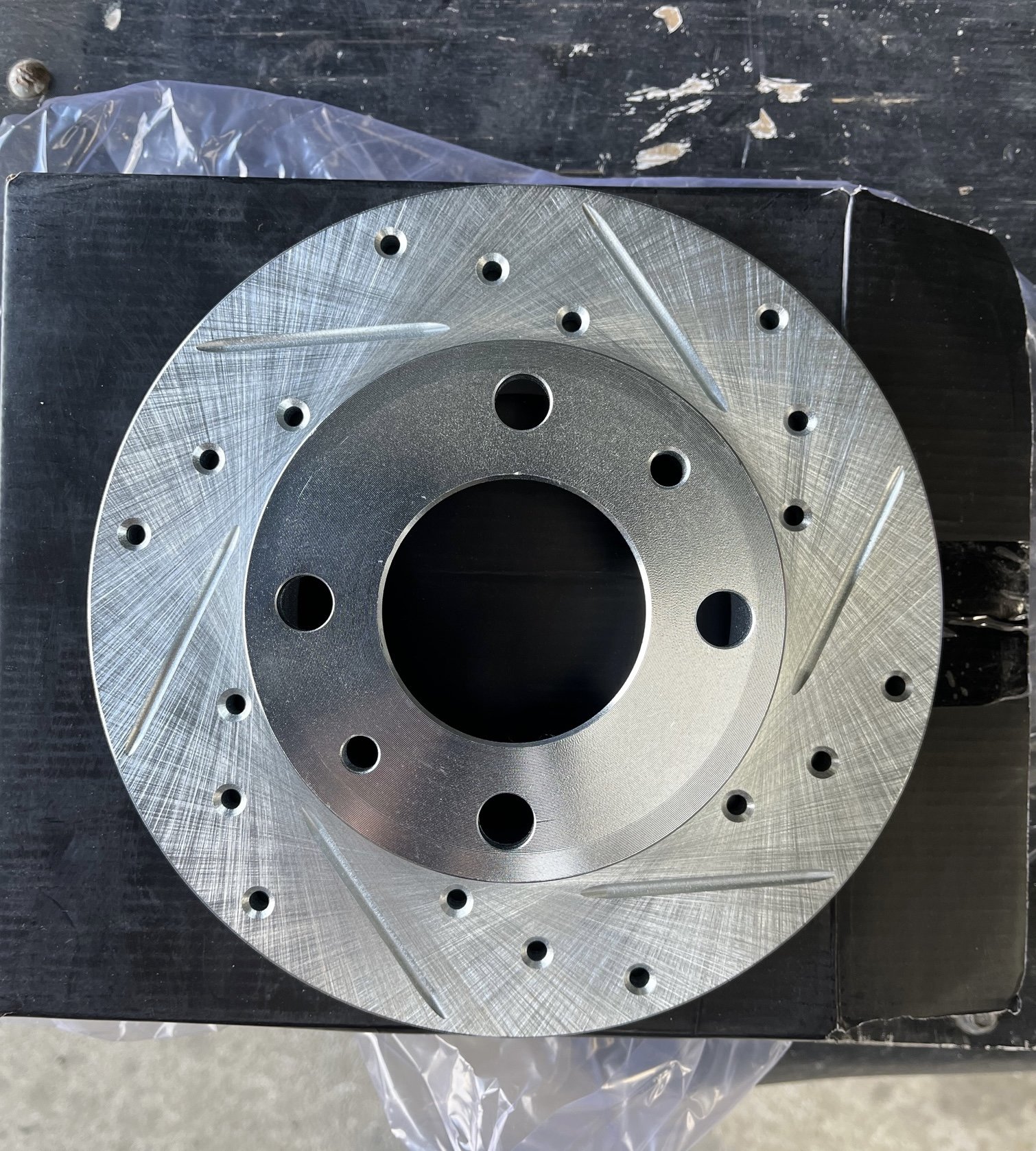

  1. Rock Auto continues to deliver the goods. How’s these for $50 a pop? Filed for future use.

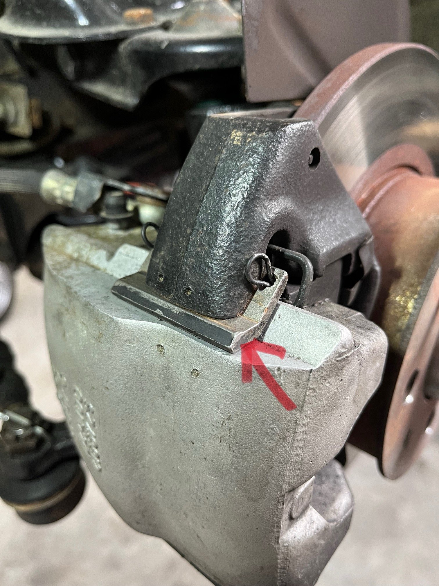

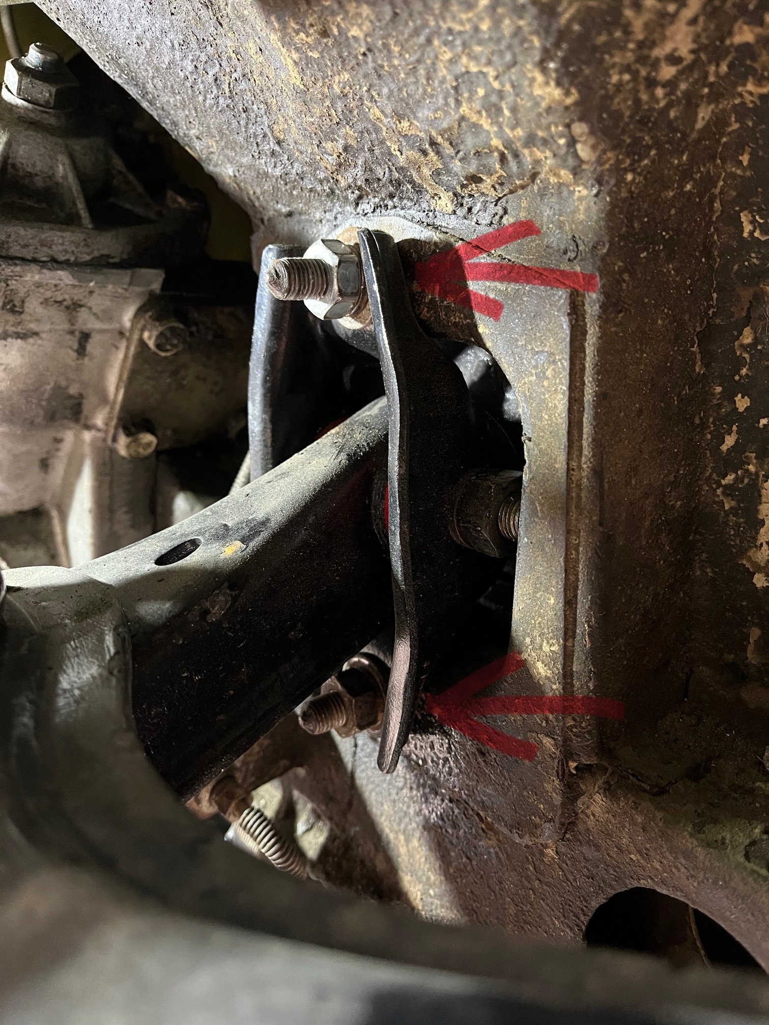

  4. Been pulling to one side under braking and a lot of brake dust appearing on the right front wheel so I pulled the calipers to clean these wedgy things. those are what pass for a caliper slide on these old things. I had made the mistake of lightly greasing them when fitting them up 2 years ago and thus there was all sorts of crud glued in there. The Fiat Barries assure me they should be clean and DRY. Next, I wanted to adjust the front camber. The old factory data has the tech dial in a smidge of positive camber. That’s well and good for 175 R13s from half a century ago with bus spec ride height. Mine’s lowered to a well laden height and fully laden camber spec is a smidge negative. So I pulled some shims and my rig and trig tells me I’m now about 0.5 degrees negative camber. Eldest passed her full license test so I told her she was now allowed to drive the Fiat under supervision. She was fizzing hard.

  17. Apparently my heater core can’t be safely opened due to its construction. I’ll have to take the guy’s word for it. So I did a no-no and filled it with CLR, let it sit for 5 minutes (how much damage can you do to copper in 5 minutes?) and then flushed it back and forth many times with the hose until no more rusty coloured poop came out. It’s flowing way more easily through the core now. Then I did some dishes- that’s the fan housing with the fan motor removed. Cleaned the fan of 52 years of dust and filth and set to reassembling the heater box with new a new tap installed. The tap I took out was plastic and munted. The replacement is metal, probably Eastern European. Shiny new hose as well. Then into the car. I will confess, this is not my favourite job. It had to go in and out 3 times while I mucked around with clearances for various cables and the shitty tatty carpet that won’t stay put! Flushed with eventual success, the aftermarket strikes again! Yeah, that’s a bit short.
