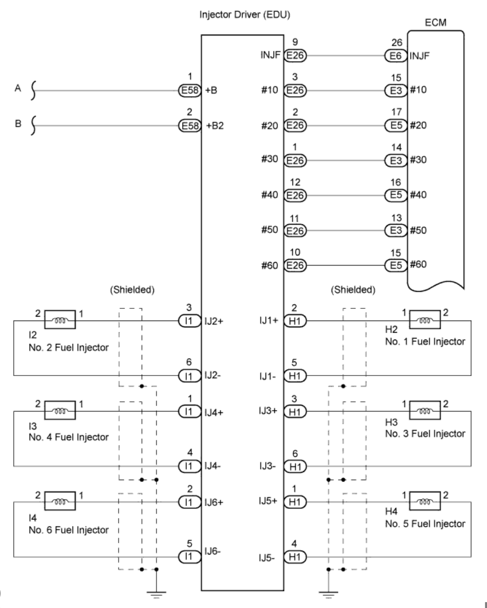

Roman Posted September 14, 2023 Author Posted September 14, 2023 4 hours ago, xsspeed said: Romandayf I was pondering direct injection as I cant get 1urfse/2urfse's out of my head, what is the main reason you abandon the DI? Cos its a bitch or? Some very light reading suggests benefits mixture (efficiency and power) and Im sure something talked about charge cooling too, or is there really a need to run both DI and port injection that Im missing and so becomes a big faff? Or is the main reason for looking at these toyota DI n/a engines because they typically have the higher compression as a starting point Yeah the main appeal here was the high compression ratio, and aftermarket parts availability from the bigger engines. I dont really have a choice though, even if I had an ECU capable of running it. Because the aftermarket cams are only for the 2GRFE, and they do not have the DI fuel pump lobes on one of the cams. So all that stuff goes in the bin anyway. But the 2UR might be the same. And/or the ECUs of this era will be reflashable. I'm not sure how easy they would be to swap into another car with factory ECU though, and keep it happy with all of the bits that will be missing. 1 Quote
Roman Posted September 14, 2023 Author Posted September 14, 2023 6 minutes ago, Truenotch said: There's a few options to run DI now. They're all pricey, but it's good to have the option. On the front of this engine, there is a DI control box. It has inputs from the main ECU, and outputs to the injectors. I suspect it takes regular injector outputs, then beefs them up into the high voltage peak and hold setup for DI. So it might be possible to run that with a bit of homework, but for reasons above I've already biffed all that stuff anyway. 1 Quote
xsspeed Posted September 14, 2023 Posted September 14, 2023 oh yeah wouldnt be with factory ecu i wouldnt think, too many protections/interfaces with the body id have thought didnt think of the cams from 2GR, but regardless seems like some voodoo controls from a non factory ecu (with enough outputs) needed Quote
Roman Posted September 14, 2023 Author Posted September 14, 2023 I downloaded the Link G5 software to see what features it has to control direct injection specifically. And, there's not really much different about it compared to normal injectors. Just some features for controlling the high pressure fuel pumps (which will work differently based on manufacturer etc) and then apart from that, it was just setting up injector data as usual, and assigning them as DI injectors (which presumably puts the drivers in peak and hold mode) However I also noticed there was an option you could select, to make the injector outputs work with the factory Toyota injector driver boxes. There wasnt anything special regarding injector timing or anything else. A few extra features for blending port and DI injection if you were using both. So I'd say it's probably still feasible to run it with a normal ECU that's got 8 injector outputs, so long as you connect to the box. I'd test it here but I chucked that box away already. The 2UR looks to run a box just the same. 5 Quote

Honda Ass Dragger Posted September 15, 2023 Posted September 15, 2023 TBH the G5X is a bit of a disappointment It still requires driver boxes for DI - where as a Motec doesn't 1 1 Quote
GARDRB Posted September 15, 2023 Posted September 15, 2023 1 hour ago, sheepers said: Did it? Shit I don't remember that...... Yeah 518 weeks ago 2 4 Quote
Hyperblade Posted September 15, 2023 Posted September 15, 2023 4 hours ago, Honda Ass Dragger said: TBH the G5X is a bit of a disappointment It still requires driver boxes for DI - where as a Motec doesn't Yeah and for the price you don't even get a PDM built in. On the flip side at least g4x maps transfer over and plug a and b are same as g4x series so easy upgrade. But a bit underwhelming tbh. 1 Quote
Roman Posted September 15, 2023 Author Posted September 15, 2023 Yeah I guess it only really makes sense if you wanted to run a fully sequential V12, or a V8 with fully staged injection. But even so, at that price point might not even make sense compared to other options. 1 Quote
