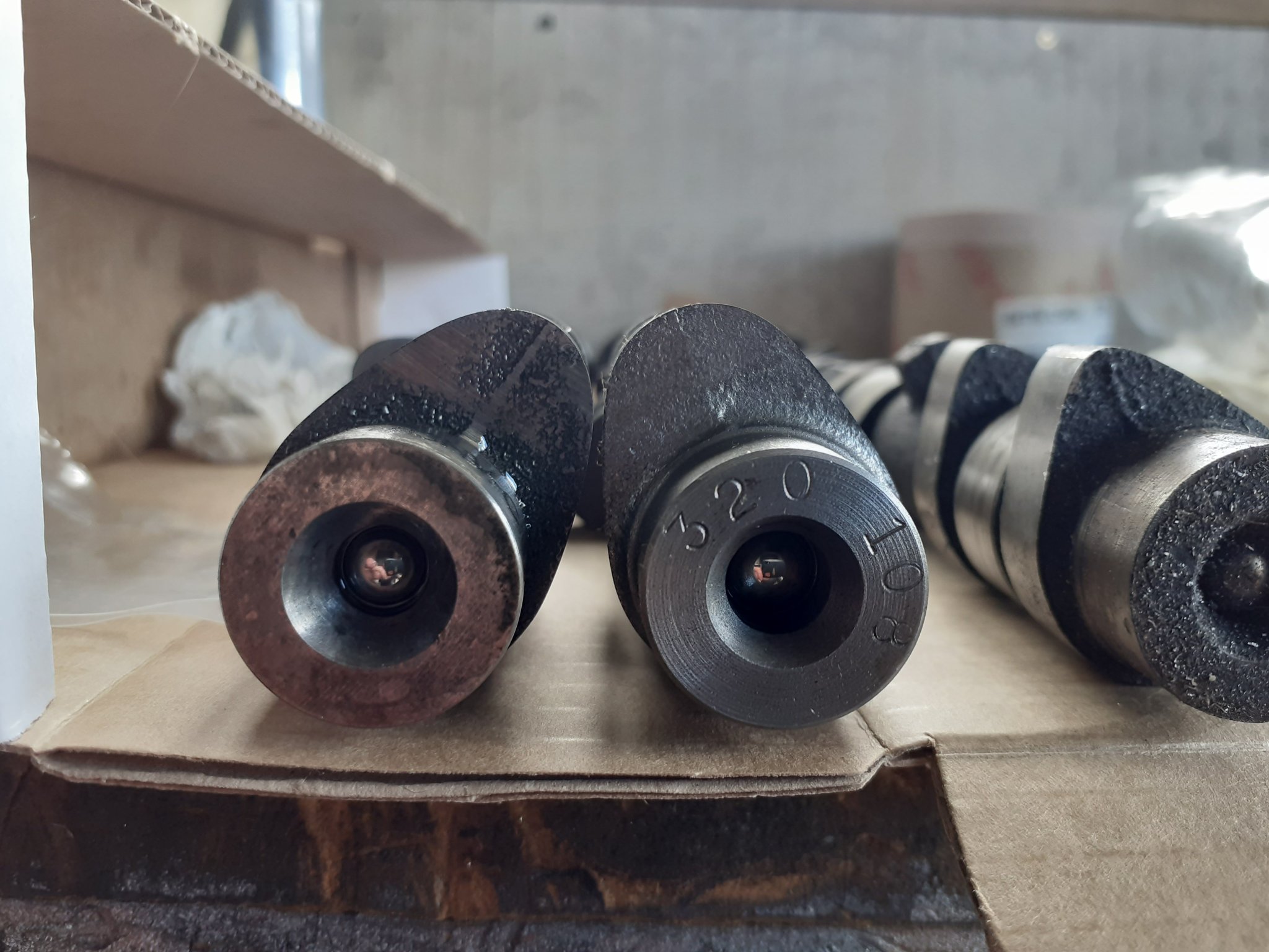

kpr Posted August 29, 2023 Posted August 29, 2023 would be interesting to see the whole curve on them. if the kelfords open the valve faster to the first mm. do they continue on accelerating the valve faster, getting to higher lift faster? This is an interesting pic that shows the numbers shown, only tell a small part of the story. left is a 318/11mm right is a 320/10.8mm pretty much same on paper with the advertised measurements. not so much when looking at them. Quote
Roman Posted August 29, 2023 Author Posted August 29, 2023 Yeah thats interesting! Like if there was a measurement for "Duration at 70% or greater lift" the numbers would be way different between those two. Although, probably dont need to make things even more complicated haha. Quote
ajg193 Posted August 29, 2023 Posted August 29, 2023 Which one of those two cams actually worked better? At what point do the gains from extra area under the curve get outweighed by harsher dynamics on the valvetrain Quote
kpr Posted August 29, 2023 Posted August 29, 2023 The one on left worked bit better. but bad example of what would actually work best. as both kinda sucked for the application. too much duration. Can only go so much duration till it turns your engine into a turd. im running a 304/300 (262/258 at 1mm) combo. the 318/320 takes a massive hit in the bottom end for only little numbers up top Yep, kinda in the cam manufacturers hands on that one. too aggressive will just start breaking stuff. Quote

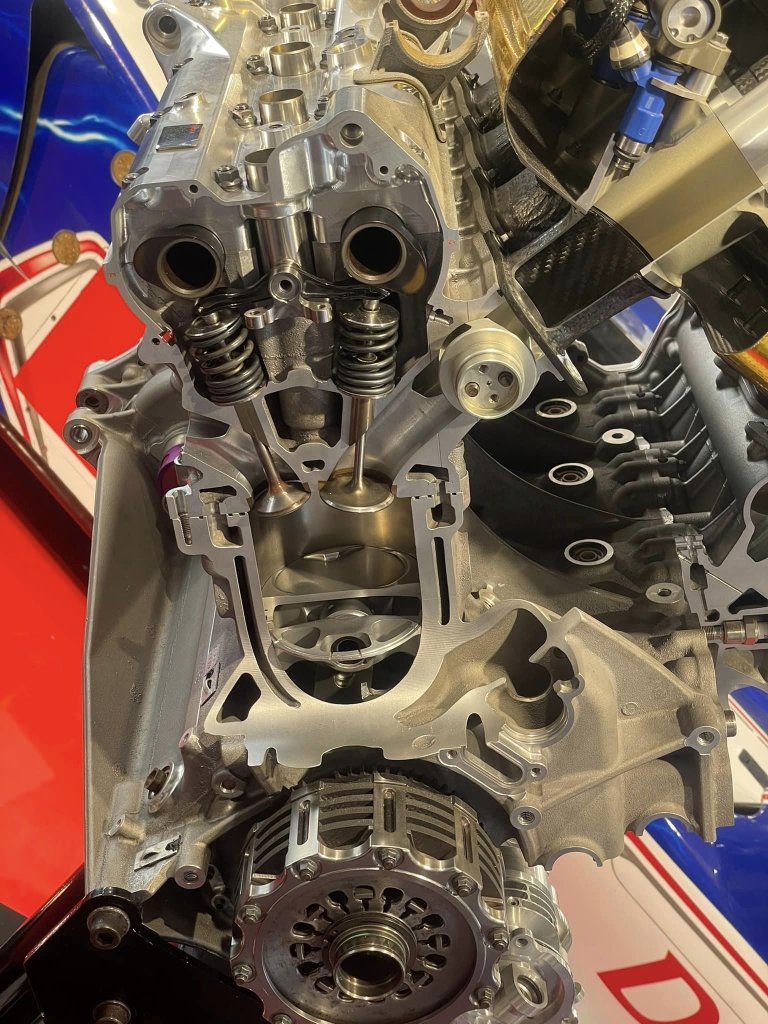

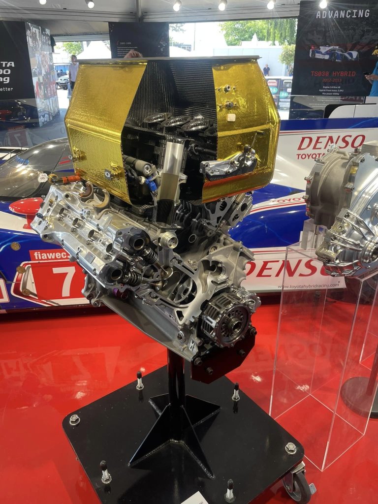

Roman Posted September 3, 2023 Author Posted September 3, 2023 Hey, thanks for following up! I cant remember the exact details or where I saw it. But I remember someone put a car on the dyno where they could hold the load steady. So they ran a butterfly throttle setup, then took the butterflies out and reran for zero difference (just controlling engine speed with dyno) Like has been evident from a lot of KPRs testing, there seems to be littler harm in just oversizing the intake diameter. Seems like the intake is most sensitive to changes at both ends (and length) but not much of the middle area seems to make too much difference, within reason. However - Barrels are still cool, nice and compact, and potentially easy enough to manufacture for a one off experiment. I found the picture of the barrel setup in the V8 race engine. Quote
