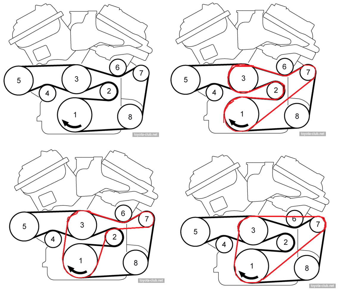

xsspeed Posted July 25, 2023 Posted July 25, 2023 Whats that idler doing, can you move that to the right to open the angle up Quote
Roman Posted July 25, 2023 Author Posted July 25, 2023 Yeah its easy to just reindex the timing mark. Just set the motor to TDC on #1 and then mark both the pulley and the timing cover at some point that's easy to point the gun at. Not really a big issue with the timing mark, it's just what you put a timing light on. Not the mark for setting the chain. So you can just put a new mark on the pulley and something close to it at any position.No drama. For the belt, I'm now only going to be running the alternator (pulley 7) and the waterpump (pulley 3) as accessories. Then pulley 2 is a hydraulic tensioner, number 6 is a static idler. So there are a few options for the belt path and how tensioner might work. I'm thinking the top left option is probably the best, as I get the most belt wrap on everything. Could maybe go without the #6 idler. Bottom left would be minimal path, least belt wrap, probably flap around a lot and need to be pinged up super tight. But either way, if I'm not running the belt around #8 (aircon I think) then I need to chop that timing mark. 3 Quote
xsspeed Posted July 25, 2023 Posted July 25, 2023 Is bottom left feasible for tensioner to work other way? 1 Quote

Popular Post Roman Posted July 30, 2023 Author Popular Post Posted July 30, 2023 Ahh man I have been going 7 days a week plastering and painting my house outside of work hours. Which I think has taken a toll on my levels of brain juice for working on car stuff. As today I cut off the timing stand thingy - which was hollow so now there's a hole to patch in the timing cover. Then I couldnt figure out why the tensioner wasnt going to work at all. Because I was trying to run the belt the wrong way. So I took the tensioner off and had a look for how it might run without it. I could probably just tension it by pushing the alternator into its proper place. (With the correct length belt - This one slightly too short) Which means I didnt actually need to cut off my timing mark. Also I bought a 6PK belt when it's a 7PK. (wtf does it need 7PK for?!) If I can run it without the tensioner that would be good, for sake of a 2kg weight saving. But I think I need a decent rest before doing any more brain based activities. 18 Quote
kpr Posted July 30, 2023 Posted July 30, 2023 might be able to change that idler pulley to an eccentric type one, to get belt adjustment 1 2 Quote
shrike Posted July 30, 2023 Posted July 30, 2023 Assuming your going to tig up the hole? I have the feeling its not going to be a fun job Quote
Roman Posted July 30, 2023 Author Posted July 30, 2023 If the belt path works like that, I'll just get another front cover so I get the timing mark back. Ahh yeah an eccentric idler pulley looks like a good scheme. Will see what I can find. 1 Quote
Spencer Posted July 30, 2023 Posted July 30, 2023 Belt seems legit like that, new cover and yeah some kind of adjustment on that idler and its done. Keeping those timing marks will be nice. 1 Quote
Roman Posted July 30, 2023 Author Posted July 30, 2023 It's amazing how grippy even the PK6 is on there - if I turn the alternator pulley, it is holding on well enough to turn the crank (heads off though, so no compression) However I dont think it would need a huge amount of belt tension to work well. Currently has a PK61035 on there, have ordered a PK71080. Hopefully that'll be long enough to get the alternator bolted on correctly, either with a smidge of tension or slightly loose. It still cracks me up that with the 1NZ motor, the belt tensioning system is basically "Put a bar behind the alternator, pull the belt tight, do up the alternator" haha. No tensioner at all. 1NZ is a masterpiece of irreducible complexity. 7 Quote
