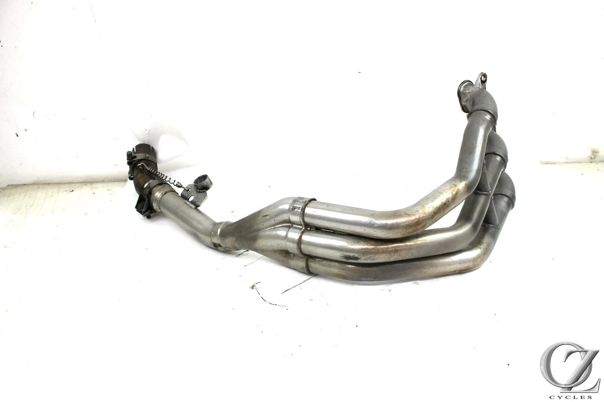

thegreatestben Posted July 12, 2023 Posted July 12, 2023 What do spicy three cylinder bikes do? Street triple R and brutale sound noice and go like stink Quote
BiTurbo228 Posted July 12, 2023 Posted July 12, 2023 16 minutes ago, Roman said: The only difference between 3 cyl and 4, is that the spacing is an even 240 degrees rather than an even 180 degrees. Ah I hadn't thought about it as 3 separate 3-cylinders. I was more thinking about linking it up like a straight 6 with a 6-3-1 pairing 1 and 6, 2 and 5, and 3 and 4 together. Quote
Roman Posted July 12, 2023 Author Posted July 12, 2023 @thegreatestben From what I've seen they are largely based around fitting bike's available space. Notice the balance pipes though up near the flange. Seen this on a few bikes. On the S1000RR they have a throttle plate on the balance pipes, so they can open or shut depending on rpm, because it does (something something) Quote
thegreatestben Posted July 12, 2023 Posted July 12, 2023 Probably passes emissions rather than makes spices Quote
Roman Posted July 12, 2023 Author Posted July 12, 2023 4 minutes ago, BiTurbo228 said: Ah I hadn't thought about it as 3 separate 3-cylinders. I was more thinking about linking it up like a straight 6 with a 6-3-1 pairing 1 and 6, 2 and 5, and 3 and 4 together. The firing order isnt like a straight six either. This V6 firing order is 1-2-3-4-5-6. So cyl 1-3-5 (left bank) and 2-4-6 (right bank) are the evenly spaced sets. Easy! Quote
