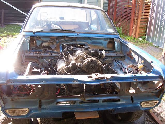

igor Posted April 26, 2020 Posted April 26, 2020 Rover V8 into HC Viva has been done before with some success. Many will poohoo the idea of course. 1 Quote
