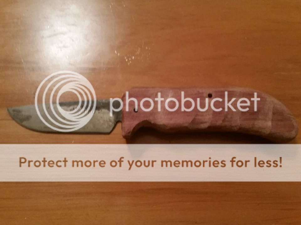

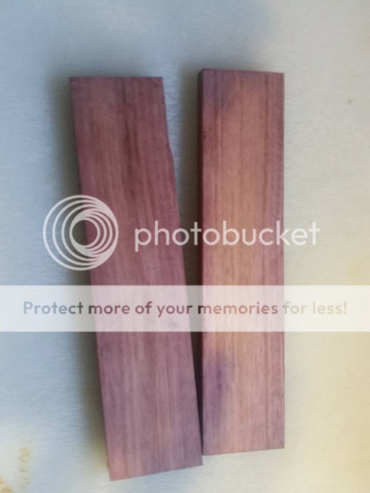

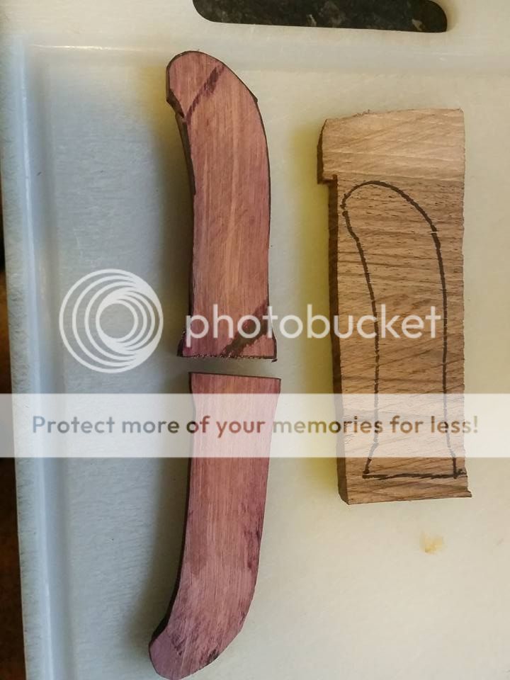

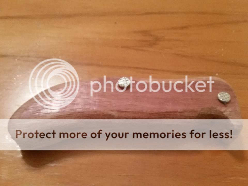

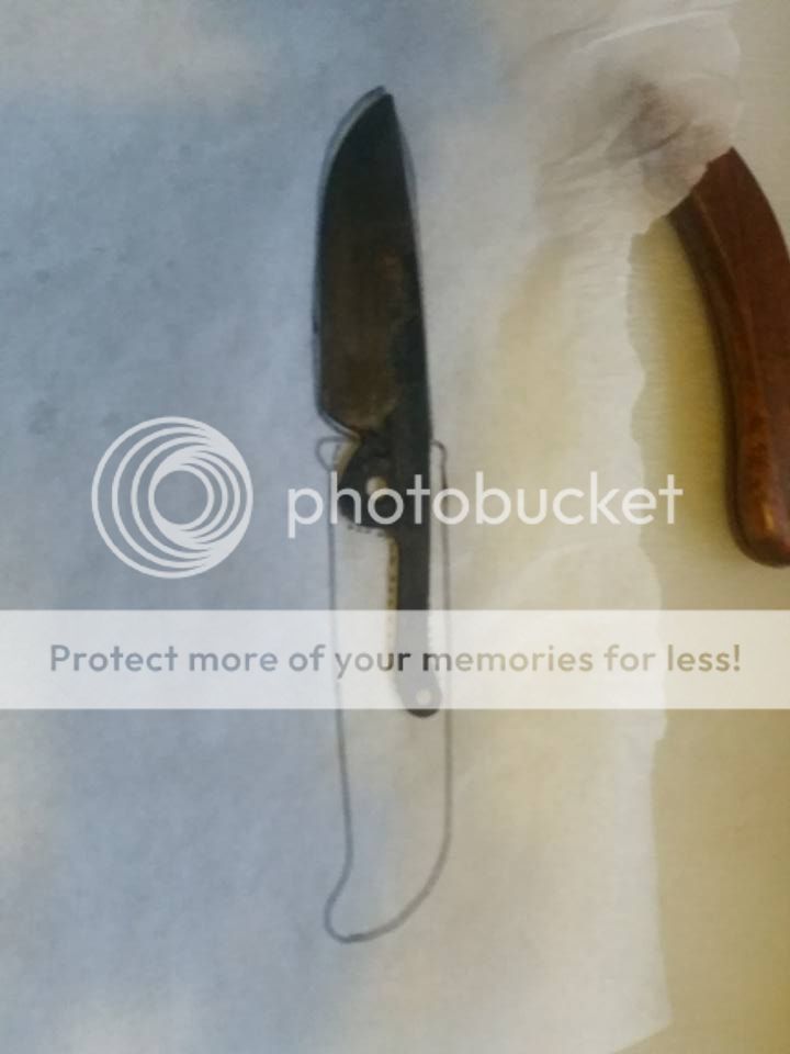

felixx Posted July 1, 2016 Posted July 1, 2016 So I got given a Svord Peasant Knife It is OK but not purrfect as a folder so I decided to make a fixed blade out of it. Here is my work so far Dismantle knife Choose purple heart for handles Draw some pictures Draw some penises and cut them out Roughly shape handles I still need to give handles the final sanding Epoxy and pin blade and handles together Hit handles with danish oil Make sheath Make a second one for my son Quote

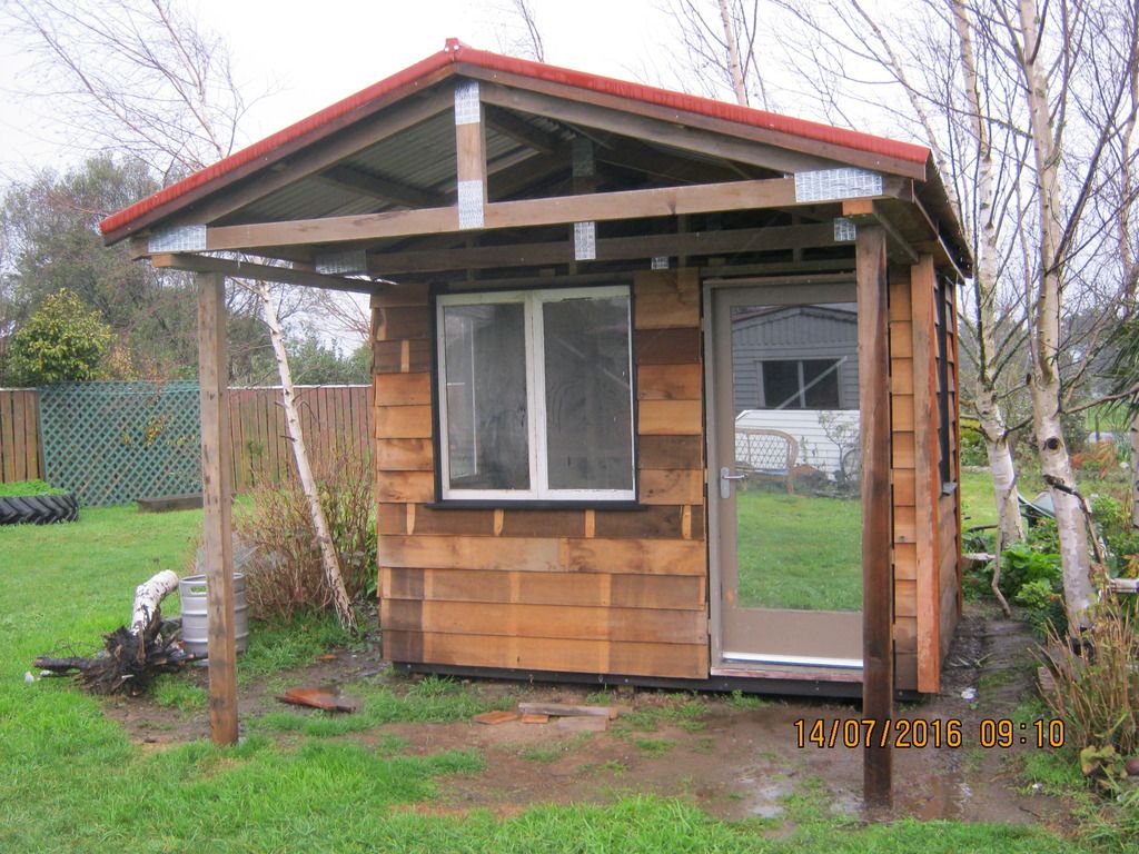

bathcollector Posted July 23, 2016 Posted July 23, 2016 Got a floor, all the windows and a door now. Door swung first time too, must have done something right ? Quote

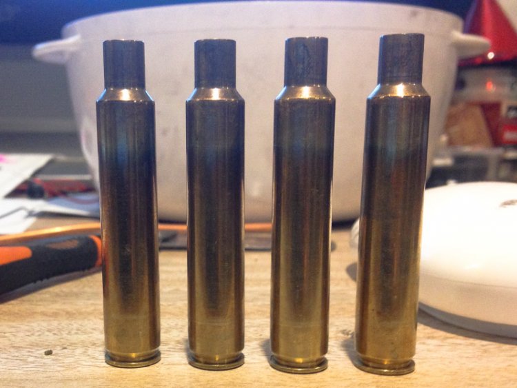

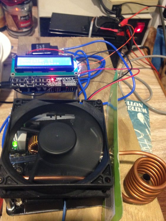

NickJ Posted September 18, 2016 Posted September 18, 2016 Other than Russian engineering i'm a keen long range shooter, a big part of this is reloading ammunition due to the accuracy gained from tailoring for the rifle, as brass work hardens with every shot, annealing is required every few cycles to keep everything ticking along nicely. Traditionally a gas cooker was used to heat the brass just before red hot, but as the process must be repeatable case to case it is arguable whether doing this by hand is beneficial. (There is a bit more detail than this, better suited to other forums) The solution to me was induction annealing, using a micro processor to control the time removes the human element and is repeatable even with days between sessions. Using an induction coil off ali express I experimented with coil size until I found a diameter that worked with brass, then coded an arduino to take care of timing, a few components later on a block of ply and I had a crude electron powered annealer. Only thing to add is a servo to drop the case out the bottom at the end of the cycle ready for the next Just like a new one Quote

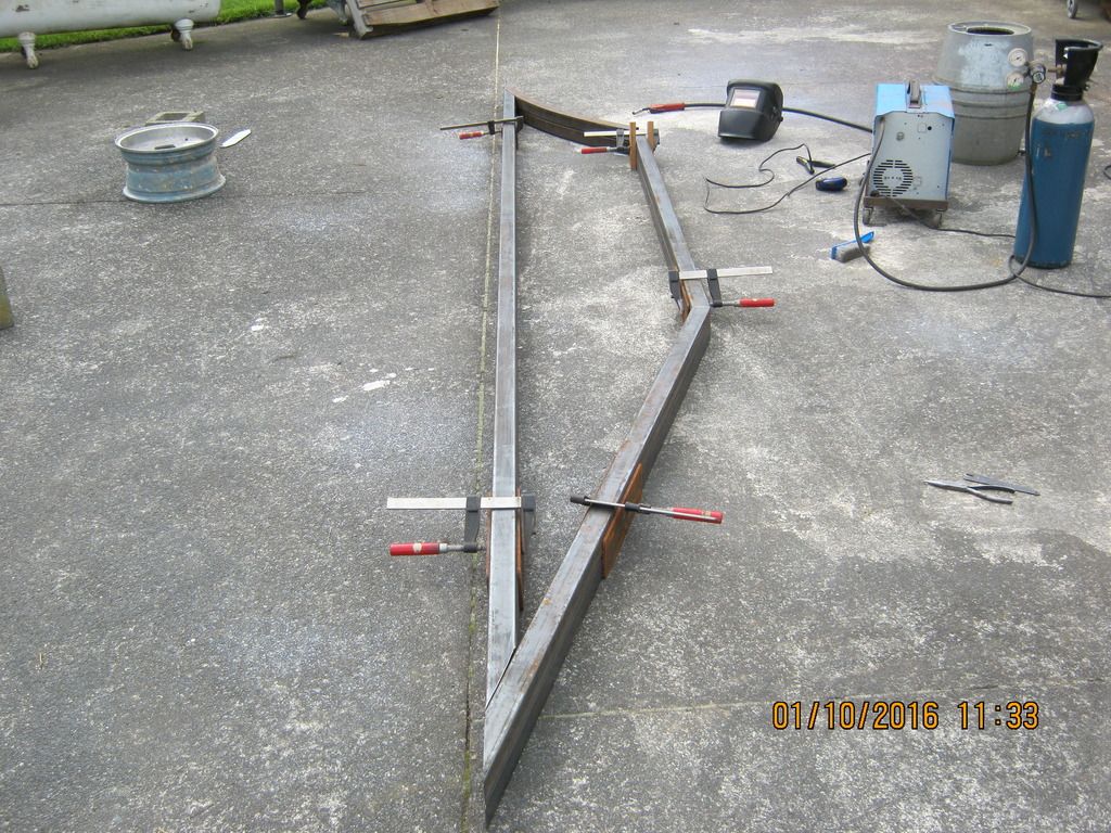

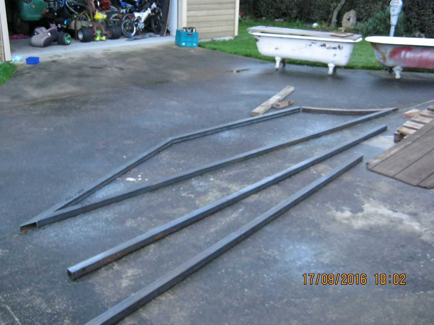

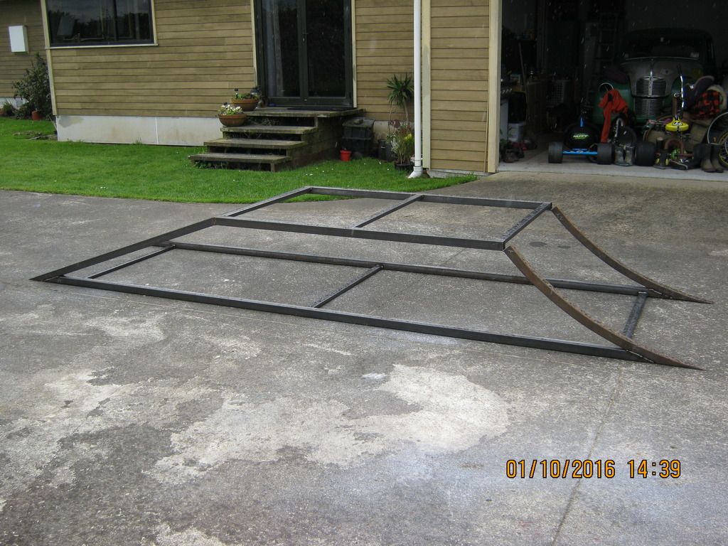

bathcollector Posted October 1, 2016 Posted October 1, 2016 We have a shit skatebowl in town so have knocked up a ramp for the kids at home. A few more cross rails to weld in when this thunderstorm passes.I guess some plywood won't go amiss either. Quote
