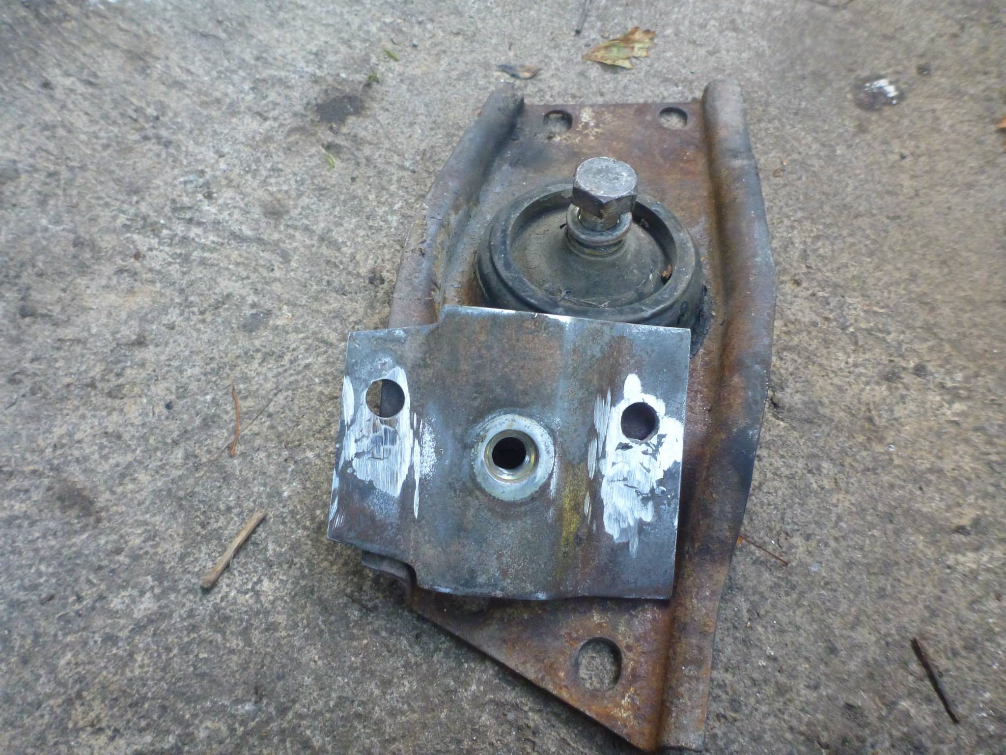

rusty360 984 Posted April 26, 2020 Report Share Posted April 26, 2020 @cletus I want to install a center lap seat belt in the back of my EH for juniors car seat. Theres no factory mounts back there. I've read through the low volume standard for seatbelt Anchoranges, and sorta understand it. Were would be the best place to install with the space available in this pic? Spot 1 would be easiest if thats ok. Spot 2 would be ok but pushing max width of 500mm and I cant pull them in due some brackets on the inside of that swage line. Any help or direction with this would be great! Quote Link to post Share on other sites
Kiwibirdman 1,672 Posted April 26, 2020 Report Share Posted April 26, 2020 Spot 1 is where I put the center belt on the EJ Wagon. The Seat belts cross over to get the proper spacing. I haven't put the car through certification yet, this was how @cletus advised me to do it. Position 2 will put the belt under the seat base. I can take photos if you need. Quote Link to post Share on other sites
rusty360 984 Posted April 26, 2020 Report Share Posted April 26, 2020 Just now, Kiwibirdman said: Spot 1 is where I put the center belt on the EJ Wagon. The Seat belts cross over to get the proper spacing. I haven't put the car through certification yet, this was how @cletus advised me to do it. Position 2 will put the belt under the seat base. I can take photos if you need. I was thinking this to, a couple of pics would be awesome! Quote Link to post Share on other sites
cletus 38,284 Posted April 26, 2020 Report Share Posted April 26, 2020 #1 looks like the best spot, as mentioned spot 2 would be under the seat base so when the belt gets loaded it would pull the seat up/forward 1 Quote Link to post Share on other sites
rusty360 984 Posted April 27, 2020 Report Share Posted April 27, 2020 20 hours ago, cletus said: #1 looks like the best spot, as mentioned spot 2 would be under the seat base so when the belt gets loaded it would pull the seat up/forward Cheers for the info. That face it will go on is on the same plane as the seat back is that ok? Is there a doubler plate size that the cert boys like to see? Or just run with specs on lvvta sheet. Can you put two belts on one doubler plate setup? Or does it become so big it's better to just have separate units for each belt. Quote Link to post Share on other sites
cletus 38,284 Posted April 27, 2020 Report Share Posted April 27, 2020 Yep that's fine on the same plane as the seat. Size doesnt matter as long as it meets the minimum area of 3000sq mm . Most people use 80x50 plates in that application. 2 belts off one anchorage is doable but it's much less work to just put 2 plates next to each other, otherwise the plating requirement is much bigger and complicated 1 Quote Link to post Share on other sites
cletus 38,284 Posted April 27, 2020 Report Share Posted April 27, 2020 5mm bolts are much easier and neater to use rather than rivets too 2 Quote Link to post Share on other sites
