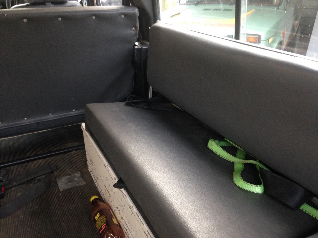

Land rover rear bench seats....
How much can I modify the lower seat before the wof man gets unhappy? Considering now its just a squab tied to the upright, can I install a slightly larger squab?
