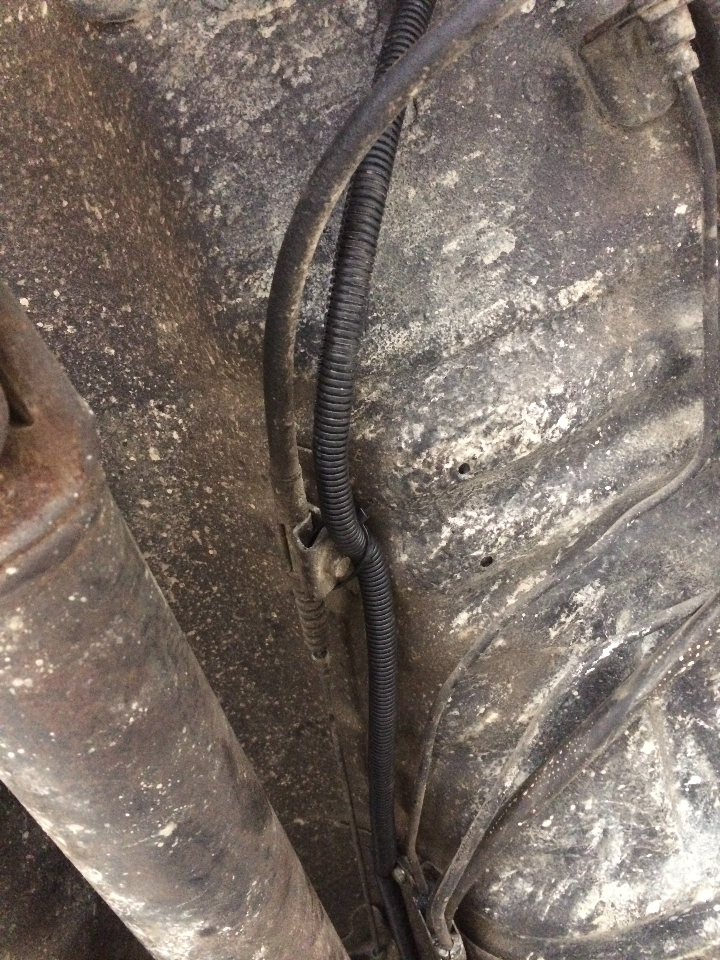

piazzanoob Posted April 15, 2018 Posted April 15, 2018 On 4/9/2018 at 09:40, ajg193 said: Failed WoF today needing a cert for the EFI. Booked in for next monday. Cert guy wasn't very helpful in answering questions regarding things. I'm using factory mounting locations for the fuel hoses on the car, but the mounting points are more than 300 mm apart. I guess I will need to go out and get a whole load of P clamps and put shit loads of holes through my car all over the place to bring them to 300 mm spacing? Also the fuel lines go through the driveshaft tunnel (factory location and there is nowhere else to put the fuel hoses) and there is no driveshaft safety hoop as the increase in power is only like 1%. Is this acceptable or do I need to do heaps of stupid drastic things? If I have to put too many holes in the car I would probably rather just rip the EFI off and go back to carb. Especially at the $565 cost of a cert... I've moved the electrical wires for the pump up further into the tunnel, they are connected to the brake pipe mounts, so as not to be right next to the fuel hoses wherever possible. First image shows fuel hoses in driveshaft tunnel. (Handbrake cable, electrical wires, brake pipe, fuel hoses from left to right) Second picture shows fuel pump setup Third image shows electrical feed cables running through tunnel along brake pipes, fuel hoses at bottom of image along chassis rail So basically: 1. Is my wiring location alright? 2. Will I have to add heaps of clips to make factory fuel hose supported at 300 mm (I did also add the flexible hose, which I guess definitely needs 300 mm spacing)? 3. Fuel hoses run near driveshaft, will I need to put in a hoop? EDIT: "Note that where a production vehicle is fitted with its original fuel tank or other fuel system components in their original locations, the requirements in this chapter do not apply" Does that mean I only need to put P clamps on the added flexible hose and call it a day? If this is in a kp starlet? if so i believe they came factory EFI in japan so really you putting in EFI doesn't mean shit to the car. And the power increase would be less than putting a cam in or sidedrafts on. me personally wouldn't even bother with vtnz or any other testing stations just take the car into a local garage who preferably works on older stuff who will most likely appreciate the car for putting EFI on and you should get a wof without to much hassle. 2 Quote
ajg193 Posted April 15, 2018 Posted April 15, 2018 59 minutes ago, piazzanoob said: If this is in a kp starlet? if so i believe they came factory EFI in japan so really you putting in EFI doesn't mean shit to the car. And the power increase would be less than putting a cam in or sidedrafts on. me personally wouldn't even bother with vtnz or any other testing stations just take the car into a local garage who preferably works on older stuff who will most likely appreciate the car for putting EFI on and you should get a wof without to much hassle. VTNZ guys were going on about how great the EFI is on it and trying to find a loophole. They passed it last time and just said "awesome, well done" Looks like I'm not going to get any concrete answers from the LVVTA before tomorrow morning so I'll just take it in for the cert. LVVTA Operating Requirements Schedule says that they check that the cert process isn't being done where it isn't legally required as a part of the plate manufacturing process. So if that ends up being the case they would just send the documents back to the certifier and I assume refund the cost of the cert process. I'll be taking the JDM and NZDM brochures with as reference data for the power figures and whatnot. I probably should have taken the JDM brochure with to the WoF inspection as the guys didn't seem to realize that any RWD Starlets ever came with EFI. Won't be taking it to VTNZ again once I get the WoF. I'll just take it to the dodgiest cheapest chinesest WoF shops in an attempt to slowly recover the costs of the cert process. One thing that is shit these days is that people with old cars are subsidizing the WoF costs for people with new cars. They should really have a different price for cars that need six monthly inspections. WoF used to be $37 at VTNZ when I first got the Starlet. The only thing that has changed since then is the price. 1 Quote
