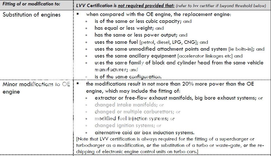

Hi, failed another warrent in the weekend.dude reckons i need a cert for my 4g63 engine conversion in an ex lancer that was originally a 1600.is this true?
yes
if converting to auto is it required that you have the lock out gates the factory auto shifter has? eh cant slam it in to park from drive with out pushing the shifter button in.
Not tryna be a no brainer but i'm pretty much a cunt who knows nothing. Different makes therefore would need different mounts and shit
Hush yourself if you don't know what you're talking about.
Any increase in capacity requires a certification and any increase in power over 15% (I think? Perhaps 20%) So the warrant man is entirely correct.
yeah, I will need a cert for my corolla as replacing the 2e with blacktop 4age (dont start on e - a series change) will be a 100%+ power increase, just using stock BT motor
