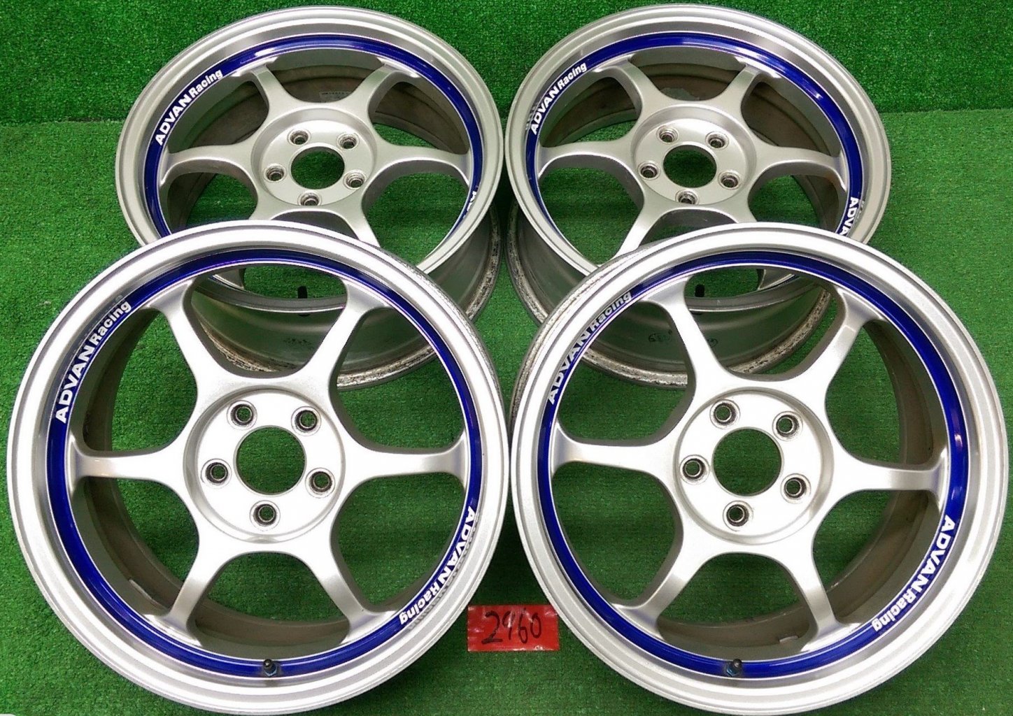

Popular Post KKtrips Posted January 31, 2019 Author Popular Post Posted January 31, 2019 Hopefully tomorrow. Rims are Advan RG's in 16x7 and tyres I'm anticipating will be 205-55-16s so should be same rolling circumference as factory tyres, maybe a teeny tiny bit bigger. These are the new rims here. 17 Quote

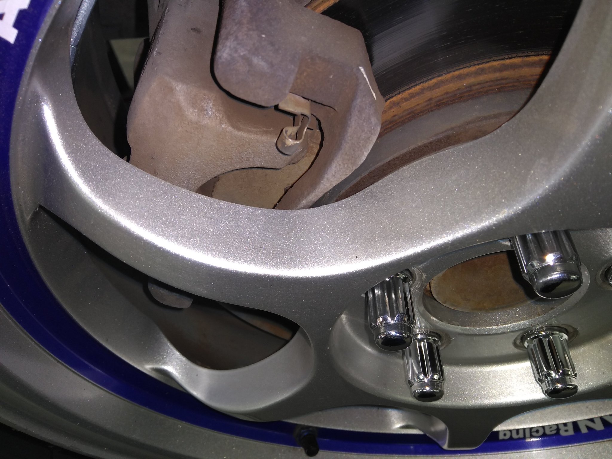

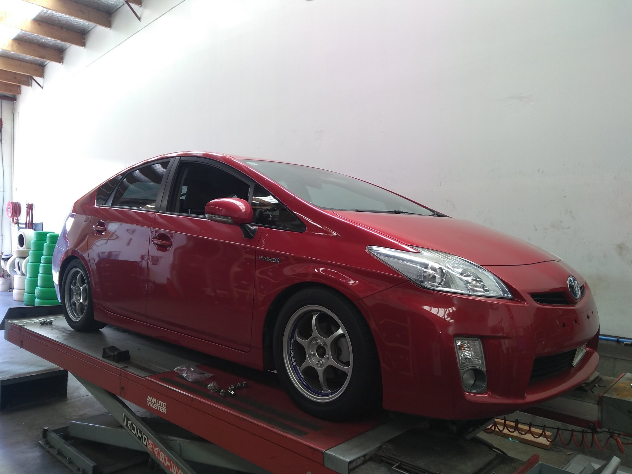

Popular Post KKtrips Posted February 2, 2019 Author Popular Post Posted February 2, 2019 Fitted wheels and tyres today. But the wheels rub marginally on the callipers on both left hand side wheels. It is literally a zig-zag paper thickness clearance. So am ordering a set of 5mm spacers and will be good to go. It'll sit a little lower after I roll it back and forth a couple of times but this is a good idea of how it will look for now. Ā 22 1 Quote

cletus Posted February 2, 2019 Posted February 2, 2019 Do the spokes rub on the caliper itself, or the pad carrier part? Quote
Vintage Grumble Posted February 2, 2019 Posted February 2, 2019 The callipers will expand a bit under heavier braking I'd say, so will have to use spacers I'd imagine? Happened with my Corolla, sweet as until I braked hard, then calliper hit wheel. I machined a tiny amount off my rims to sort it. 2 Quote
KKtrips Posted February 2, 2019 Author Posted February 2, 2019 On 02/02/2019 at 20:41, cletus said: Do the spokes rub on the caliper itself, or the pad carrier part? Spokes rub on the outside of the mount, not the caliper. Also I've checked the studs, there is at least 10 turns. 1.5mm pitch into 5mm spacers will drop that down to 7ish turns. Alternatively I could space the caliper inboard about 3mm with a thick washer behind each mount bolt but it's not really the right way to do it. *waits for you to tell me its a legit way to fix it*Ā 5 1 Quote
