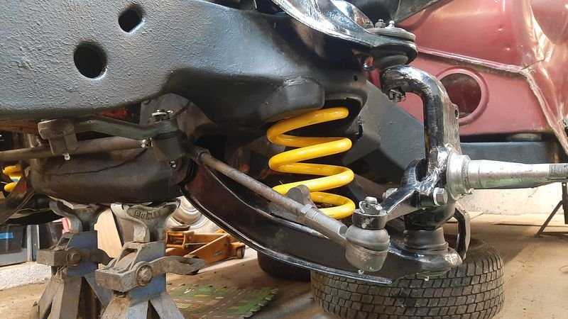

We decided to remove the front clip to tidy it up and make it easier to get to the suspension and enginey bits as well. Check out the custom radiator shims - the Torana must have a shorter engine bay. We got $50 of random 202 bits of FBMP and amongst a couple other handy bits that included a near new water pump, a much better thermostat housing and the extended fan thing. Nose cone off Note the blue inner on the drivers fender i think this was replaced post restoration as the paint is overall much worse than any other panel and seems to have been painted only once bolted on - the passenger side is also a replacement (originally a pale yellow/mustard) but was fairly obviously repainted with much more prep and attention while off the car. Other than the fender rust behind the front wheels where water and mud collects, the front clip panels are entirely rust free which is nice Fenders out Pulled everthing to bits, cleaned it, derusted, and painted Pretty pleased with that, pressed a couple of dents out with the press and it seems to sit nicer too Going through the front indicators to make at least 2 ok ones inner fenders tidied up rad support seperated from the nosecone and all bits including the lamps all cleaned, derusted, unbent, painted, threads tapped and reassembled. Nose cone has similar treatment but just knocking the cracked paint off on the outside and primed it. Looks worse at first glance, but its straight, rust free and ready to bolt back on, or for body work at some future point. Need to sort the rust at the base of fenders but all that stuff is ready to bolt back on. Because my big sheet of 0.8mm is for baby cars, I picked up some 1.0, 1.2 and 1.4mm panel steel offcuts today for $15 + GST ( https://rietveld.co.nz/ - what a treasure of a place - a true barry paradise!) so ill probably make a start on patching the bottom of the easier of the two fenders next to start to ease into it.

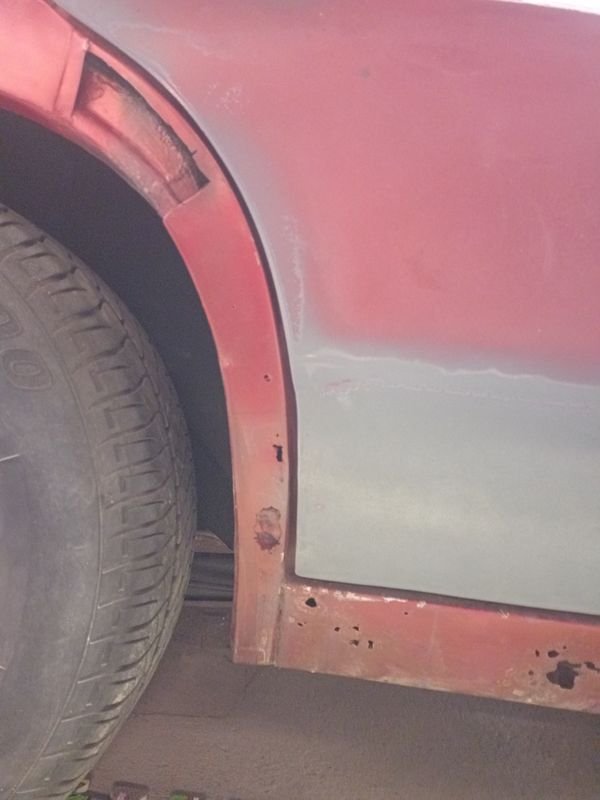

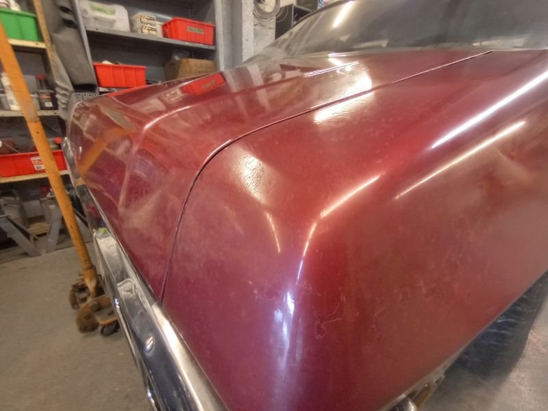

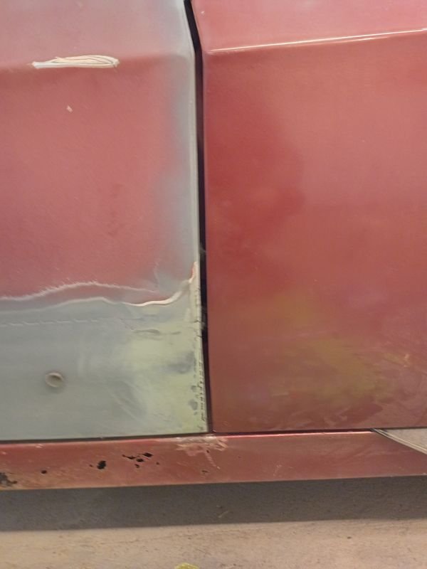

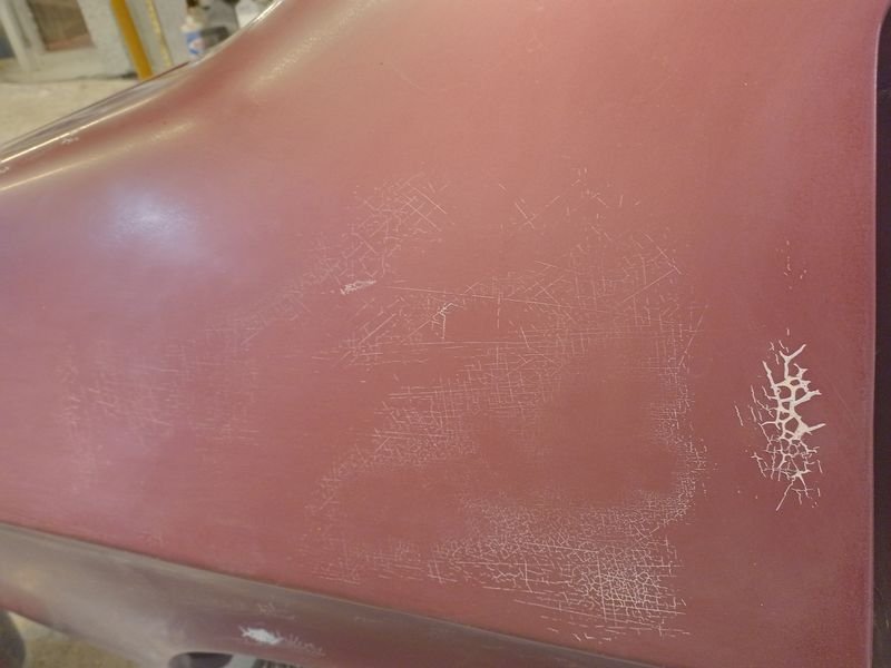

Removing the mud and giving the old girl a good bath made it look better, but also made it easier to see a fair few issues. I think this has been restored once before and there are a few rust bubbles starting and a fair bit of paint adhesion and filler cracking in all the 'usual' spots. I shouldn't have but i started to pick. The Premier sill garnish that had been riveted on this lowly Belmonts sills was holding a lot of mud so i drilled (some) of the rivets. Sucks teeth Ill think ill just put that back up there and pretend we didnt see that With the seal definitely broken i dug into all the suspect areas to see how many repair panels to put on the list . This deep crease explains the thick filler on the upper half of this quarter panel, the filler probably made the rust on the lower half worse. Removing the deep filler means the door shut looks 100x better than it did Good 5mm of filler of this too, and much the same on the other side, except that side has braze as well There were signs of lots of filler on this quarter too. It has also been (previously?) brazed some of the filler was 10mm thick Took most of it off with a heat gun, much less messy than with a whirlywoo. The panel looked like this underneath it, from a prang in the rear Spent a bit of time with some hammers and dollies and a bit of extra heat trying to shrink some spots and it is quite a lot better. Like the other side, removing the filler also significantly improved the fit of the doors to the body! So yeah, some bits are pretty much as i expected (doors) some are much much better than i feared (quarter panels, cowls) , but some i didnt even suspect, like the sills, are quite bad indeed. We will need every patch panel you can buy, which basically means its got bitten in all the usual places, but that is a nice change from not being able to buy any panels at all!

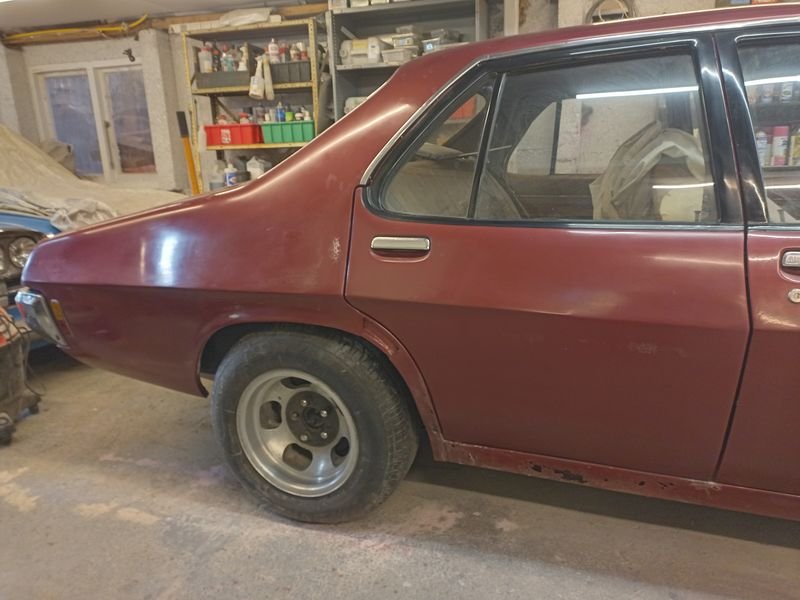

Then of course it was time to have a good look while cleaning it a bit, and taking stock So, its a 1974 Holden HQ Belmont Sedan in Orchid Red. Last wof/reg in 2001, so was on the road into Kpies early 20's around the same time i met her. Seems it also got the Torana front seats, maybe the centre console? Interior looks pretty good under the dust. Overall looks pretty straight and complete. Some rusty bits of course but not too bad at all for one of these 8s out back and 7s up front, massive CNG tank in the book gives it a rake. This car was a NZ new factory 202 manual 3 on the tree car. Bill bought it cheap from a guy who bought it to put the v8 that was in it into something else, or something - bought with no engine in it anyway The engine and box now in it is a 173 (2.8l) with a manual 4 on floor from the aforementioned rolled Torana, which had recently had a fair bit spent on the engine (??) It has a single barrel Stromberg and also has CNG. Only $4.20 to Whanganui! Took the plugs out and oiled the cylinders, cleaned the sparkplugs and filed the points and hooked up a battery. Neighbours come to assist. Many opinions were shared We managed to get it to fire off on squirting gas down the yap, but it just wouldn't keep running. The consensus is that the timing and/or the electrics are weird Brake pedal does nothing till halfway then hard stops, no braking action. Handbrake kinda works. Engine isnt stuck and clutch is free and gearbox goes into all gears. Bill is stoked it fired up, Kirsty is happy, and that it rolls at all is good enough for the transporter man. We push it back in the shed to wait for the transporter
