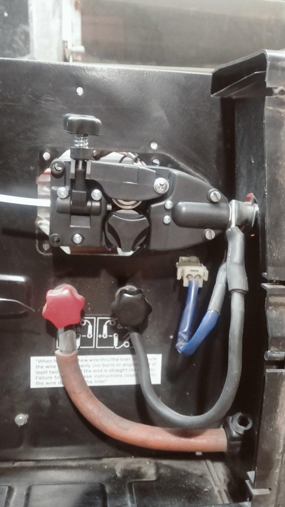

63Ragtop Posted April 18, 2025 Posted April 18, 2025 Anyone know how MIG welders work? I've had this old thing many years, restored my car with it, the feed started getting dicky, would sometimes not work and progressively got worse until it didn't feed anymore. I was about to get rid of it as I've got a TIG now, but came across a new feed unit so thought I'd hook it up and see if that fixes it. Weird thing is the motor doesn't feed once it's completely installed so I assume it's earthing out on something? With just the motor wires connected it works perfectly. Any thoughts? Quote
Bearded Baldy Posted April 18, 2025 Posted April 18, 2025 Mount it with cableties so it doesn't earth out, then update your life insurance policy? Could also compare the ohmmeter readings between the earth cable mount and unit mounting screw holes on each motor, i suspect the old one will read no continuity, and the new one earths through itself. But back to the original feed problem, was the motor itself jerky or just the wire feeding out the handpiece? Last handpiece at work had a dodgy liner after 20years and was being a right prick at random times, till we noticed that it only had feeding issues if the cabling was anything but dead straight. 1 Quote
RXFORD Posted April 18, 2025 Posted April 18, 2025 4 hours ago, 63Ragtop said: Anyone know how MIG welders work? I've had this old thing many years, restored my car with it, the feed started getting dicky, would sometimes not work and progressively got worse until it didn't feed anymore. I was about to get rid of it as I've got a TIG now, but came across a new feed unit so thought I'd hook it up and see if that fixes it. Weird thing is the motor doesn't feed once it's completely installed so I assume it's earthing out on something? With just the motor wires connected it works perfectly. Any thoughts? Try swap the pos and neg cables over to work in Dcep instead of electrode neg like it is. Quote
mjrstar Posted April 18, 2025 Posted April 18, 2025 Is the tension of the hold down screws jamming it up? Maybe try backing the screws off just a little and see if it fires into life. Quote
smokin'joe Posted April 18, 2025 Posted April 18, 2025 was the old feed actually dead, or is there damage to the feed switching wires to the handpiece ? 1 Quote
63Ragtop Posted April 19, 2025 Posted April 19, 2025 Yeah it's a Weird one, and I am definitely not an expert on electronics and definitely do not want to die! I should have said, the liner was replaced awhile ago, and I've been testing it with no wire loaded and the tension open, works perfectly when it's just the two small power connectors for the drive motor but as so as it's mounted, no go!? And I think the old unit still works as well. I should get a few bucks for it at the scrapper, fucker weighs a ton! Edit: just had another play, old unit works for a moment when trigger is pulled, new unit does not, just click from the welder. Tested both with some 12v power, both work perfectly so I guess it's something in the welder fucking up?  Quote

ajg193 Posted April 28, 2025 Posted April 28, 2025 On 19/04/2025 at 13:03, 63Ragtop said: Yeah it's a Weird one, and I am definitely not an expert on electronics and definitely do not want to die! I should have said, the liner was replaced awhile ago, and I've been testing it with no wire loaded and the tension open, works perfectly when it's just the two small power connectors for the drive motor but as so as it's mounted, no go!? And I think the old unit still works as well. I should get a few bucks for it at the scrapper, fucker weighs a ton! Edit: just had another play, old unit works for a moment when trigger is pulled, new unit does not, just click from the welder. Tested both with some 12v power, both work perfectly so I guess it's something in the welder fucking up?  The thing that caught me out once was my roller has two grooves, one for small wire and another for big wire. I was running big groove with small wife for ages and always got frustrated with it being intermittently crap. Flipping roller over fixed it 1 1 Quote
