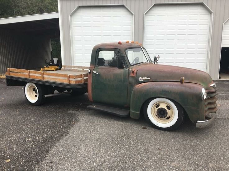

GARDRB Posted July 5, 2024 Posted July 5, 2024 Dearest Clinton, Is there any (straight-forward) way to build something like this using ye olde coaster bus chassis technique? 2 1 Quote
RXFORD Posted July 5, 2024 Posted July 5, 2024 1 hour ago, GARDRB said: Dearest Clinton, Is there any (straight-forward) way to build something like this using ye olde coaster bus chassis technique? Yes, you basically just hand over bulk hard earned cash to a shop, then many days later you will receive something similar. 3 4 Quote
GARDRB Posted July 5, 2024 Posted July 5, 2024 Haha yeah, I probably could have worded that better. What are the rules around modifying something on a COF, I assume you can't move it off a COF and it's basically a ballache to have a body-swapped bus legal? Quote
cletus Posted July 5, 2024 Posted July 5, 2024 over 3500gvm- sorry cant help you, i know nothing of the world of heavy vehicles apart from knowing that getting a gvm lowered is not possible, you might be able to body swap a old body onto a truck chassis, im pretty sure thats been done before under 3500- what you are talking about doing is doable. i have done a couple of mini kenworth truck bodies on chev silverado chassis where it might get tricky is doing an old body on a new truck chassis but if the chassis was from a truck with a higher gvm than 3500- if the weights all work, you might be able to do it but i dont know if lvvta would allow that if you used the chassis from a 3500gvm truck like a dyna or something then that would be ok, no different from using a hq ute chassis or l200 etc 2 Quote
Carsnz123 Posted July 5, 2024 Posted July 5, 2024 I believe it is possible to get a GVM lowered but requires some indepth engineering certificates to prove that it can't carry the weight that it's currently rated for. I recently (probably a year ago) ran a late 40s truck through reregistration. It had a 6.5 or 7 tonne GVM on it which was incorrect going off GM's specs from the era. Mainly non boosted brakes, section size of the chassis, and the number of leaves in the rear springs. There was also still an old loading certificate in the truck that said it was good for a touch shy of 5 tonnes. With the evidence accepted by NZTA the GVM was dropped which resulted in it being able to be driven on a class 1. 6 Quote
