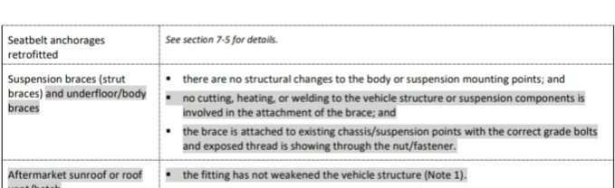

Transom Posted February 1, 2022 Posted February 1, 2022 So I am hearing a vicious rumour that the bolt on floor stiffeners that are common aftermarket fitted on Mx5s are now something that requires cert ? fake news or ? Quote
cletus Posted February 1, 2022 Posted February 1, 2022 The way I read the threshold, yes it would need cert as you have to cut (drill holes) Quote
Transom Posted February 1, 2022 Posted February 1, 2022 6 minutes ago, cletus said: The way I read the threshold, yes it would need cert as you have to cut (drill holes) Nothing new that is being pushed recently ? So no holes drilled and glue them on with some super sika bond steel glue is all good ? I guess drilling holes to bolt in a no cert needed half cage would also need cert ? Quote
cletus Posted February 1, 2022 Posted February 1, 2022 The bits in shaded grey are probably added at the last update of the threshold so that might be why it's a "new" thing Roll bars are allowed, but it doesn't mention mounting Quote
