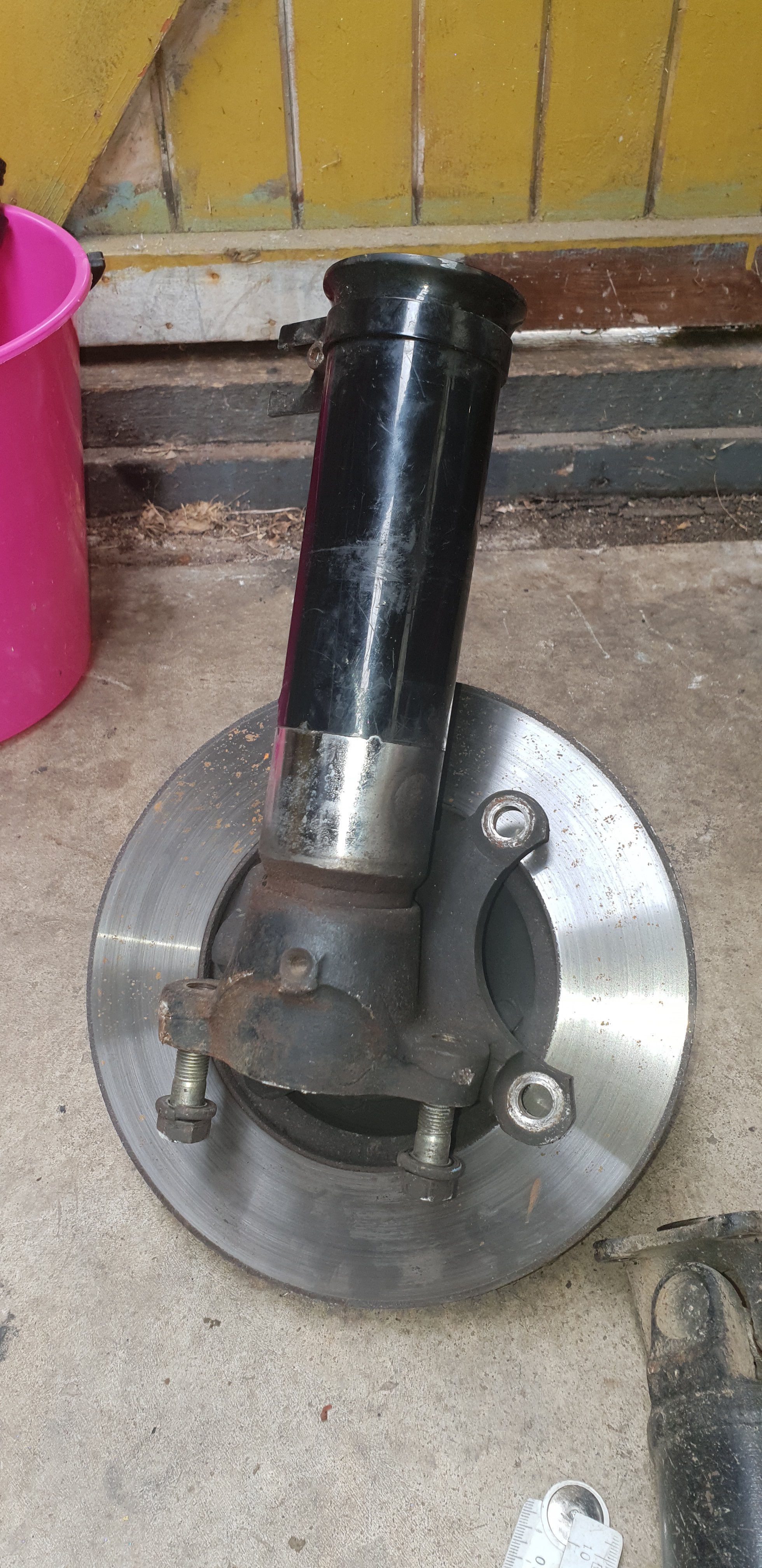

tortron Posted March 22, 2019 Posted March 22, 2019 On 17/03/2019 at 20:20, cletus said: definitely a good idea to use centering spacer. there was a q&a thing on the lvv website which said you couldn't redrill a 4 stud disc to 5 stud or vice versa, but have had a few brake kits approved like that where the holes were pretty close together, but then had a plate over the extra holes so the whole thing was sandwiched together a lot of the MRP brake kits come with multi drilled discs This is one of those hub infront of disk setups so wheel pcd is not changed at all. 6 holes to bolt the disk to the hub. I have chosen a rotor as close as I can find off the shelf. Would that be considered any different? The mounting bolt pcd on the rotor is unfortunately ever so slightly larger than the one on the hub. Looks like I will redrill in the space in-between. Is there a minimum distance to the edge I can have the holes? I'll get someone to make the centering ring and drill them Here's a pic Quote
