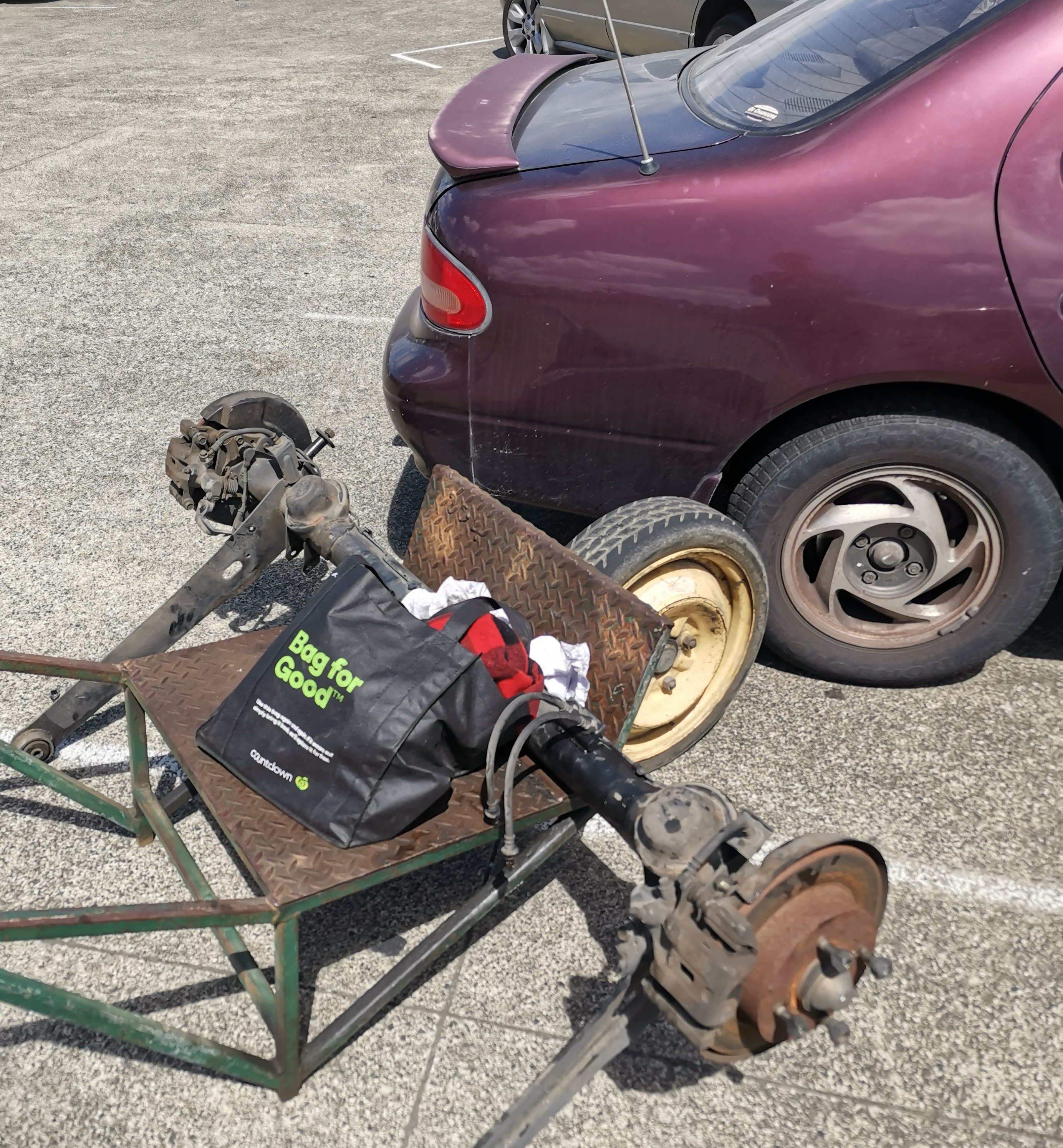

Popular Post tortron Posted February 3 Author Popular Post Report Share Posted February 3 Took the whole rear end out of a w10 avenir I just trusted the 2 comments from 2008 and 2012 I could find on Trinidad nissan forums and didn't measure anything. Dunno if the beam, spring mounts etc are to the same dimensions, but I think I can take the hubs off and swap them, I just couldn't get the disk to come off at the wreckers to take just them. I may need to go back and get the brake bias valve? Maybe the hand brake cables. They have abs on them too, so that might also work with the wingroad abs Will see, looks like it will work 15 Quote Link to comment Share on other sites More sharing options...
