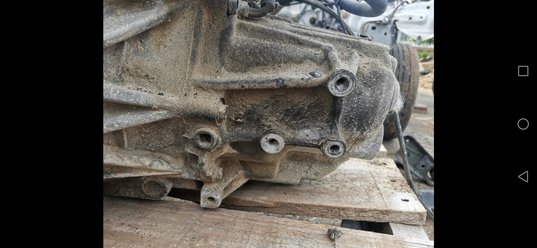

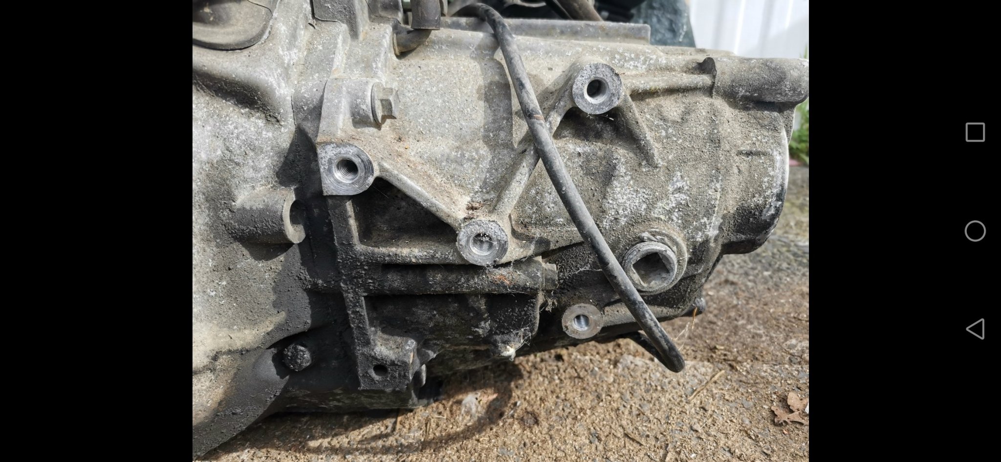

Or actually. Here's some pics for future Sr20 engine swappers
Screenshot_20221015_165034_com.android.gallery3d.thumb.jpg.83844e76f6afef7c159fd4032780ba0f.jpg
Bluebird 50 series trans. 4 bolt holes all on different planes
Wingroad trans
Screenshot_20221015_165028_com.android.gallery3d.thumb.jpg.ffadcadbb046f9fac810a8e4315a5070.jpg
3 bolts, on a flat plane
A 32 series trans in a p10
Il have to check the wrecker again, I think the p10 has the other half of the mount spot welded to the chassis rail, which would be a pain. Need to visit some other manual cars to see what's possible. I can make a bolt on mount for the wingroad at least

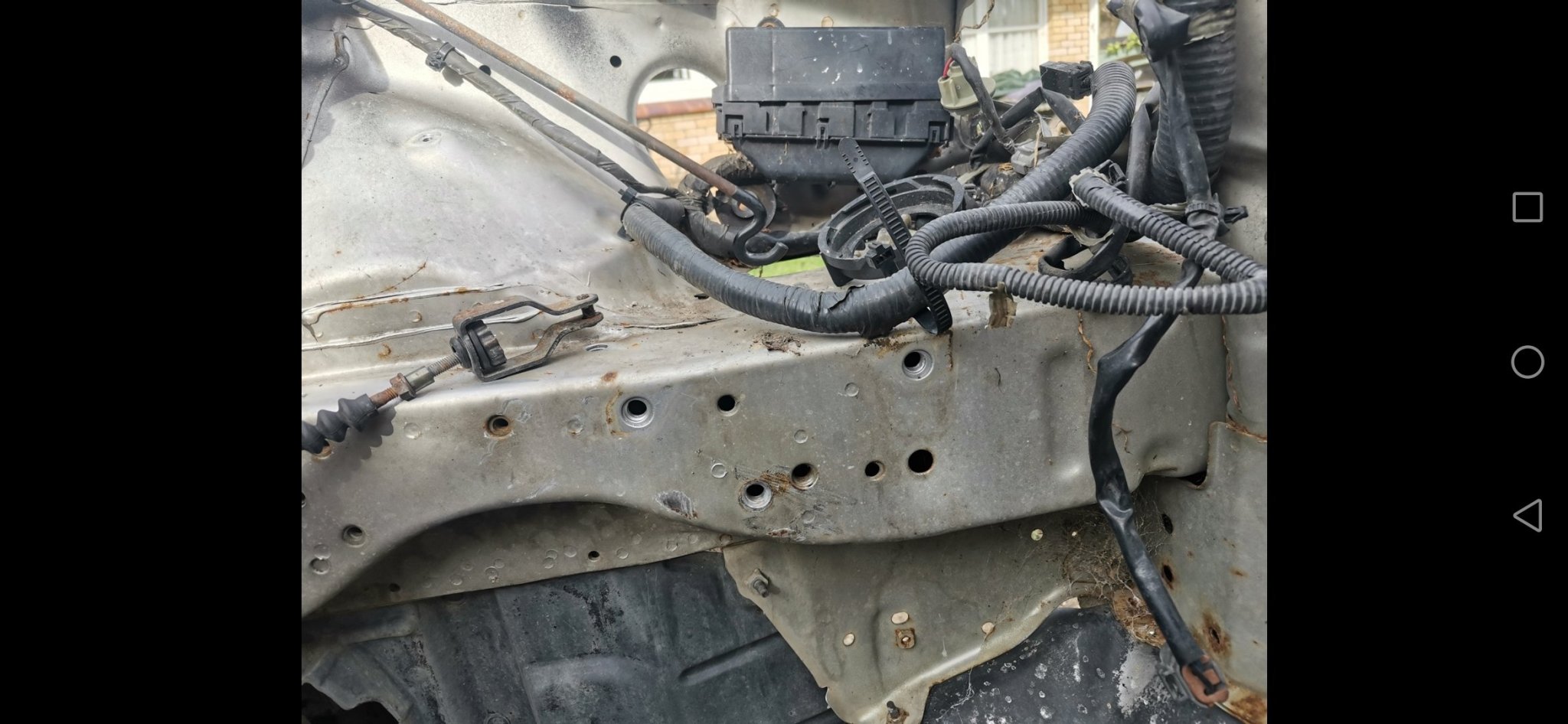

This is the wingroads chassis rail and mount
Screenshot_20221015_165847_com.android.gallery3d.thumb.jpg.9ad9b2e59b1a905b18dd91a5133aae6f.jpgScreenshot_20221015_165854_com.android.gallery3d.thumb.jpg.5f90163ee05d67749646391ed8ab5ec5.jpg

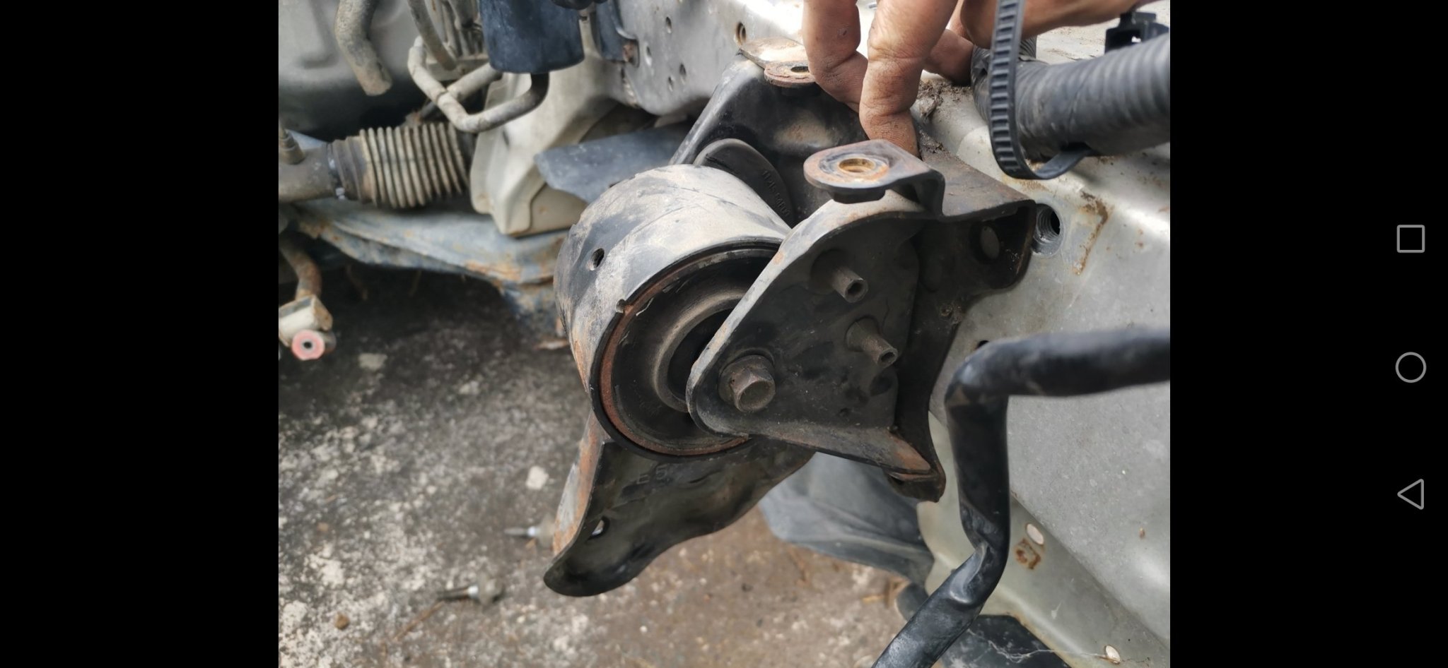

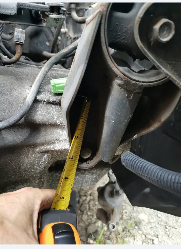

This is the bluebird mount
Screenshot_20221015_170234_com.android.gallery3d.thumb.jpg.5af2b69a96af007739b2411b947b541f.jpg
The holes don't line up, theres 4 over rather than 3
Also spread out more, but I think if I just made a bracket for the mount the 3 would be fine.
The se-r axles will Definately work with a 32 trans, I'm not so sure about the 50 series bluebird one now so I may just need to change boxes. Cvs still stuck in it so some key measurements can't be taken yet
