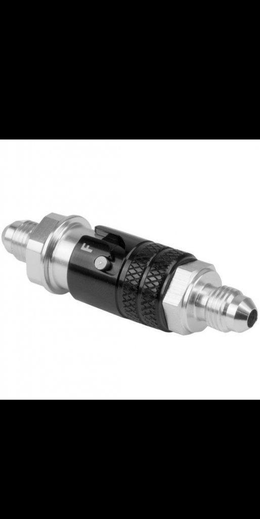

Muncie Posted August 3, 2022 Posted August 3, 2022 Need some dry break connectors and plugs for the loom so he can do rapid roadside engine swaps. Might need a pog style crane bolted to the roof to aid engine ejection....... Quote

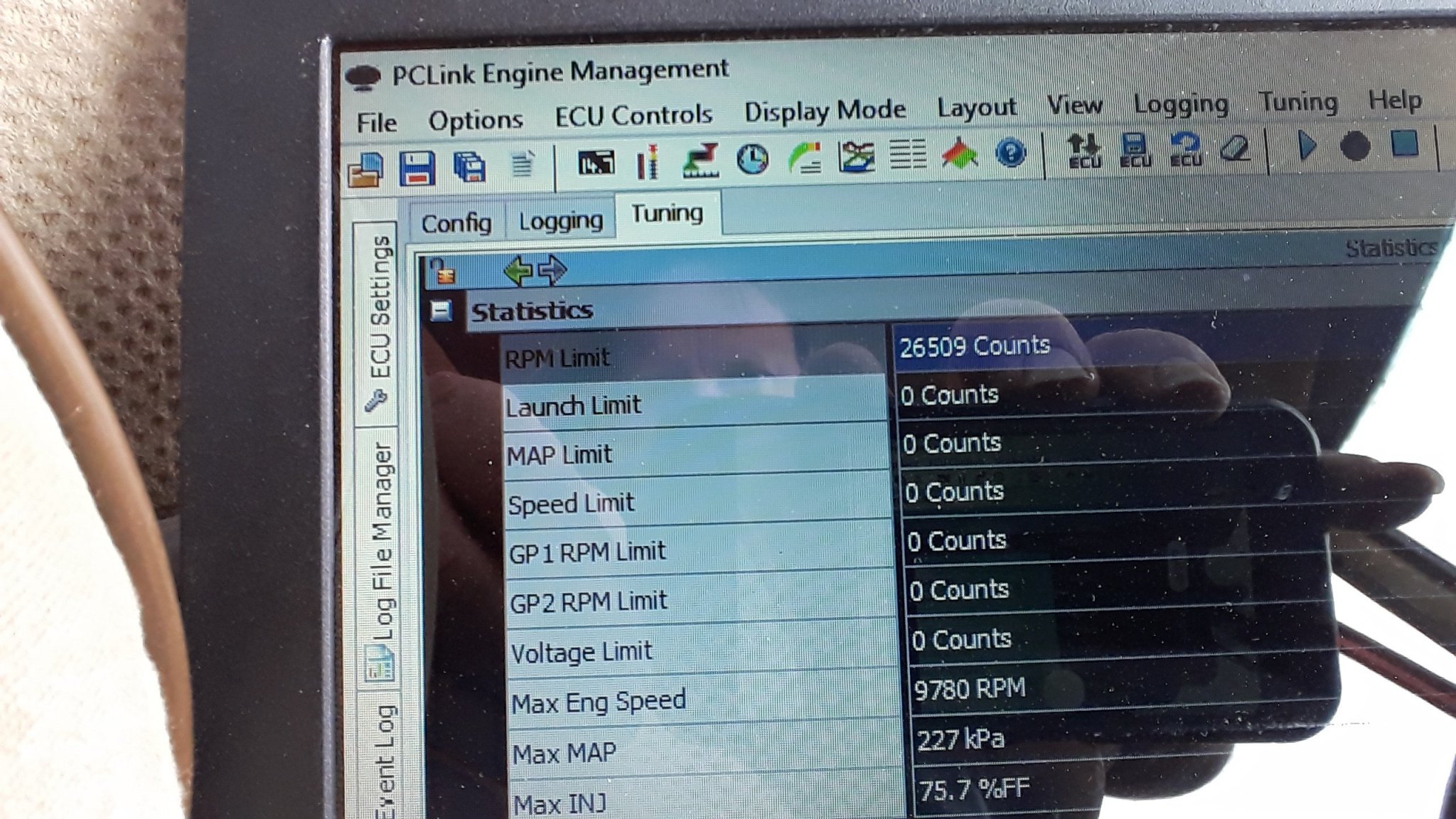

kpr Posted August 4, 2022 Posted August 4, 2022 The ecu stats on link is fun game, this is off my starlet a few years back Quote
ajg193 Posted August 4, 2022 Posted August 4, 2022 4 hours ago, kpr said: The ecu stats on link is fun game, this is off my starlet a few years back That's less than three minutes on the limiter? Quote
kpr Posted August 4, 2022 Posted August 4, 2022 Unsure how often it reports a "rpm limit" I shall do some testing next time its running and report back. in the meantime here is a more recent one /spam Quote
Roman Posted August 4, 2022 Author Posted August 4, 2022 Ahhh right! Well that makes life easy. I've never used that before. Just checking my current stats, I must have unkowingly reset it at some point. The numbers are too low for it to be all time numbers including Carina usage. 122 hours total runtime. I'll reset the stats for the new motor. A lot of these stats (like 150deg temp, or 12400rpm) are from things like a sensor being unplugged or trigger errors when first setting things up. Quote
