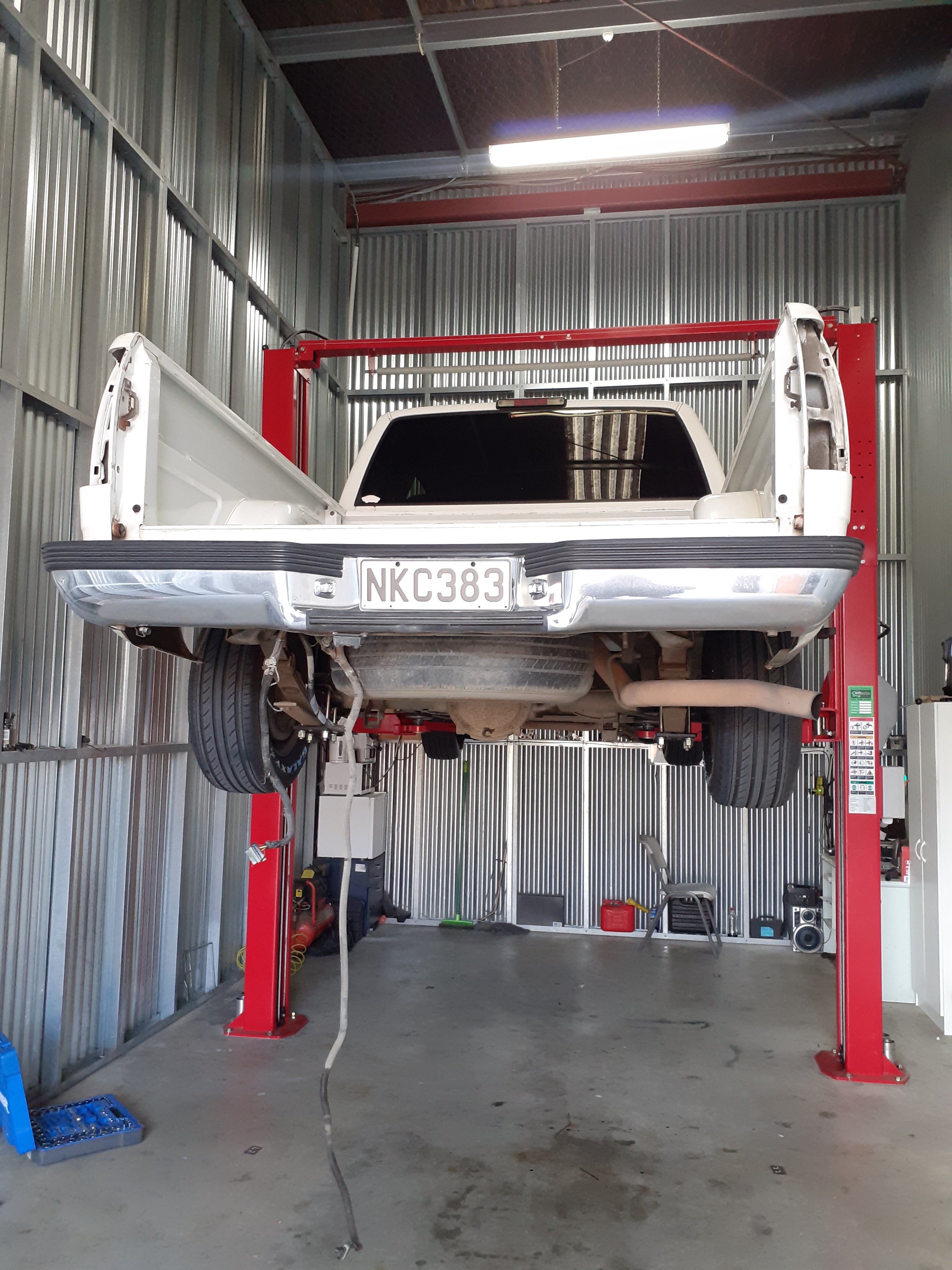

Popular Post cletus Posted May 30, 2021 Author Popular Post Posted May 30, 2021 Suspension partially done, 2" drop spindles, 3" lower springs in the front , and diff put on top of the springs in the back. I drew up a notch and got that laser cut, that's ready to pick up this week so next job is to whip the tray off and glue the notch in and make some shock mounts One of the front shocks fell apart when I took it out , that explains the rattle in the front suspension I'm not sure if the wheels will stay, one has started rusting already and its probably going to rub once the front bumpstops get a trim and the rear has some travel. So I'll probably put the stock wheels back on And waiting for some new front shocks I ordered a couple of weeks ago but I think covid has slowed that down 55 1 Quote

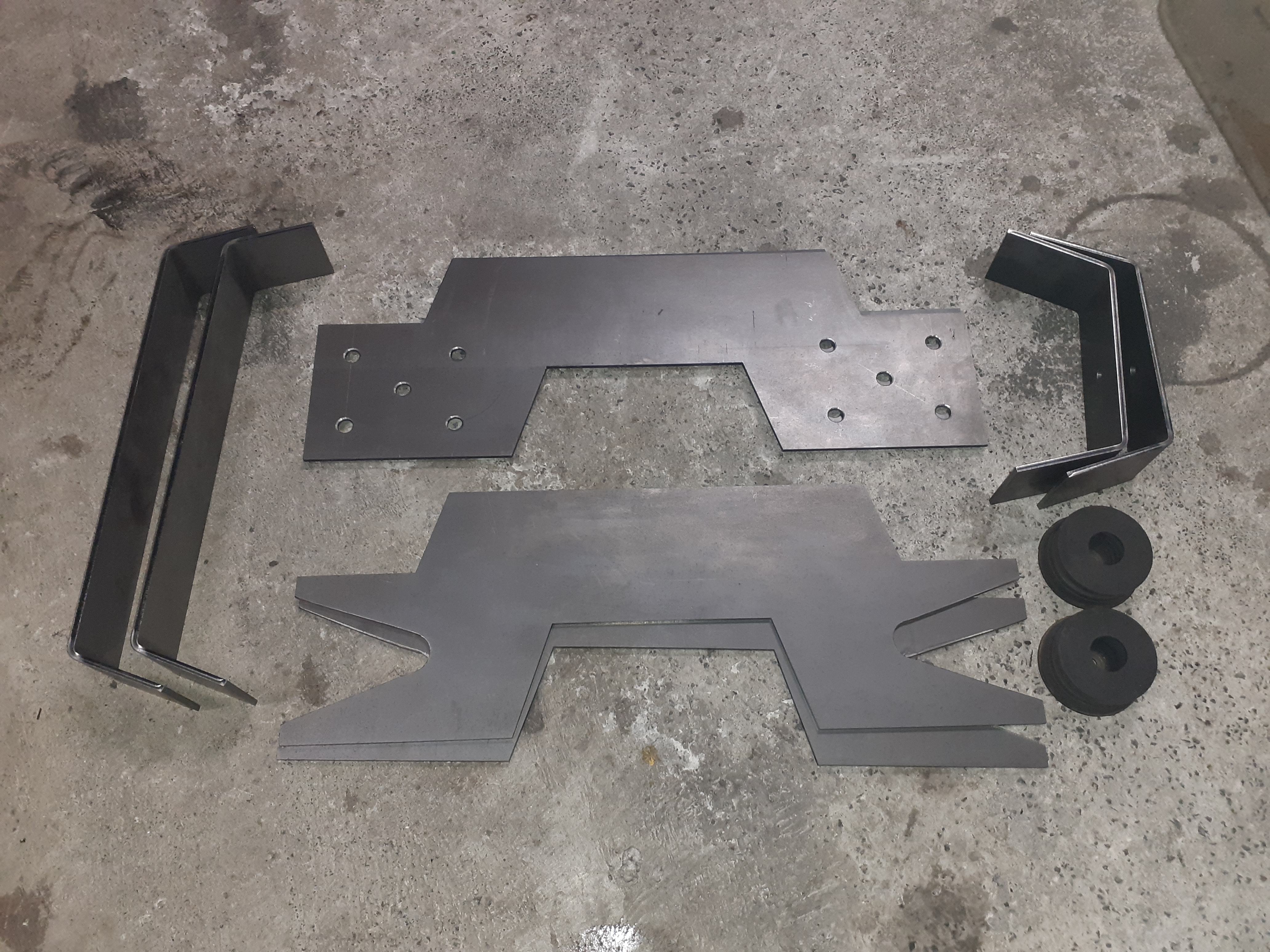

Popular Post cletus Posted June 7, 2021 Author Popular Post Posted June 7, 2021 Notch kit ready to fit I drew it on some cardboard and got it laser cut from 4mm and the top and bottom folded If my measurements are right it should fit under the tray floor with 1x tray crossmember removed , retains 100mm chassis rail height, and 40mm suspension travel before it contacts the bump stops so it meets all the cert minimum requirements The outers are drilled for plug welds and the inners have a big fish mouth to help the transition from floppy channel chassis to box. I did those bits myself cause I figured it was easier than trying to explain to the laser cutting guy what I wanted 28 Quote

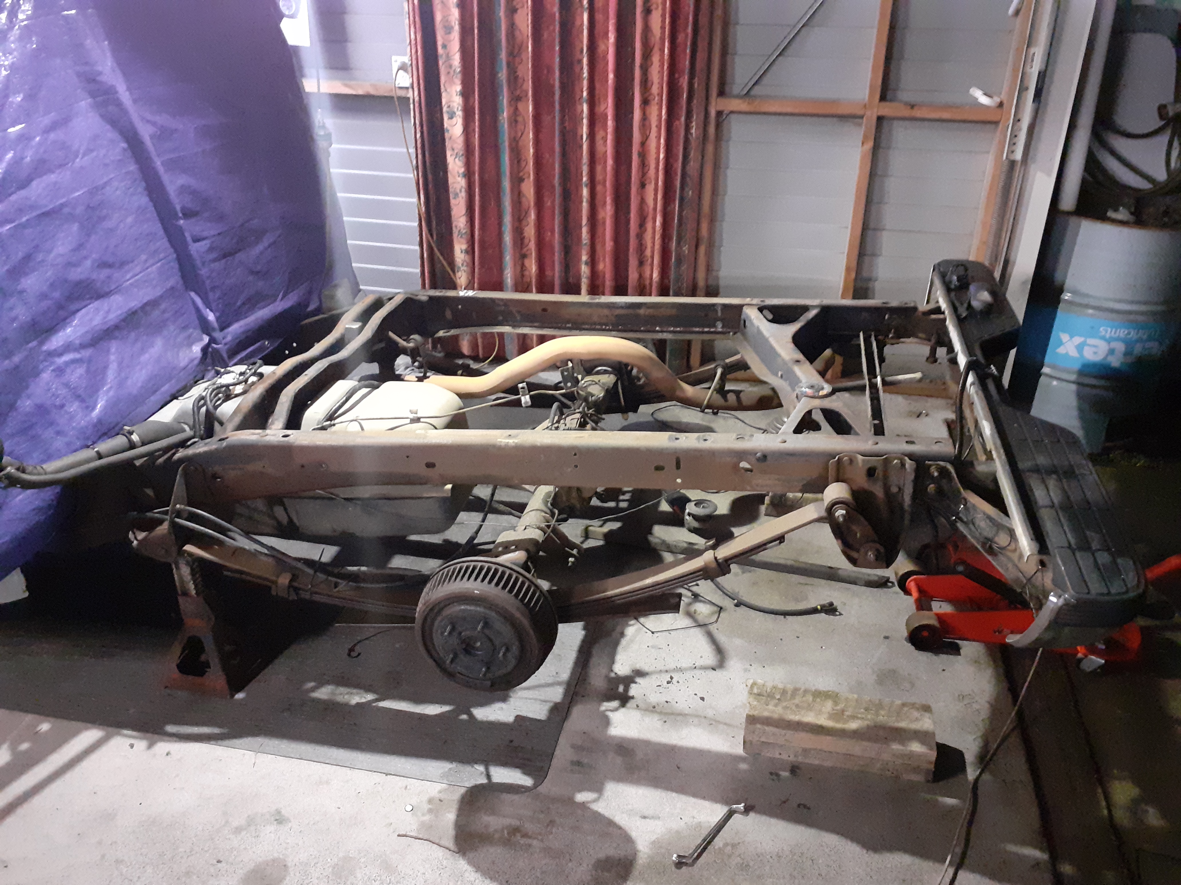

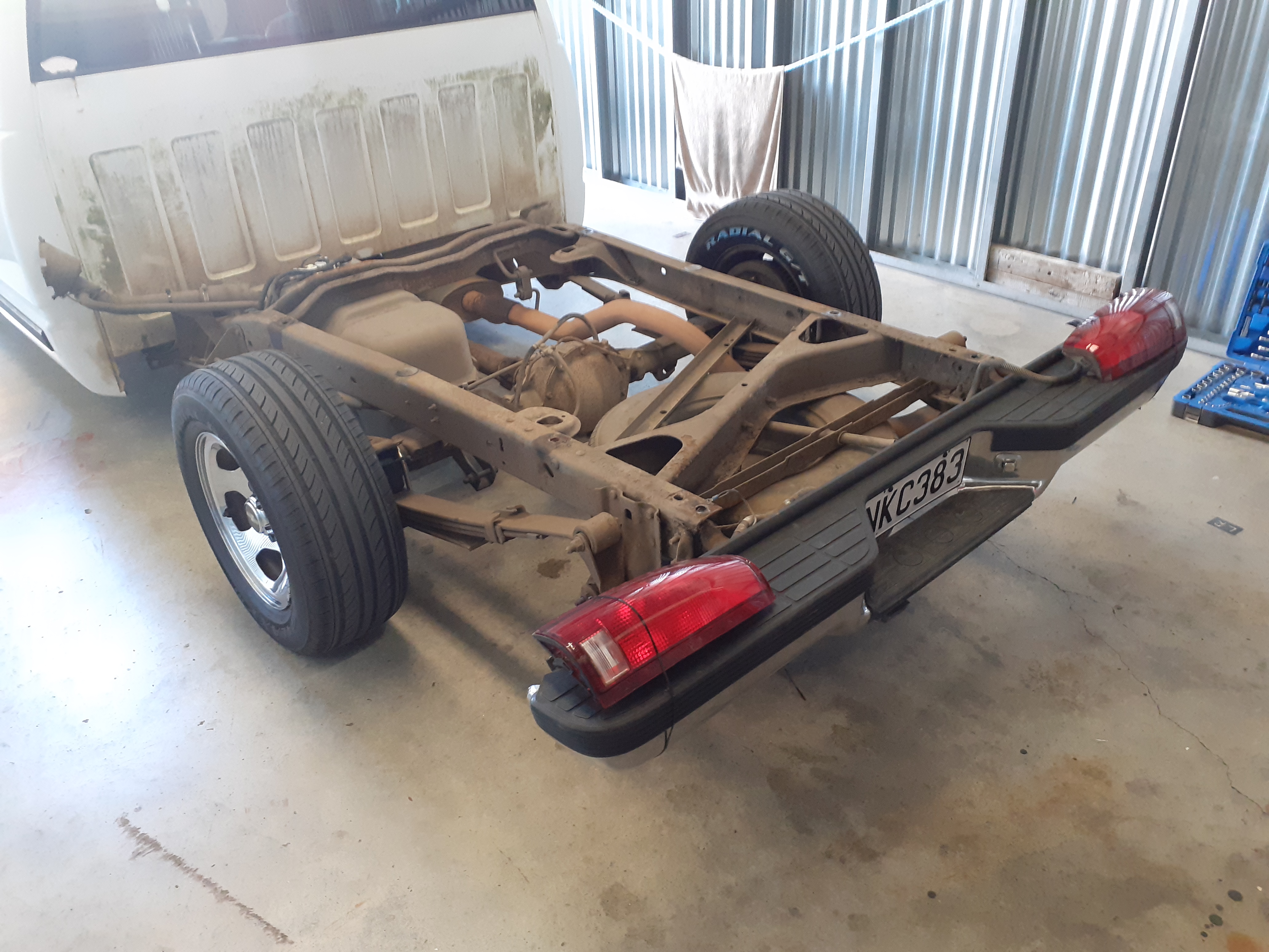

Popular Post cletus Posted June 12, 2021 Author Popular Post Posted June 12, 2021 Got tyres swapped back onto the original wheels, rolled the guard lips , removed the bed, waterblasted a bunch of pukekohe off the chassis , notch tomorrow I was pleasantly surprised at how easy it was, everything came off without a fight 38 Quote

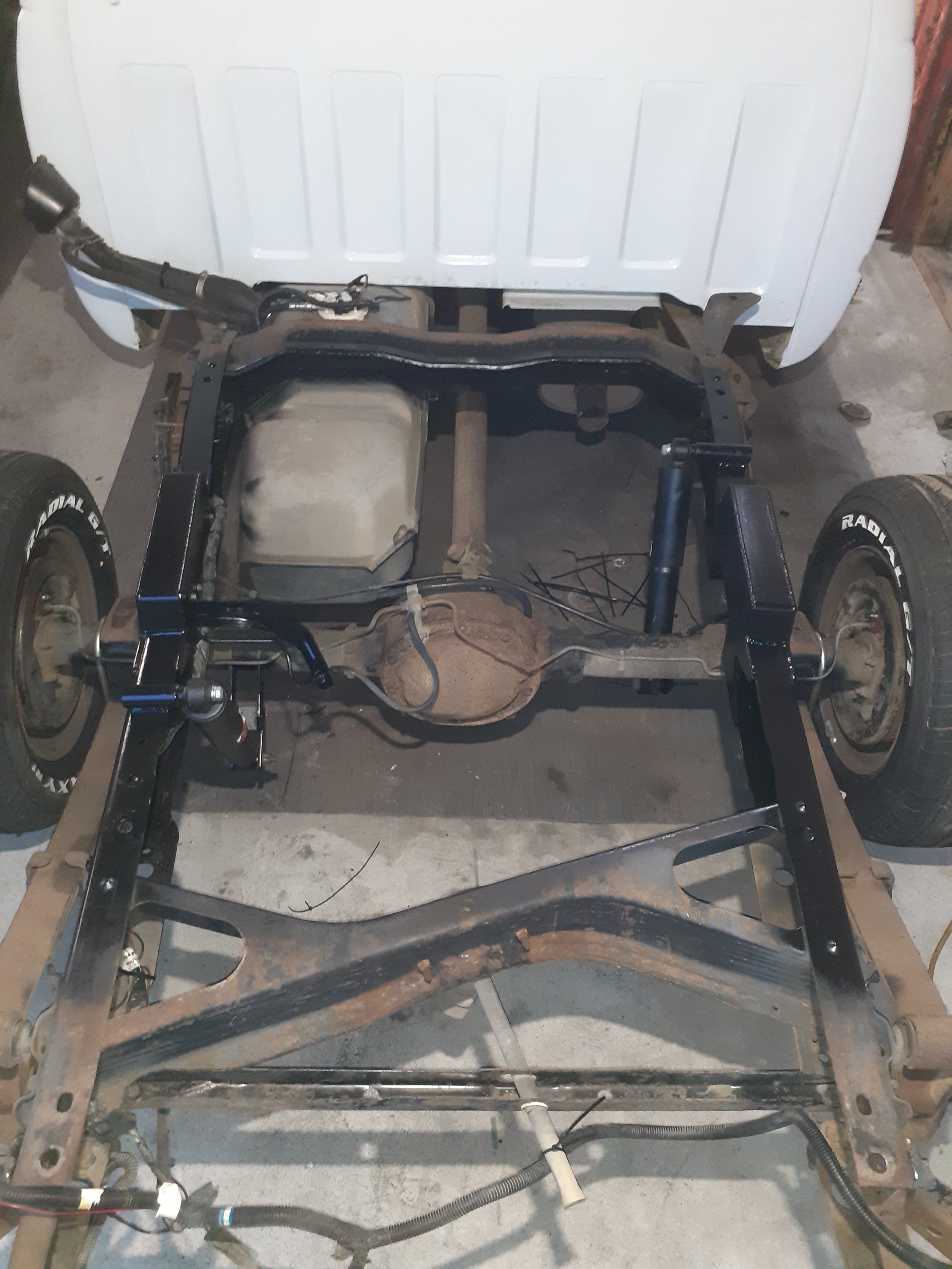

Popular Post cletus Posted August 28, 2021 Author Popular Post Posted August 28, 2021 i forgot the finished notch pics 21 Quote
